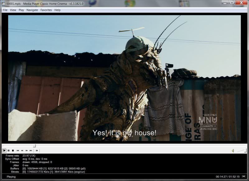

Hello all, so I recently got MPC-HC up and running and with a lot of help from folks in here it's working great. With links provided I was able to configure some shaders too that make BD and DVD look great...so thanks!!
But now I have problem that before I thought I knew how to solve. I was watching District 9 BD and it doesn't play the default subtitles when the prawns speak. So in poking around I enabled english subtitles. But that makes subtitles for everyone in the movie. The movie when played in PDVD defaults to only the prawn subtitle. I thought that being able to use the discs menu would let me do that but it turns out that MPC-HC will not give the discs menu.
So how do I get MPC-HC to only play default subtitles and not every spoken word subtitle? And please note, I have no idea what I'm doing-LOL.

Thanks, I have vobsub "installed"....meaning I put the vsfilter.dll in syswow64 and added it as an external filter in mpc-hc, but can't get it to work.I will read the thread you link but have read others and hve it setup as they suggest with turning off subs in mpc-hc and selecting use forced subs only in vobsub.
When I add the filter it actually adds 2 one is plain vobsub and other one says vobsub (automatically loaded. I've been playing around with checking prefer and other settings, but it just doesn't seem to be setup right. Lemme read your thread but if you could post a screenie or 2 of your setup, maybe I could get it going. I'm kind a visual person so screenies really help.....

Sorry, but I give up. I even tried to uninstall mpc-hc and then install Shark's mpc-hc and and both his codecs and x64 add-ons and it didn't work. In fact something was messed up in his player that wouldn't let me resize the image. So I re-installed the mpc-hc that I had before and now have that capabilty back. When I selected Shark's settings in the setup screen for his codecs, it added ffdshow subtitles to external filters, which didn't work either.
The closest I got to thinking it was going to work was when I set the output to VMR9 and then vobsub showed up in filters when I right clicked with movie playing, otherwise it never even shows up in filters right click menu.
