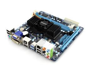

I have pieced together a "bargain" mini-itx (smallest) HTPC tonight. To give you an idea of how small these cases are the dimensions are only 7.87" x 10.43" x 4.72".
Cases with 150 watt PSU (2 options I like) $80-$100
http://www.newegg.com/Product/Produc...-080-_-Product
http://www.newegg.com/Product/Produc...-293-_-Product
Motherboard/CPU Combo $150
GIGABYTE GA-E350N-USB3 AMD E-350. This has enough power to run all HTPC applications as well as any HD format. If you want to game then, again, this is not for you. Low wattage at 18 watts as well.
http://www.newegg.com/Product/Produc...82E16813128468
RAM 4GB - $45
G.Skill 2x2GB
http://www.newegg.com/Product/Produc...82E16820231190
Hard Drive - $40 (up to $130 for a 60-62GB SSD)
Western Digital Scorpio Blue WD1600BEVT 160GB 5400 RPM 8MB Cache. If you put a SSD drive in this HTPC it would be the single biggest upgrade you could make for this machine.
So there you go. $315 before shipping for a HTPC that can do everything you want it to do in most circumstances. Not the most powerful machine and you can't put a big 2TB hard drive in the case but if you are on a budget and storing your media on a network drive then this little guy is a definite option.

So no room for a Cable Card tuner in that little box?
Maybe Sandy Bridge boards will have room to integrate something like that, if the on-die GPU is good enough.
wco81 is online now
post #733 of 15974 Old 02-12-2011, 07:29 AM - Thread Starter
assassin's Avatar
Posts: 13,013
Quoted: 51 Post(s)
Liked: 241
It has 1 PCI slot but I think if you want to start adding cards (including tuner cards) and have the space in your living room or theater room then you really should look at the micro-atx form factor.
The mini-ITX, while really cool to look at, doesn't offer much expandability.

Hello. I am totally new to this so I wanted to confirm a couple of things before I hit the Confirm button over at NewEgg. This is what I'm getting based on the first post of this thread...
SAMSUNG Spinpoint F4 HD204UI 2TB 5400 RPM SATA 3.0Gb/s 3.5" Internal Hard Drive -Bare Drive
Rosewill RNX-N250PC IEEE 802.11b/g, IEEE 802.11n Draft PCI Draft N 2T2R Wireless Adapter
Antec EarthWatts Green EA-380D Green 380W Continuous power ATX12V v2.3 / EPS12V 80
G.SKILL 4GB (2 x 2GB) 240-Pin DDR3 SDRAM DDR3 1333 (PC3 10666) Dual Channel Kit Desktop Memory Model
GIGABYTE GA-H55M-USB3 LGA 1156 Intel H55 HDMI USB 3.0 Micro ATX Intel Motherboard
Intel Core i3-550 Clarkdale 3.2GHz LGA 1156 73W Dual-Core Desktop Processor
LITE-ON Black Blu-ray Disc Combo SATA Model iHES208-08 LightScribe Support
nMEDIAPC Black Aluminum / Acrylic / Steel HTPC 5000B Micro ATX Media Center / HTPC Case
Will I need any extra cables or connections to build this?
Also, I've never built a PC before so how difficult will I find this project? Is it do-able for the basic user?
It's $566.92 ($592.55 after tax), so is there another pre-built option I should consider or is this the best I can get for the money? I wanted to spend about $500 but I can swing the $600.
Thanks for any answers!
EDIT: BTW, all I really need it to do is playback 1080p with no problems. I want to start ripping my BDs to MKV with lossless FLAC audio. As long as it can handle this with no problems, I'm good.
Looks solid to me.
RAM 4GB - $45
G.Skill 2x2GB
