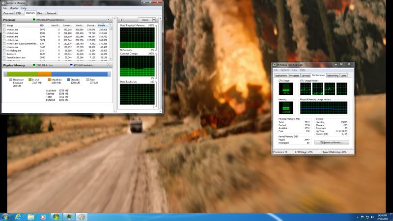

post #10918 of 15974 Old 02-20-2012, 09:54 PM
tlniec's Avatar
Posts: 757
Originally Posted by mattiedread View Post
That would be greatly appreciated. I should man up and go with the i3 over the i5, but, I'm a pussy and would prefer to be safe. I should pull the trigger this weekend (but, again, I'm a.. nevermind).
I think you may have already picked out your parts, but I did finally do some testing with 3 Xbox360 extenders plus the HTPC all running. Here's what I found:
Running live HDTV on HTPC
Running live HDTV on 1 Xbox360
Running recorded HDTV on 2 Xbox360s
~30% CPU utilization (2 logical cores ~50%, 1 ~10%, 1 ~0%)
2.3GB RAM in use, 4.3GB RAM on standby, 1.1 GB RAM modified, .3 GB Hardware Reserved, .24 GB Free (8GB total)
No sweat.
tlniec is offline

mattiedread's Avatar
Join Date: Jan 2012
Location: Eastern LI
Posts: 177
No sweat.
Wow, thank you for testing that.. the i3 is an impressive CPU for any HTPC build. I did already pick out my parts and due to the bundle deal the difference between the i3 and i5 was only about $50 bucks at Micro Center I erred on the side of caution.
But, this gives credence to what Assassin has been saying since... well, page 1. There is no need to go heavier than an i3. I had a feeling MSFT's recommendation was pre Sandy Bridge and could have been outdated.
I and many others appreciate your taking the time to perform that test. I'm off to the city, will check in tomorrow.
