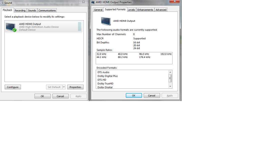

So you ARE seeing HDCP: "Supported" on the HDMI Audio Tab of your PC? Until you do you'll not pass any DD or DTS.
Andrew Hornfeck is offline
post #32 of 60 Old 01-02-2012, 10:55 AM
Qaq
Qaq's Avatar
Posts: 471
DD and DTS do not require HDCP. These are not HD.
Burned by the Audio Inquisition
Qaq is offline
post #33 of 60 Old 01-02-2012, 12:41 PM
Andrew Hornfeck's Avatar
Location: AL
Posts: 2,606
Quoted: 30 Post(s)
I'll give you that DD & DTS are not HD and if he's using a SPDIF connection, then ABSOLUTELY they'll pass. However, HDCP must be verified for HDMI (video) to work and HDMI Audio is a part of that, true?

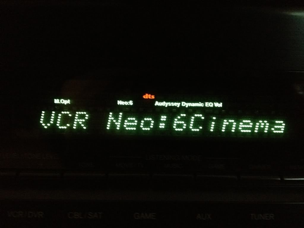

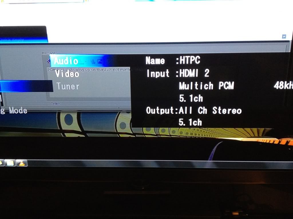

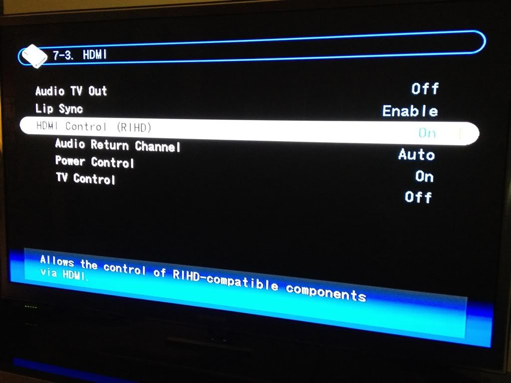

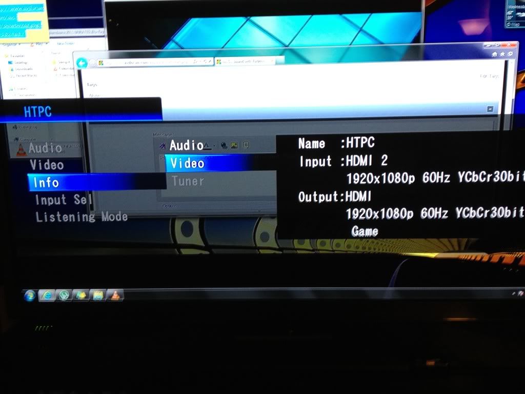

First off the 1st and 3rd pic are the same one, right? They show you are either sending Multi-Channel PCM to the receiver from your PC (because you have the PC's HDMI Audio configured as something other than 2-ch Stereo) or you have selected this as your Listening Mode according to Page 47 of your Owner's Manual. Page 49 shows you should have Audio TV Out set to OFF. Page 52 shows about altering the receiver from the Auto settings - you want to stay with Auto. And your pic shows: "All Ch Stereo" which (according to the chart on page 37) is an Onkyo-Original DSP Listening Mode - you do NOT want to be processing the audio in this way! Whether this is a setting you can change on the fly or need to configure it (so that when you power on the AVR) I can't say although I suspect it's simply a matter of cycling through the MODE button (Page 33) until it says something like Dolby D (see the chart on page 36)... as long as it's NOT anything on that chart on page 37 'cause they are all DSP modes!
The second shows you have GAME mode ON for your display - page 46 describes Game mode which I can't see why you'd want that ON for playing video. Also, you want to display your PC at the 1080p therefore the O should be set to Through according to page 39 so no video processing takes place.
I don't know if this helps although it certainly shows your AVR is misconfigured for listening to DVDs. Let's focus on that... you're using PowerDVD and the HD5450 -- what is your disc? BR or DVD? What audio do you want to hear? 5.1 or 7.1 formats? How many speakers do you have connected to your AVR? 5.1, 7.1, or more than that? Clearly on post #34 you are SUPPORTED in HDCP but how's your CONFIGURE set on that left-hand image? I can't speak for the 7.1 formats but for 5.1 formats it must be "2-ch stereo" and NOT 5.1 or 7.1 speakers because that says speakers and will decode the stream in the PC and send PCM! (I'd already mentioned this point earlier in this thread.)

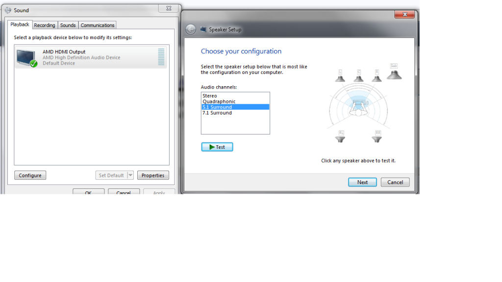

Have you read your Onkyo manual closely? Pages 72, 73 & 74 describe HDMI, audio formats and Onkyo's exclusive RIHD for controlling Onkyo and RIHD-Compatible components... do you have RIHD components? You're setting it to On. Is your TV a "smart" TV and uses ARC? Please, if you don't have these then revert to basics.
You say: "...then configure it for 5.1 which is what I have (paradigm setup),..." STOP, please... WHY configure your computer to 5.1? Your SPEAKERS are connected to your Onkyo and NOT to your COMPUTER as the image you posted states! Please pic the Stereo option, not the Quadraphonic, not the 5.1 Surround, not the 7.1 surround and play a physical DVD (e.g. not BR) in PowerDVD that has a DD and/or DTS audio track. That should be a start!
You do know that it's the source material that has manufacturer-specified audio tracks, right? Not all DVDs have DTS, in fact very few have a DTS audio track while the majority have DD. Some even have both while some have several including Director's commentary, foreign language DD tracks, etc.
As far as DTS HD, now you're talking HD audio which is exclusive to BR and again, not all BR discs have all the formats included in the press. You have to pick a track on the disc... so when you say you can't get DTS-HD does that disc have a DTS-Master Audio soundtrack on it? If so then it's either going to clear up once you get bitstreaming configured right, or one of those using PDVD3 can attest to configuring it to pass this... BTW, PDVD3 is like 15-years old... I think you meant PDVD11 as stated way above
And that last pic shows you have NEO:6 Cinema and the Music Optimizer set to On, why? I'm not even sure it would work if you're passing the correct signal... please read page 51 which talks about using it with "lossy" compression, such as MP3 as well as:
The Music Optimizer function only works with PCM digital audio input signals with a sampling rate below 48 kHz and analog audio input signals.
as well as Page 36 which shows it as a matrix from a Stereo source -- perhaps the VCR you have selected in that pic? I'm trying to figure why DTS would be illuminated in that pic!?!
