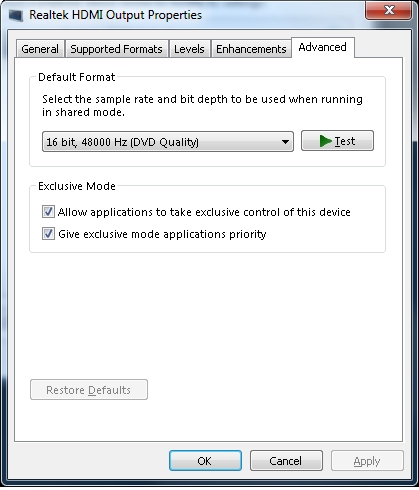

all speakers dont work. only the 2 front channels during the "test" from the audio device properties ..
generally the left speaker doesnt fire the first time, because when it sounds off you can see the receiver's PCM light, light up. so it only plays the right channel, then if i do it again really quick i get both (i assume because it triggered the receiver to PCM mode which allows it to get both channels from the start)
the strange part is that the test option under the speaker setup in WMC it sounds like it gets most of the speakers (however i think its just the fake surround from 2 channel) .. the sub doesnt sound off from what i can tell though.
advanced tab pic:

You will NOT get 5.1 channels to "test" on the AVR and this is the correct setup (odd as it may seem). Put a DVD into the PC, let Windows Media Center play it... go into the audio setup of the DVD and assure it has a 5.1 sound track then jump into the main movie and what does your AVR indicate?

the only thing i did was select "stereo" from the windows speaker configuration under the properties pane for my audio device.
Nothing else.
if you are stuck i would advise to uninstall all drivers for your video card and or onboard sound, remove the devices from device manager, reboot and reinstall only what you know you need (ie drivers).
Then ensure you select stereo under windows options. Then test with something you know is 5.1 (you can find many test videos online).
i have my onboard Realtek device disabled. FYI.
