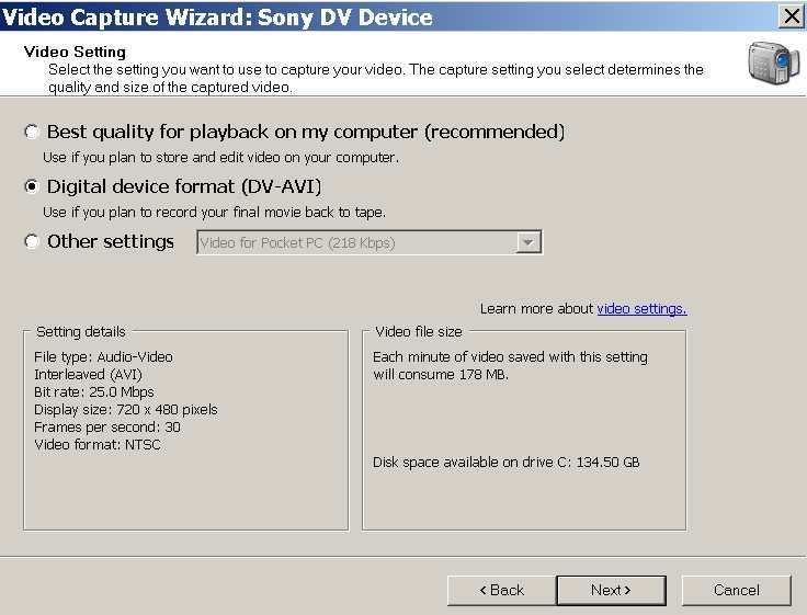

I used "Moivemaker" (MM) to "capture" the avi from the Sony model DCR TRV20, DV-tape-type camcorder via firewire. After opening MM and selecting the capture option, I get the following (get a load of that bit rate):
As the above shows, I select the "DVI-AVI" option which, as you can see, takes up a whole lotta hard drive space.

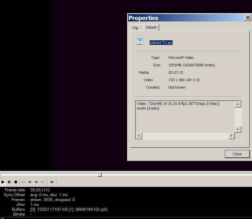

After capturing, I select the "finish" option and, voila, there's a huge video file available for whatever. I use MPC HC to play back the file. Here's what MPC says about the file's properties:
So that's as much information I have about the file, other than that the video quality of this gigantic file is excellent.
