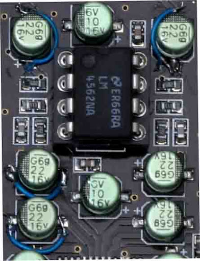

Here is a picture and Mark's explaination of this mod. He first did it without removing the caps and then later removed them. If you don't want to remove the caps, just do it this way.
Mark: "L/R ch. of X-Meridian sound card showing initial mods. Left shows direct coupling from DAC to output, while right still has DAC to op amp caps. Right ch has 0.0001 V DC offset, left 0.0104 V (differential error from DAC). Left channel configuration safe enough for me and sounds better. If you go with the right ch. config, at least the electrolytics are DC biased for less-bad sound."

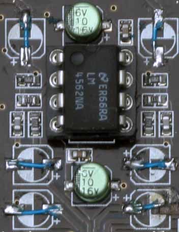

Here is what Mark's final mod looked like, although he suggest that you should just leave the caps on because he damaged his board and had to fix a trace.
Mark: "Right channel read 0.024 V. DC offset, 2.4x left channel! Note damaged trace in lower right. Suggest leaving caps in place and jumper around them."
There is some risk of this mod if one of the op amps fail or you one of your connections is bad. So you should use some discretion whether it is worth it. The caps are there for a reason, mainly to protect your equipment but at the expense of of some sound quality.

I must caution again that you CAN fry your card and anyone who does this does it at their own risk. With that said. I was a soldering novice and probably should not have attempted this, but I did, and it worked. Luck was with me I guess.
Strangely enough , my DC output measurements were nearly identical to what Mark measured. .013 for L and .023 for the R. The other channels were a bit less.. most around .013. One at .007.
My soldering job was not as neat as Mark's as well. The wires I used went partially over the caps and not around then as his did. I'm sure that less wire is better, but it was a bit too challenging for me.
