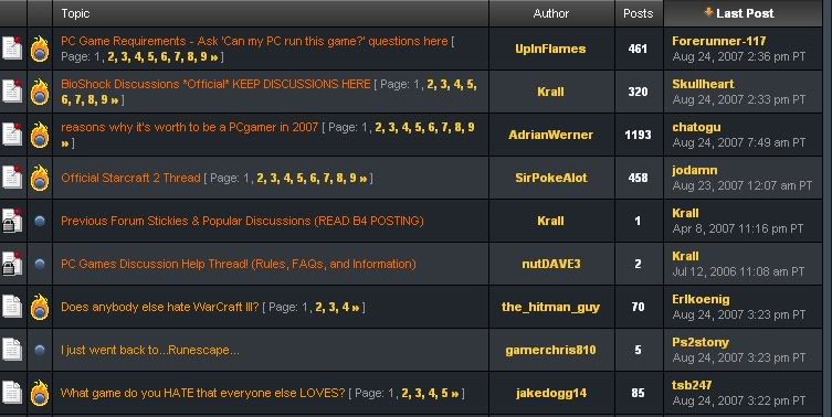

tried doing that, no help, this is the kind of color distortion I'm seeing
EDIT: It doesn't show it in the screenshot! but basically oranges and yellows will have a mix of other colors into them
