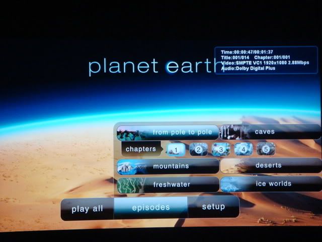

I strip the XPL to main movie playback. Menu's and chapters all gone. This also has the advantage of saving disc space as the menu EVO's are no longer needed.
For HD-DVD's like Planet Earth with multiple episodes on each disc I created individual XPL's for every episode. The individual episodes could then each be played like a movie with TMT or PDVD.
drsmithdtv is offline

That's interesting, but you end up with 11 discs, and you can't easily go from one episode to another. With my method you have one huge title (>9 hrs) and 55 chapters, instantaneous chapter changes and menus and all. This is what it looks like (edited in the meantime to show all 11 episodes, but I can't mess with pictures now):
