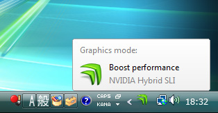

Old 05-23-2008, 11:23 PM
Bahn Yuki's Avatar
Join Date: Oct 2002
Location: Salem, Oregon
Posts: 372
Quoted: 152 Post(s)
Liked: 86
Send a message via AIM to Bahn Yuki Send a message via MSN to Bahn Yuki Send a message via Yahoo to Bahn Yuki
well I have Hybrid power working which completely KILLS the 9800GTX. I'm serious, there's a green LED that comes on this card when it's active. Nothing when inactive...
UPDATE: not only is the card dead, the FAN is too! I renabled just to make sure I didn't fry things out, but it's still working! Hybrid power really works quite well!
BTW this ECS board gets MASSIVE stuttering with sound just playing a simple MP3 in Winamp. Something is going on here, as I'm getting hiccups left and right in simple web browsing. Sadly this isn't just isolated to HDMI as it occurs during my headphones too.
I'm going to install process explorer and get to the bottom of these "hiccups"

Originally Posted by nismozcar View Post
Hybrid SLi works using the 175.16 drivers with my Gigabyte 8500GT.
nismozcar,
Do you see the Hybrid SLI icon in the task tray like below?
