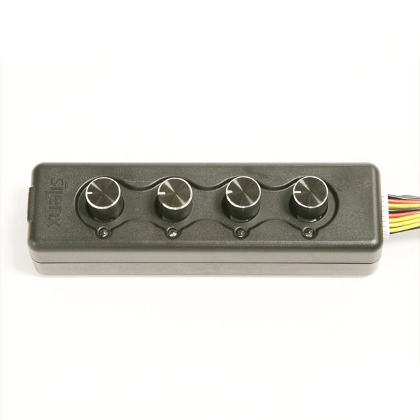

Here is a picture of my solution for keeping my A/V cabinet cool...
4 SilenX 90mm computer case fans with speed controller (hidden behind cabinet). They are triggered on/off automatically by the AVR. These fans are just a whisper at 1' and completely inaudible from 2'.
The camera flash greatly exaggerates how visible the back of the cabinet is...

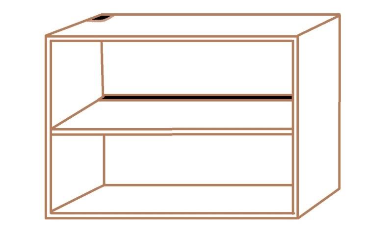

This thread seems very informative. I thought I'd post my question here rather than start a new thread that way if someone else has a similar question, they'll find it easily like I found this thread.
First, my horrible MS paint illustration of where my AV Receiver will go:
My receiver will be in the bottom compartment. There is about 1" clearance between the back of the shelf and the top compartment. The front is encolsed by a solid wood door. (I will be using an IR repeater.) There is only a small hold near the top left corner where the cords go through. There will be an inch or two of space between the top of the receiver and the bottom of the shelf.
This thing really gets hot in there. I want to install a cooling system but I don't know if I should install fans blowing in and out, how many of each, and in which compartment. I'll probably go with something that coolerguys sells to keep my life simple, but I'm a little overwhelmed by all the choices.
I would recommend 4 120mm fans two for each shelf. have them blow out the back.
The reason I say 4 is because you mentioned that the door will be shut and that you will use a repeater. If thats the case then you need to move alot of air since there will be no flow through of air other then what the fans do.
Some will say that 120 are over kill but there is a reason i use them over smaller fans. The 120 will spin slower but move more air then a faster smaller fan. The slower the fan speed the quieter it will be.
I know I said we would have the IR repeater, but we'd still try to use the equipment with the door open. Invariably what happens is that the door gets closed and sometimes we leave the equipment on for days without knowing (not producing sound output of course). Still, having no intake fans would concern me a little.
you have to be careful with having intake fans with exhaust fans. You want to make sure that you dont have more air coming in then going out. That creates heat pockets where air hot air cant get out. The idea is to create a slight vacuum by having more exhaust. So you dont have to have a intake fan for the cooling to be functional.

Here's what I used...
http://www.amazon.com/Silenx-IXAFCEX.../dp/B0030EZLSO
http://www.silenx.com/quiet.fans.asp?sku=ixp-76-14
No miscellaneous parts needed - it's plug and play.
I use a "smart strip" with my AVR to automatically turn the fans on whenever my AVR powers on. The fan controller lets you adjust each fans speed individually so you can slow them down if they are too loud (these Silenx fans are very quiet though - even at full speed I cannot hear the fans (I run 4) unless I stand right in front of my cabinet). The blue LEDs next to each pot are bright - I face them down on the carpet/floor so they don't glow behind my cabinet. A piece of tape would solve this too I suppose...
palmfish is offline
