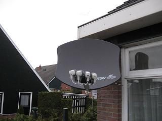

I live in Europe. When a desired channel is on a odd satellite, outside the main satellites best thing is to have a Motor-driven dish (with one lnb). There is a 4k channel on Hotbird (10.930H, 27500, 3/4 DVB-S2 H.265) which one can receive with a few UHD TVs.
I did not have to upgrade my satellite dish or lnb's over five years. Two biggest satellite clusters in Europe are Astra 1 19.02 east and Hotbird 13.0 east. Lots of changes, never had to change anything. I also receive UK channels on Astra 2 28.2 east and subscription channels on Astra 3 23.5 east.
my dish
my dish
DirecTV doesn't support such a setup here. They prefer non-motor dishes for both reliability and ease of installation. The dishes are also relatively cheap to produce in their current form, so users are actually encouraged to leave the dish behind when they move and request a new one be installed wherever they move to.
