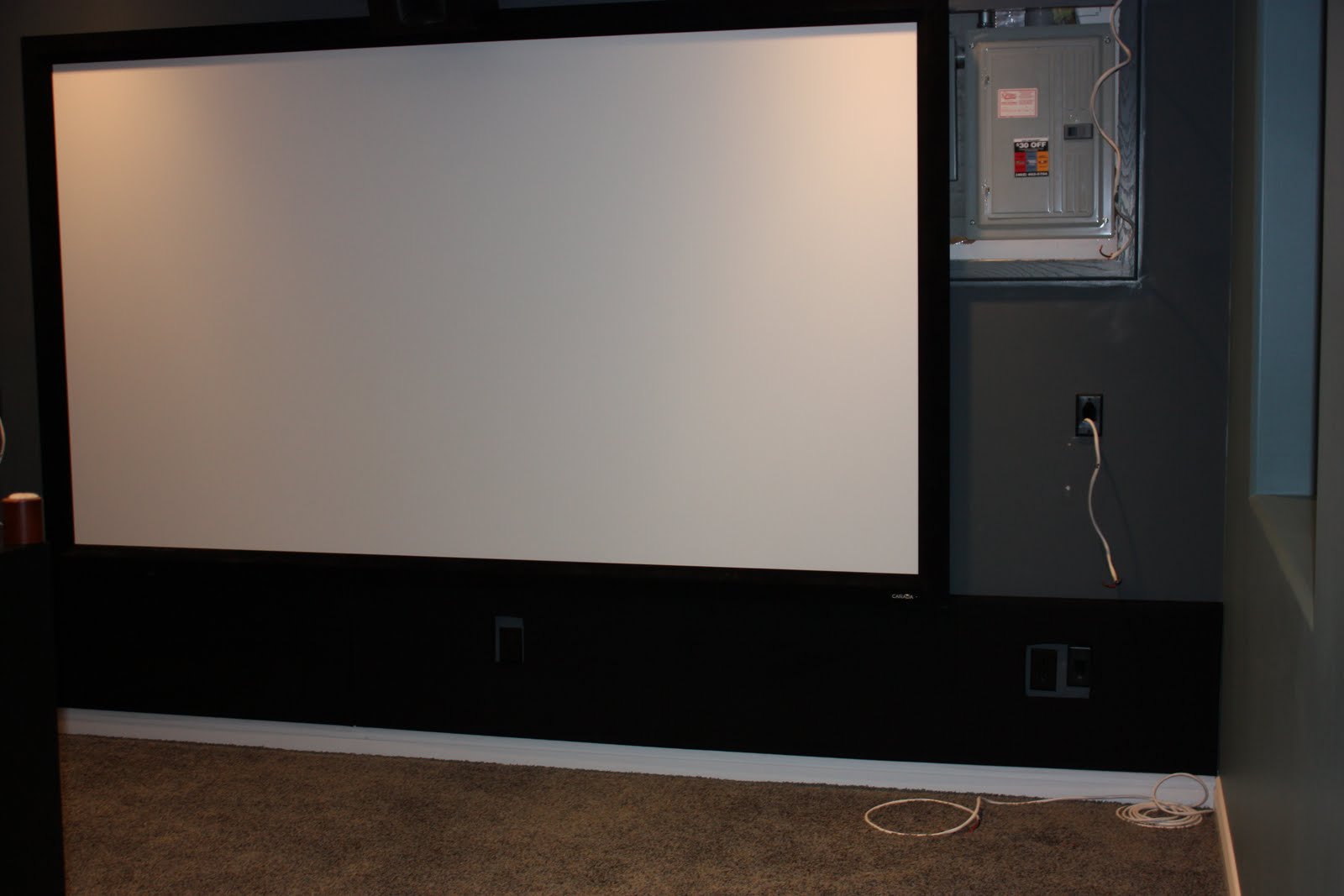

I keep trying to upload the pics but maybe it doesn't like my computer or something.
I liked Brad (pimp my garage) style of getting his fabric to easily roll off, so I had a couple pallets and a broomstick laying around..
Best nail/stapler/compressor combo ever for $99.
Used premium white 1x2" board instead of ripping OSB....they already come sanded and are straighter than me trying to cut some....
My first attempt--a small skylight window in the rear of the room...
To go around the plug-ins, I just stapled some small fabric pieces around each edge, then stretched the fabric across the whole front and made small cuts to expose the prewrapped holes. Worked out well...
I probably ended up making the holes a little large for the outlets/pre-run wire locations. I'll probably take some fabric to the wall behind the outlets in these spots.

looks good Greg. I'm glad the insulation is coming to use
There are some box extenders that you could use if you want to to get the box flush with the fabric http://www.amazon.com/Carlon-PVC-Ele.../dp/B000H5ZVY8
/Anders

Thanks for the tip. I'm going to cut pieces of fabric and 3M77 them to the wall surrounding the boxes-then put the panels back in place to see how it looks.
I think I'll have some OC703 left over too... since I'm not doing bass traps at the moment.

The screen looks great!

Looks like a million bucks compared to the old version.
Only took 2 days of neglecting my family and 2 fingers sacrificed to the nail gun.

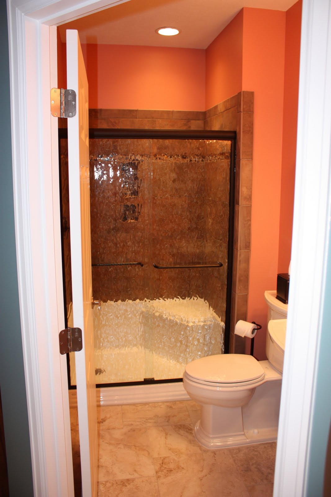

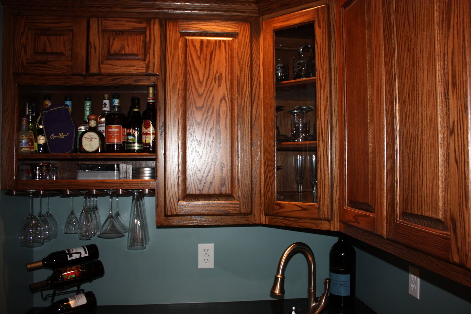

Finished the bar area with the glass insert this weekend, and got the shower door in finally so the rear of the room is complete.

how far up did you tile the shower?
DemonGT is offline
84 inches. Kind of just arbitrarily picked the height.
HuskerOmaha is offline
post #473 of 630 Old 07-08-2011, 07:28 AM
jim tressler's Avatar
Join Date: Apr 2004
Posts: 2,149
Quoted: 27 Post(s)
when tiling a shower I always go at least 1 tile or 4" above the shower head
jim tressler is offline
post #474 of 630 Old 07-08-2011, 08:38 AM - Thread Starter
HuskerOmaha's Avatar
Join Date: Sep 2010
Location: Omaha
Posts: 2,261
Mentioned: 25 Post(s)
Quoted: 66 Post(s)
Liked: 56
Yeah, I hate when you have water splashing onto the paint. Ours looked weird going one tile higher since these were the big guys. Works where it was at.
But totally agree, if you are not using 12" or similar sized tiles, higher the better.

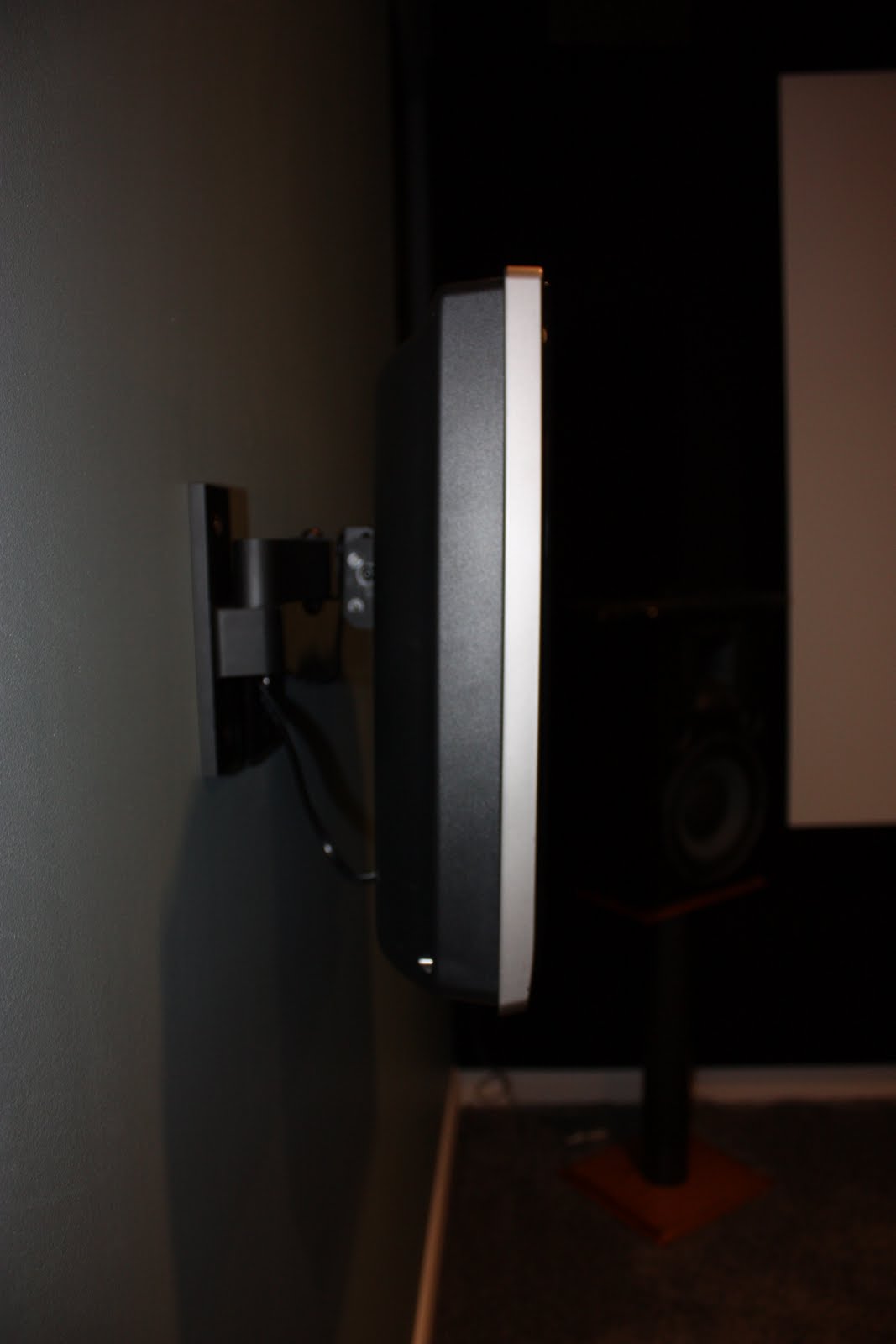

Got a side wall TV mounted....use for doing workouts (Might start the Insanity one), secondary football games this fall, and to manage my HTPC so I can quit turning on the projector all of the time.
Will probably get a 36-40" slim profile one this fall after I find my BenQ6000....any TV suggestions?
