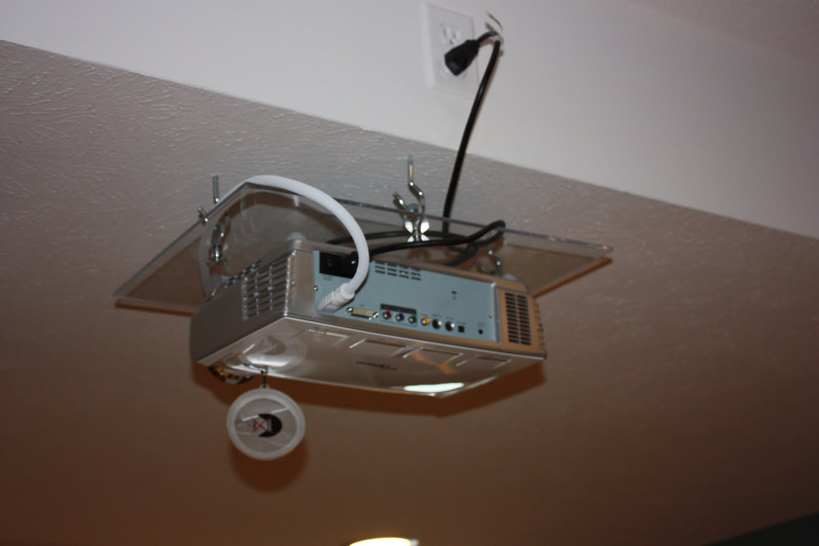

Okay...I figured I might as well get the projector mounted one of these days...
I have no seats installed to watch anything so the temptation isn't as great...
These things are huge.
Yes, the feet look funny. But otherwise everything looks awesome!

Mounted.
Not the way I imagined it...but it works for now and fills the frame almost spot on. I'll tweak later once the carpet gets in....
The four adjustment points need springs added for ease of use....and maybe should have used 6 of those..but it works..

Used a Sanus mount from NFM here in Omaha. $68 was way too much for that puppy. The monoprice mounts are stressed with my lightweight heights, I bet they would have bent with the SHO-10s.
I'll probably buy a couple more of those LCD mounts...they are smooth and really adjustable...

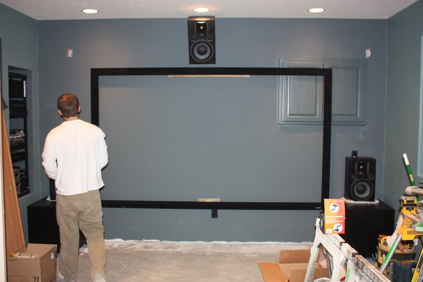

I have to work at 6am otherwise I'd be down there calibrating....
I tried Audyssey but it wants to think I don't have subs apparently...
Brother came over from Lincoln to help me hang the speakers....
So, I kind of just want to shut a door on this....but will be fun to organize down the road...

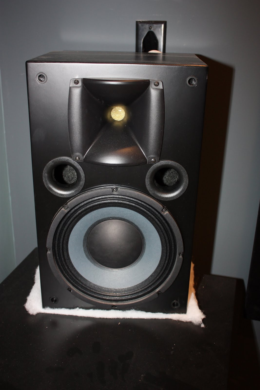

Mounted.
Wow! Getting really close to show time
As far as the projector mounting goes I might suggest getting a white power cord with a 90 degree bend at the plug and it should pretty much disappear..
How did you mount that LCD bracket to your SHO10 center? Did you have to drill holes in your new speakers
That's a great idea actually. I'll keep it in mind..right now I'm trying to just get stuff installed and tweak and make things "show quality" over the next few weeks...after we get carpet in and I can install chairs, subs for final spots, EQ, etc..I'll be ready to do stuff like that. Good idea though.

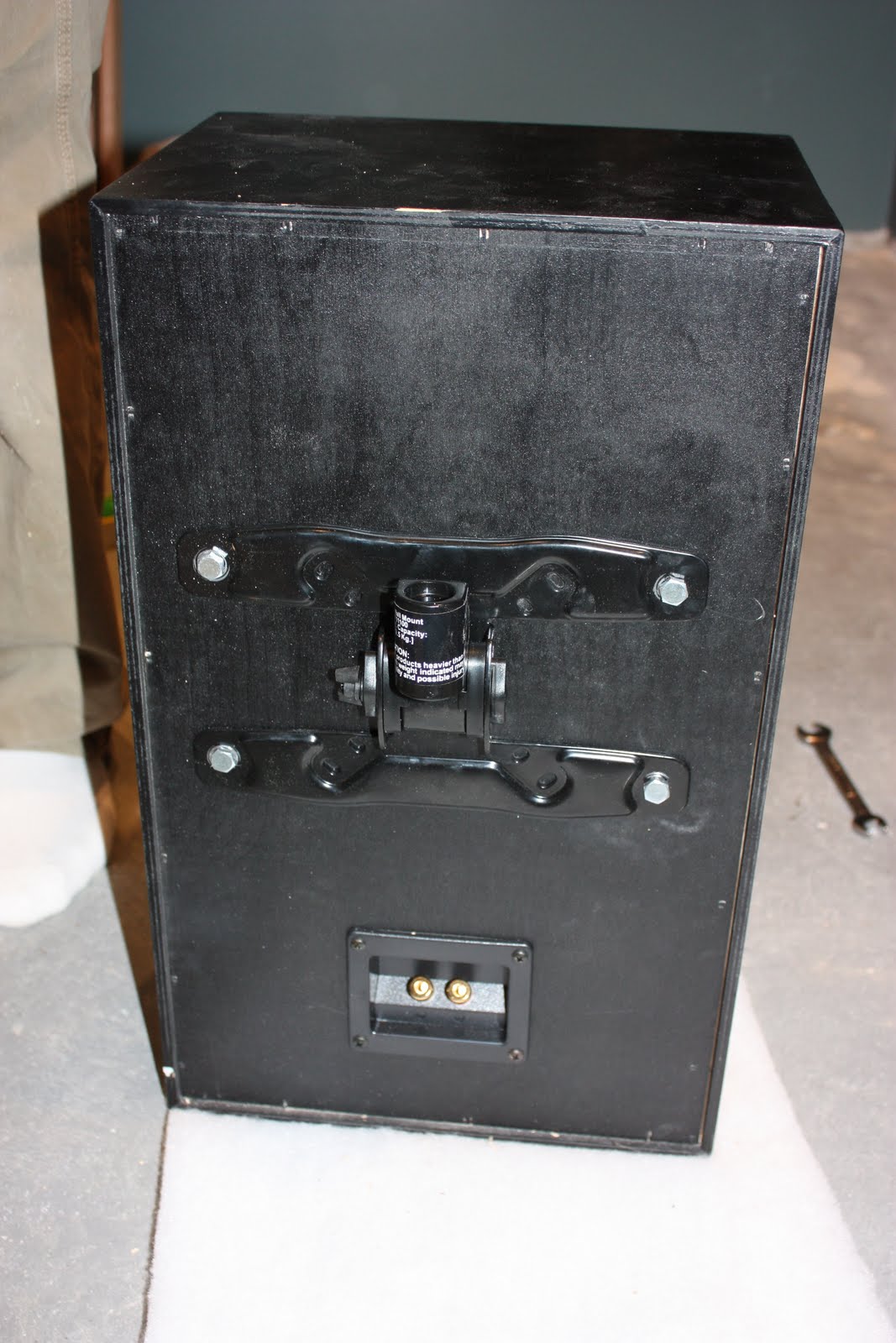

Oh boy, did I drill that sucker! 4 lag screws (1-1.5", I forget) into that puppy. It ain't going nowhere! The crossover is at the bottom of the speaker (or as far as I remember Craig saying...) so we are good. Hey, I got sound coming out!

Your screen wall doesn't have a lot of room for traps, but you could make some tri-corner traps in the top corners - wall-wall-ceiling intersection. You could also do something at the screen wall floor intersection, but not sure that that wouldn't look odd. What about the rear of the room, did you post pics of that I don't recall.
Do you have a riser? If so, that could be a trap.
I like the idea of flipping the center - maybe also elevate the L & R - not sure if you were planning on keeping them on top of the subs, or mount high like the center, or if the outlets up high are for that.
I've seen granite tiles used, and they look nice, and much cheaper than a slab.
For Audyssey, try doing full auto first, double check that you're set to small LCR and 80 Hz.
BTW, what does the cabinet behind the right side of the screen lead to?
The rear has the wetbar/cabinet area and the bathroom...really nowhere for a trap other than the wall to utility room corner...potential there...but that might not help much?
Nope, just that awesome bar without a counter!
The L/R will be off the subs and a foot or two higher...where those outlet boxes are above the subs..I think you can see over the SHOs actually...
They look nice, I'd probably need 22-24" depth for the bar (which since I was planning a slab I have no support for across the side where you are watching from)....and then I'd need a different solution for the kitchenette area...
Roger that...
I'm glad you spotted that piece of ugliness...that is the electrical cabinet...I might move the screen up a bit to cover the top...but when the lights off you obviously don't notice it...one of those things I wish I could have done an AT screen but wife didn't want that and the room isn't too large as it is.....(why I kind of want to make a ton of 2x4 acoustic panels and put them all around the screen...including over that and around all the speakers...)

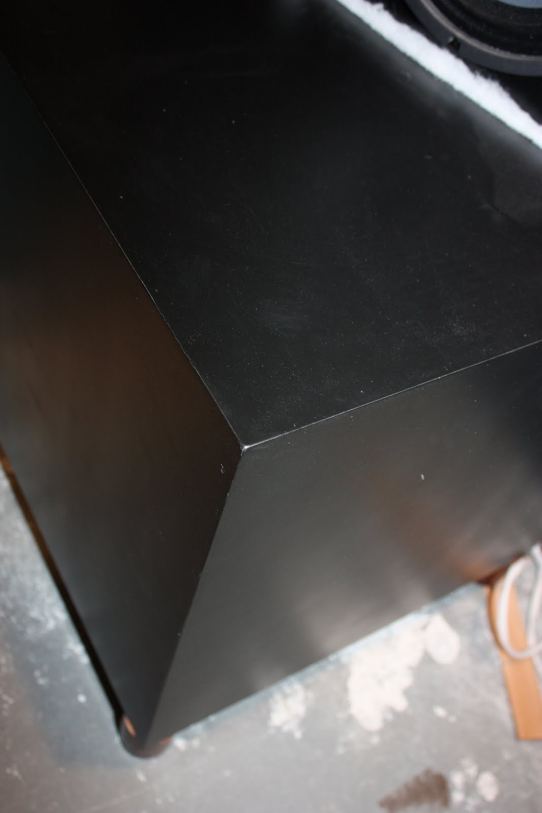

post #262 of 630 Old 01-24-2011, 01:07 PM - Thread Starter
HuskerOmaha's Avatar
Join Date: Sep 2010
Location: Omaha
Posts: 2,277
Mentioned: 20 Post(s)
Quoted: 54 Post(s)
Liked: 50
Originally Posted by desertdome View Post
You're making some good progress. I personally don't think changing the center speaker will make any noticeable difference from the listening position. I would spend time on completing things and leave that for a later time. I have the same Dayton amp and it never even gets warm. I wouldn't worry about its location in the rack.
I can stop by after work tomorrow and we can run through some things and check your levels. You are off tomorrow, right? Just because you run Audyssey doesn't mean that the bass management in your receiver is set correctly, either.
Michael,
Turning that center channel around is definitely a 2-man job...I'll have to wait until I have someone there to assist. Suckers ain't light!
That would be great if you could swing by tomorrow.....I'm going to try and do the polarity test tonight and maybe run audyssey once from 8 positions etc...and see what it does...
Yep, I have the whole day off tomorrow. Trying to get the trim and doors done so I can call the carpet people.
HuskerOmaha is offline
post #263 of 630 Old 01-24-2011, 02:58 PM
huskerfan62's Avatar
Join Date: Aug 2010
Location: Nebraska
Posts: 97
A 'lil Coors Light never hurt anybody..
Now you're just making me thirsty.. I have to warn you though.. the coors light is what kept slowing down my project.
huskerfan62 is offline
post #264 of 630 Old 01-24-2011, 04:51 PM
W00lly's Avatar
Location: NEBRASKA
Posts: 2,440
Quoted: 51 Post(s)
Liked: 73
Was wondering who all is going to be stopping by Saturday for a little HT action I thought I would pick up a couple new Blurays to check out
Scott
The CopperFields Cinema
          Current Photo's
W00lly is offline
post #265 of 630 Old 01-24-2011, 06:23 PM - Thread Starter
Join Date: Sep 2010
Location: Omaha
Posts: 2,277
Quoted: 54 Post(s)
Liked: 50
I should be there, and I'll be bringing another guy big into HT, he just doesn't post much on here.
Jason, Michael, others?
post #266 of 630 Old 01-24-2011, 06:28 PM - Thread Starter
Join Date: Sep 2010
Location: Omaha
Posts: 2,277
Quoted: 54 Post(s)
Liked: 50

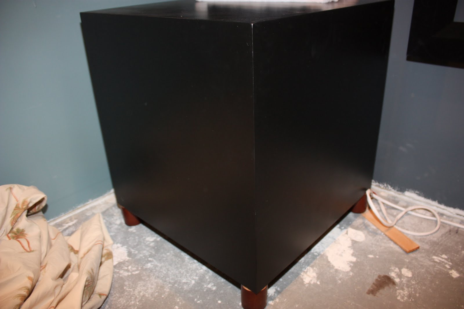

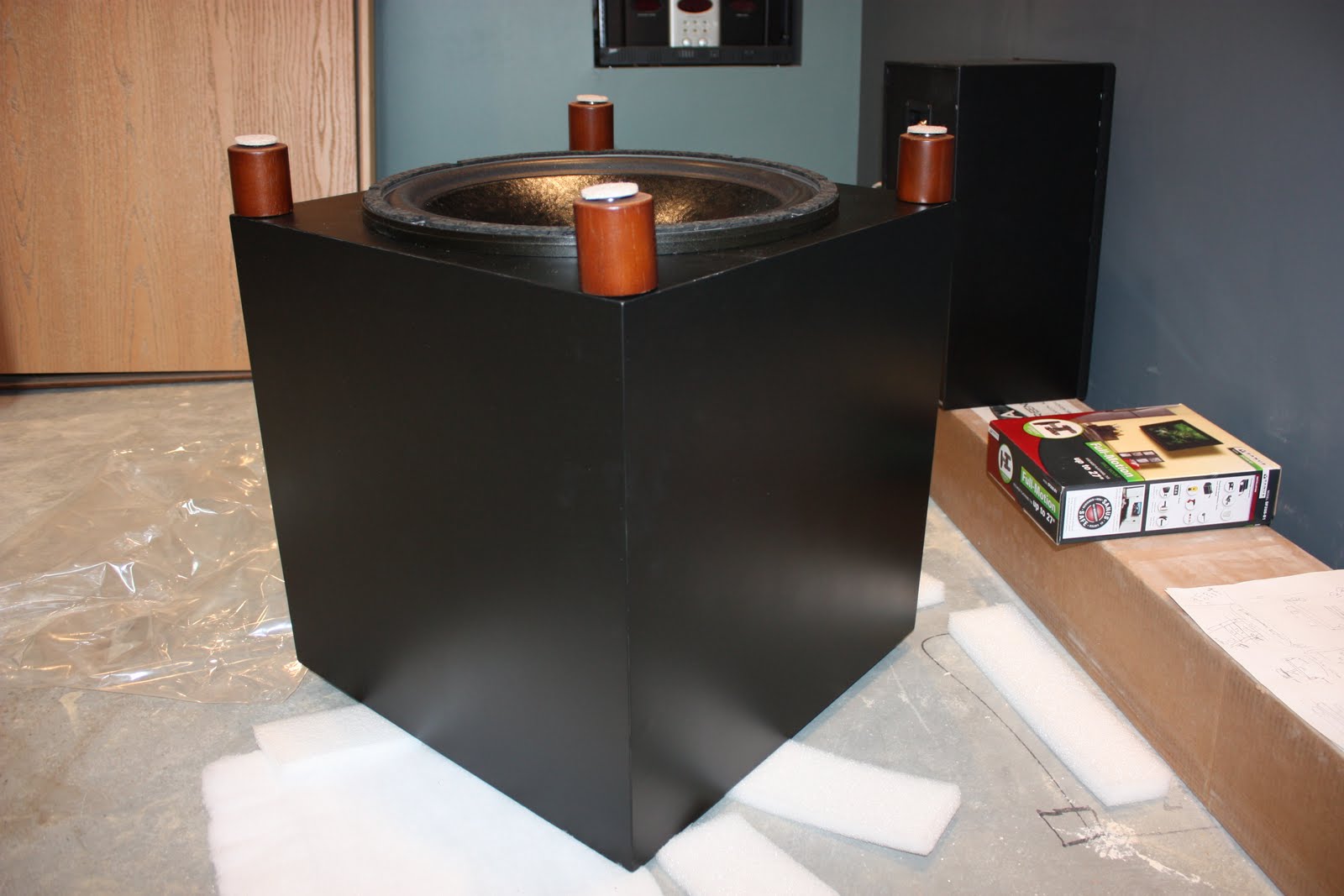

Take what you will +/- from the finishes...but they looked pretty good and have no shipping damage! These are Craigsub's last run of this finish and box construction..he is moving to integrated legs and the harder finish.
I'll more than likely be upgrading to the new enclosure per Craig's offer to everyone on the forum site.
I think eventually I'll rub the corrugated box image off the sub.....
Center
Will mount the L/R next week or weekend...
Maybe I'll get the wife to pose...but my GSD was all for it!
EDIT: Wish I would have made the AT screen work...I now believe that is the only way to go!
