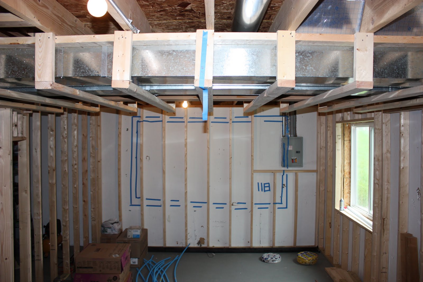

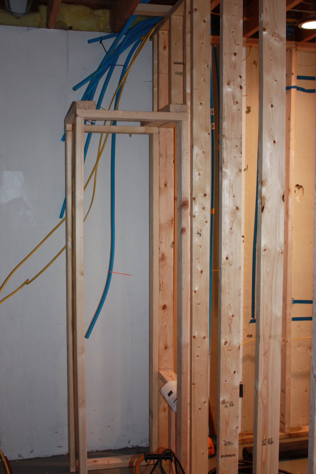

So after most of the framing is done....(notice the nice green summer grass outside)....decided the AV rack should go in the HVAC closet, so easy access (copying jamis theater and others ideas....)
*Rough outline of blue tape for projector hang ~16 ft, and screen layout*
*Rack frame-out and HVAC closet access*
*Rack frame with smurf and 2- 20A circuit runs*
(Should have done larger smurf.....)

I bought the 1/2"? instead of 3/4" smurf tubing..and subsequently bought a fishtape to run almost all of my wire due to the small diameter. Lesson learned.
**Electrical ran. Can lights hung. Smurf tubing ran. Lots of work in...a few weekends to wire and run tubing**
**AV Rack, Closet, Surround, Stairway up (basement theater), plywood for AV closet (no conduit ran for electrical, for code reasons needed plywood if I remember)**

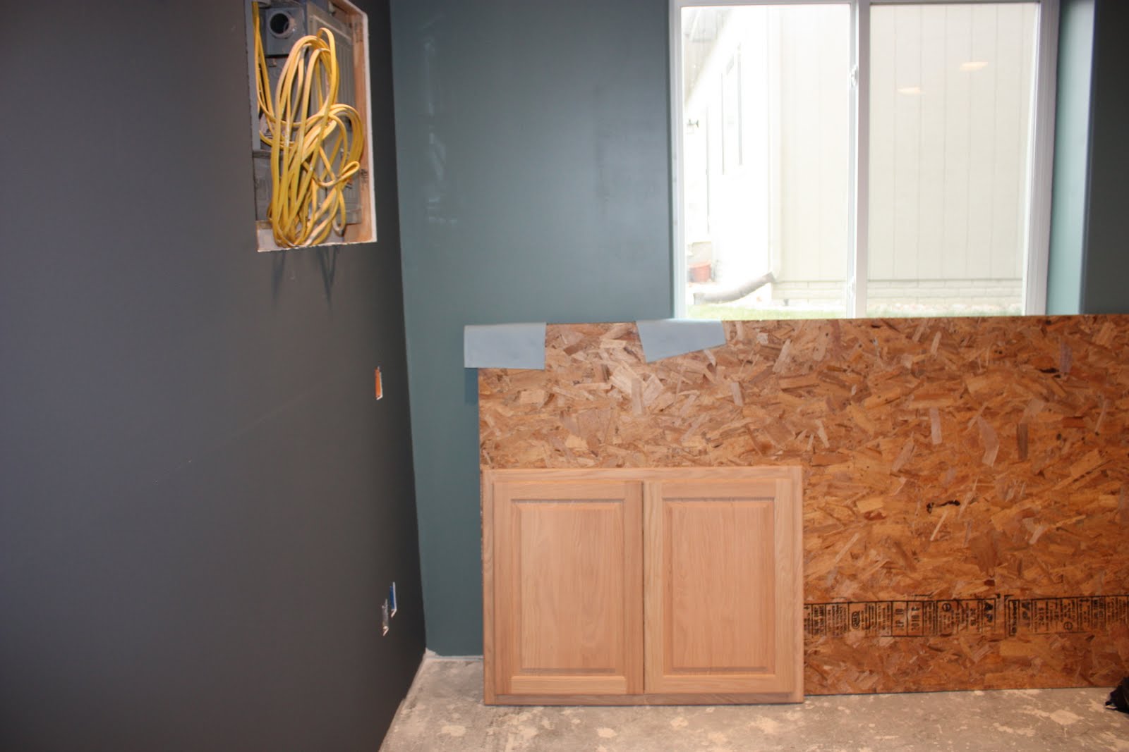

**The PITA electrical panel. My electrician buddy finally gave in to running the small panel instead of REPLACING my entire 125A panel with a 200A. In the long run he would be right, but we are talking getting inspected, extra $$, etc for a new panel. I wanted the small panel on the wall to the right for my screen's sake, he wouldnt budge because it would "look stupid". I call it a draw.**
**Rear of room. Will have a kitchenette, and bathroom. Bathroom electrical ran and rough-ins capped. Looking at cabinets, showers; didn't know how much a PITA the shower would end up being......(no walkout in basement)**

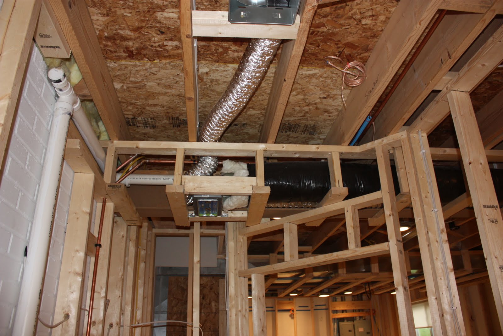

**Stage at where we had fun running more HVAC, stereo wire for the bar/bathroom ceiling speakers, and blockouts for all of the probable speaker locations**
**Split off some HVAC supplies to the main floor, good thing I'll be covering that up with drywall**
**Using the soffit to hide HVAC runs and bathroom exhaust fan, also ceiling speaker wire**

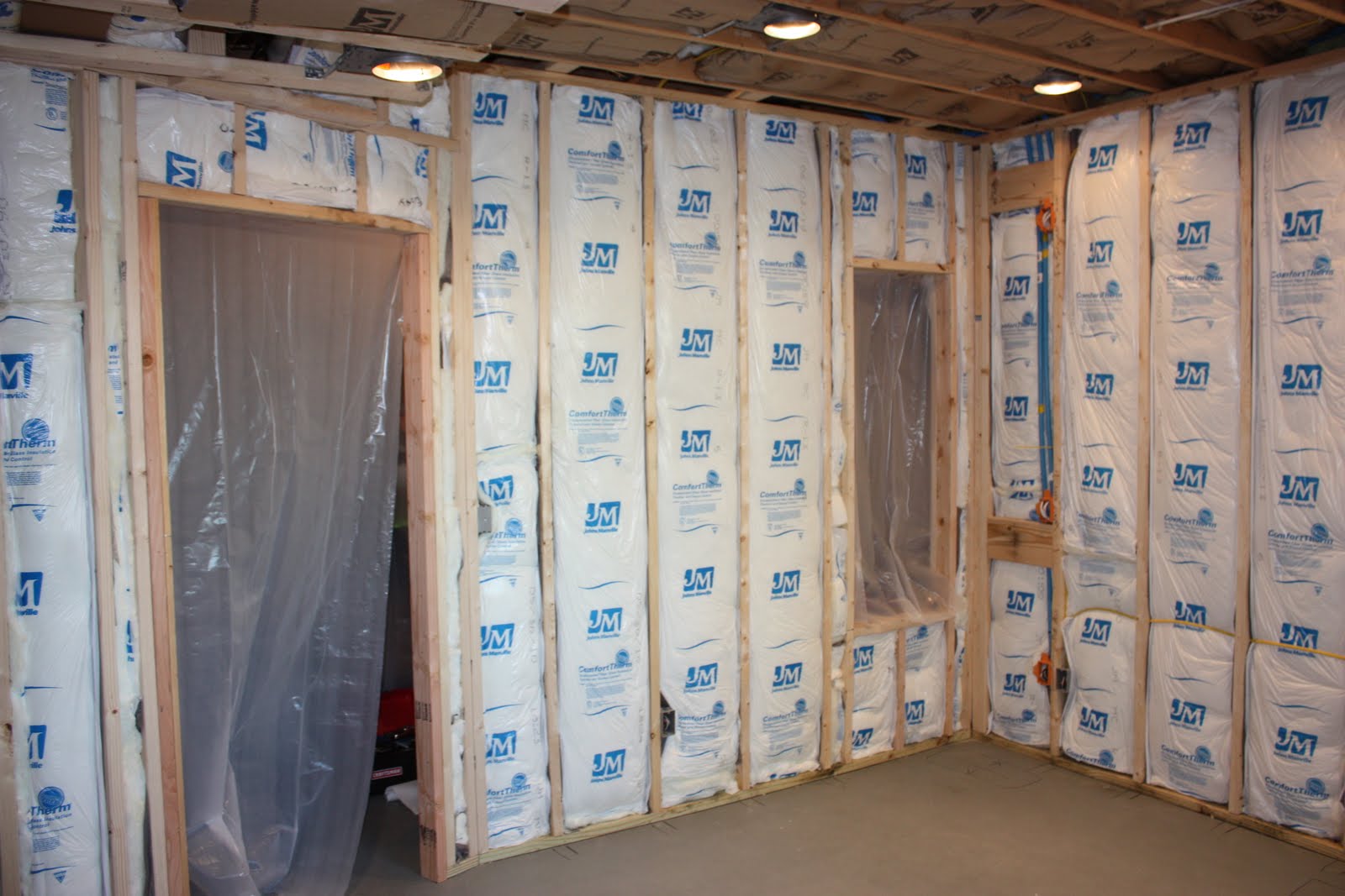

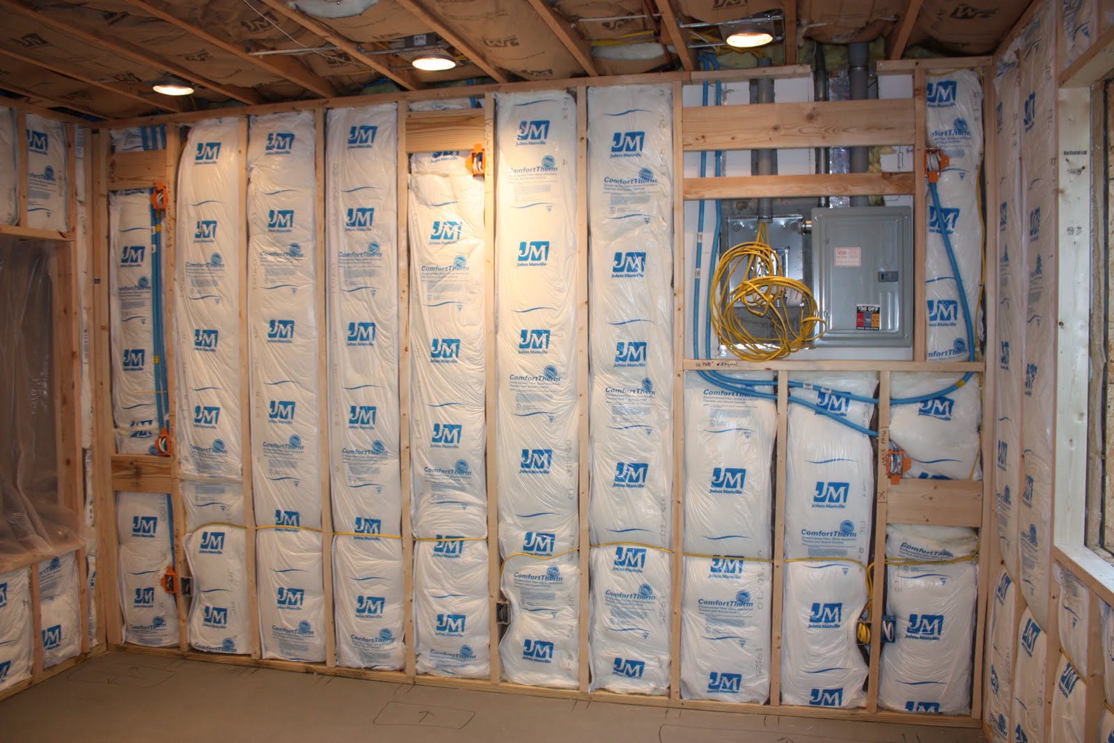

I was going to go the cheap route and get the large uncut batts of insulation, but instead opted for the "vapor barrier" rolls of JM. They cost more, but I have pretty weak skin that hates itchy things, so comfort overruled money here.
**Lowes had a special prior to Halloween that gave you a $150 gift card for how much I needed.**
Screen Wall with blockouts for mounts. At first it may look funny, but after hearing heights +5.1 vs without, I was sold. My center is above the screen due to the fact my screen will be low to the ground ~ right above the center outlet.
So, across the top you have the Heights and Center, the L/R, and Sub 1 (orange left box) and Sub 2 (blue right box). I only ran 12 ga speaker wire behind the studs, should have ran both RCA and 12ga. Planning on the CHT CS 18.T package most likely....
Additional panel is 60A, 40? of which is going to the AV Rack.
I tried to do the ceiling as tight as possible, but I'm not planning on this being anywhere close to soundproof. R-19 in ceiling, R-13 in walls.
Blockouts for surrounds and projector visible. Insulated the bathroom walls as well to try and help with sound control.
I had roughly 15 rolls of both left over, so I attempted/succeeded in putting them in the crawl space between the garage and kids bedrooms above it. To help with a) winter insulation issues and b) garage opener noise. After crawling all over, getting multiple bruises and cuts, it doesn't seem the insulation helped with either! Fail.

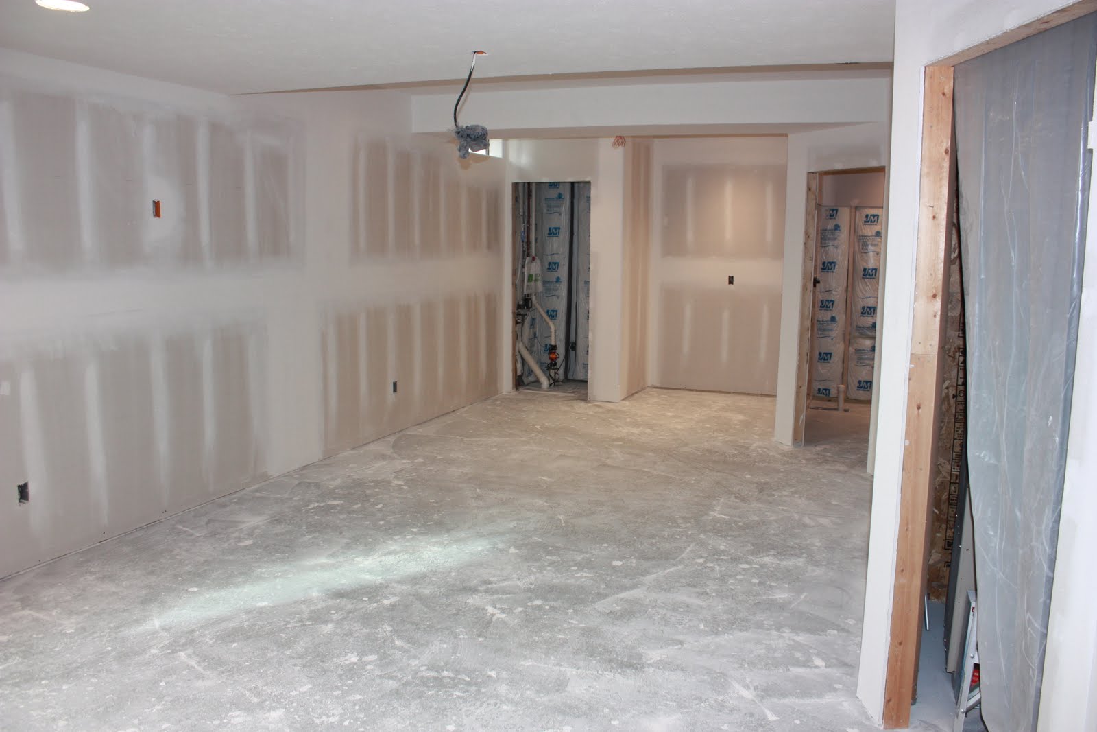

Drywall went up right around Halloween as well. I found a guy that did the entire basement, ceiling, cleaned up the stairwell plaster, all materials-- for $1300. Ridiculous good job; especially on the windows that were looking pretty beat up. Highly recommend for any Omaha/Lincoln guys not wanting to do it yourself.
Looking back at future cabinet/bar/bathroom/fridge....

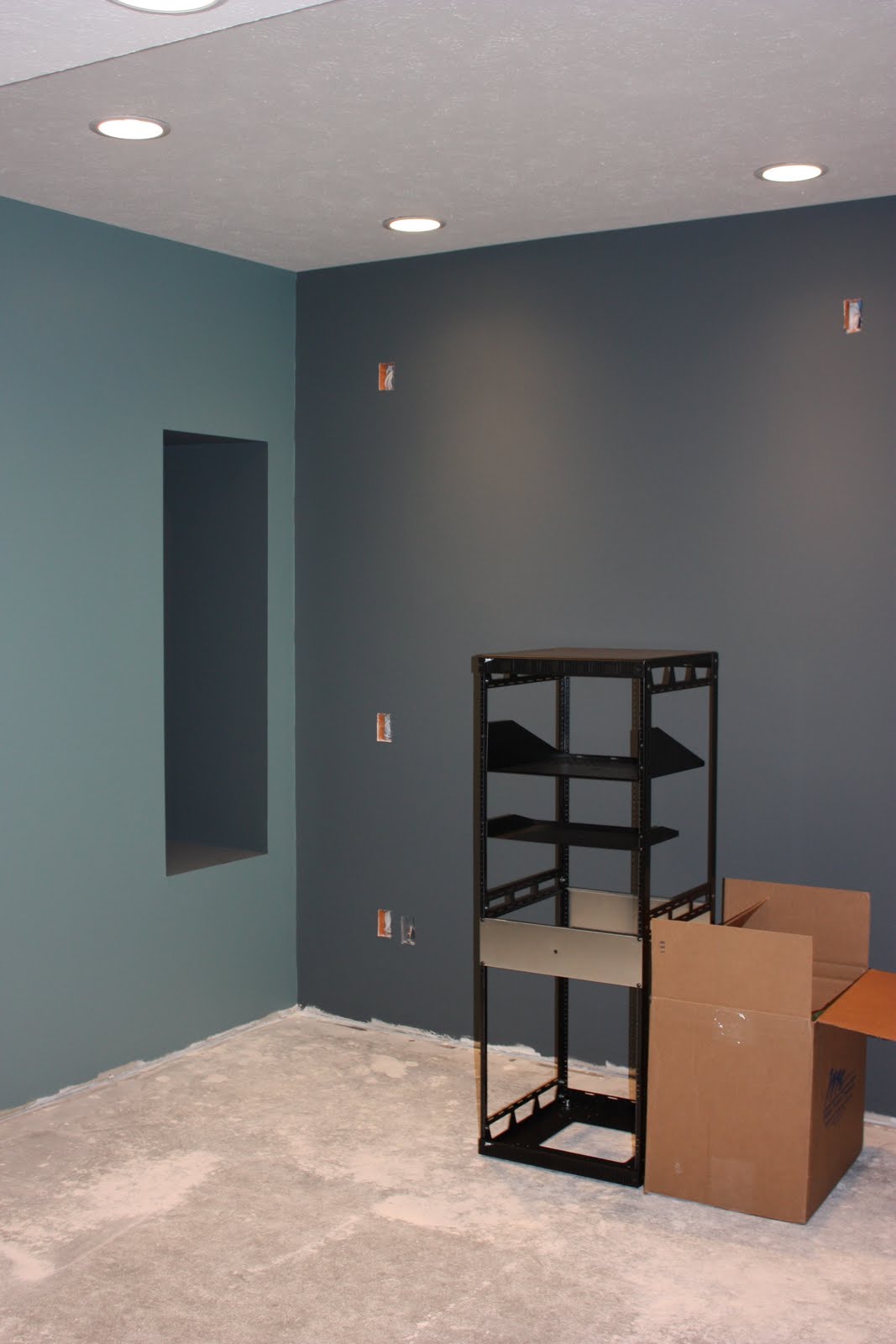

Larger view of room looking from screen side. I was going to put wall sconces on, but my electrical buddy convinced me we would have enough light with 15 6" recessed cans, so I listened. My wife also wasn't a big fan, since we couldn't put too much on the walls if we had sconces in the way.
I wish I would have known that the dust would get through ANYTHING. Our furnace quit lighting because a safety override switch noticed the filter was full of the junk (had changed it the DAY before they walled). I also covered everything in the storage room with 2 ply but it still got covered. I finally mopped everything up this week because the daily tracking of dust was affecting the home relations!

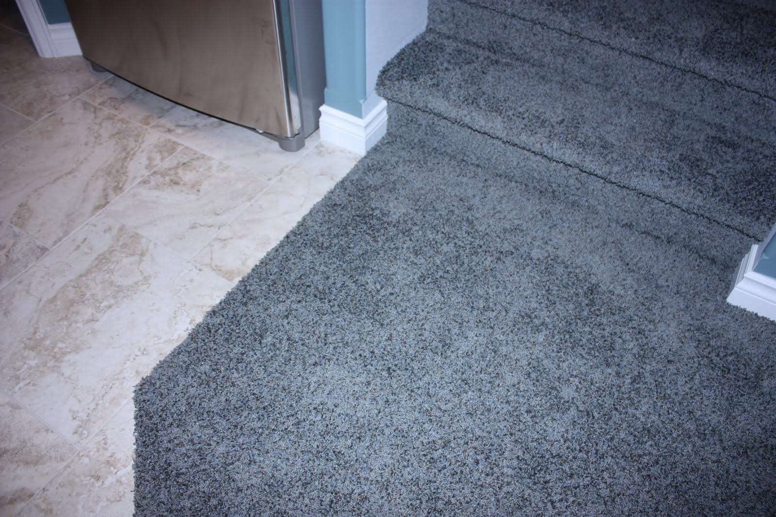

Looking into the bathroom and adjacent refrigerator. I wanted a full fridge in the basement with water hookup, and the only spot was next to the stairs...instead of opening to a wider look as you walk down the stairs, we had to throw the wall up, but ended up using the space well.
3/4 bathroom (32x46 shower).
I also liked Jamis HT a lot, I believe he had the can light above the fridge.
The only cheap alternative for recessed stair lights (other than low voltage stuff) around here seemed to be the Juno ones as you see here. I have three going up the stairs, and they were easy enough to install between studs. I also debated getting some kind of graphic eye or alternative, but will probably just go with regular dimmers.

Quoted: 54 Post(s)
Liked: 50
I always used to hate painting....I don't usually have the required patience.
This was different though.....seemed like the room had a purpose...other than all of those other rooms in a house!
This was the SW Grays Harbor for the screen wall.
Still wish it was black. Win some you lose some, and this isn't a dedicated theater room....
A better shot of the color. The light is washing it out pretty bad, as it seems to be a deeper gray...more like what you see in the AV Rack. The reverse side of the soffit behind is this color, and I'm debating whether to paint the ceiling between the screen wall and soffit this as well....before carpet.
Thoughts?

While STILL waiting for my cabinets...I measured and found out the AV Rack hole we had built would probably only fit a MA type rack or a DIY setup.
I was feeling lazy that week and had worked a little extra...so I splurged on a Middle Atlantic Slim 5-29.
I didn't really buy any accessories for it yet (fans, power strips, etc).
I'll figure that out later....welcome any advice on that. I don't know how I'm going to enclose the back of the rack yet either....MA panels or a DIY route...maybe DIY since CHT products are going to take my non-existent Christmas bonus.
Daddy's helper. Kept climbing in it as I tried not to drop the steel pieces on him.
CRAP. I thought I measured this right...It looks too big.
I also thought for some dumb reason the trays mounted behind the rack rails and needed to be secured with nuts. Trying to screw in trays behind the rack rails by yourself turned out to be a pain. My dad was over one day and showed me they probably went in front and needed no nuts.
I was fairly embarrassed. I think I even asked people on here how to do it...sorry for wasting your time!
It fits. Well that was close.
And how is there still drywall dust floating around?

After 3 weeks, my cabinets are finally here and ready to be hung. They are unfinished of course, so that should be fun.
Electric Panel Cover.
In hindsight I probably should have gotten a flat non-descript metal panel to go over this..but we were thinking of future selling as well as current use. I will most likely paint this to match the screen wall so it can "disappear" during films....part of it will unfortunately stick past the edge of the screen. Minor fail in planning.
A look toward the action in the rear of the room. Drawers, cabinets, shelves...
I was also working on my bartop at this time. Found a spot to anchor it and used some meaty cement screws and a hammerdrill. Mmmm the smell of concrete burning.
Had to get a shot of the wine rack. I'm pretty excited about this. Because I really like wine...and beer....any guess to where the wine rack may go?
I was kind of shocked at cabinets and the price tag. I guess there is quite some labor involved if it took someone 3 weeks working almost nightly to build, but man. It was 1/3 of my total cost to this point.....
I'm not sure what stain to go with...could use some advice here...
Going with white trim and doors......what color would you recommend? Was thinking something along the lines of Sherwin Williams Warm Chestnut 3114, Burnished Walnut 3119, Pecan 3124, or Armoire Hickory 3129. We want them to be dark enough to not look weird with white trim, but not too dark to really make the room like a black hole.
http://www.sherwin-williams.com/do_i...ains/interior/
If you have a minute, throw me a suggestion! Want to do this in the next few days!
