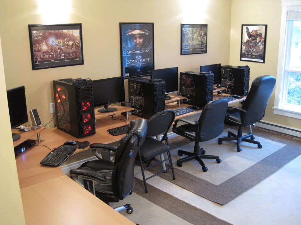

Hey Everyone,
I have been inactive for a while but just thought I'd post a quick update. I did some work on my place recently, new baseboard and door/window casing in my two bedrooms. Since doing this I have also switched the rooms around moving my LAN room into the master suite for added space and comfort while gaming. The old room was only 9x11 and the new one is 11x14. I also had an electrician install some 20amp plugs since I had issues blowing the fuse with all the computers running, especially in the summer with my AC unit. I am also in the process of upgrading one of my PC's to a Core i5 2500k system with Z68 mobo, possibly my main.
New pics have been added to the main page area, please feel free to comment on the change.
Here is a quick sample

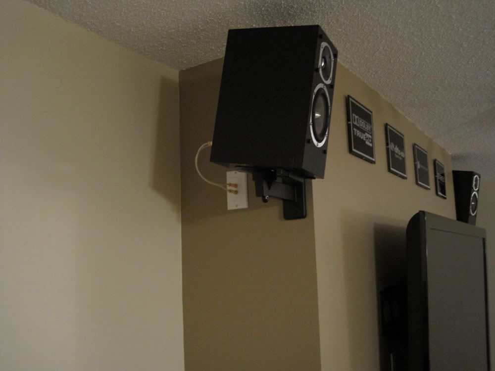

-Moved theater setup centered around fireplace
-Added/mounted height speakers
-Painted entire room
-In-wall wiring/wall plates
-new baseboards/moldings
-aggressive cable management
I thought I would share my step by step progress of the in-wall wiring with you in case anyone else is contemplating doing this. It's fairly easy to do yourself.

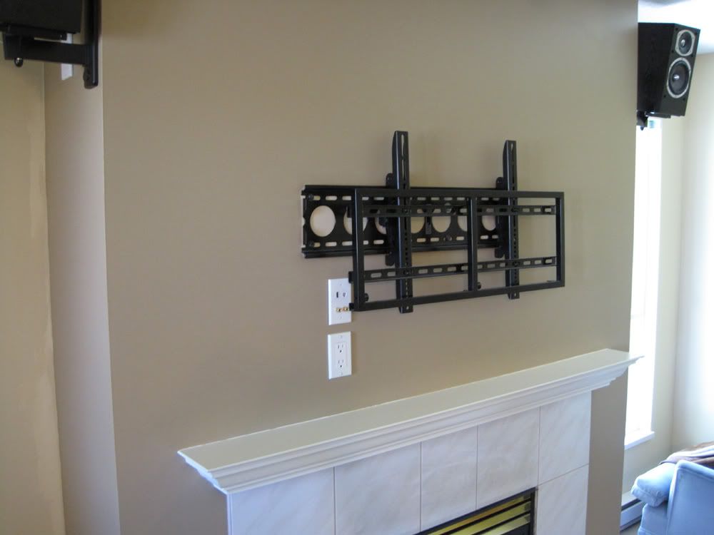

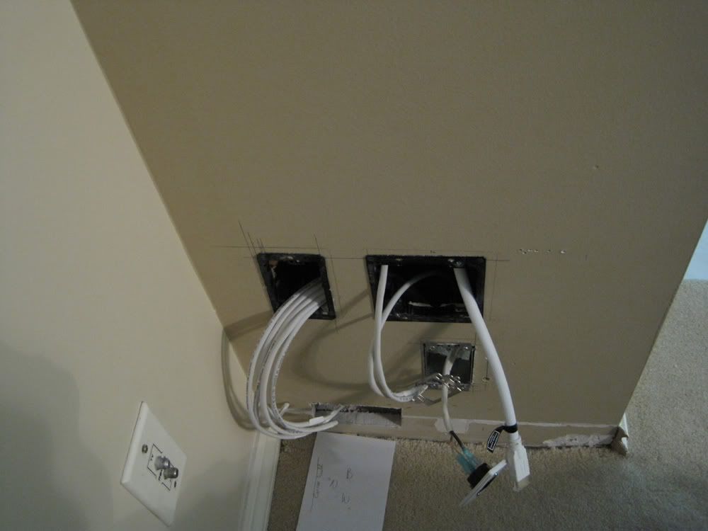

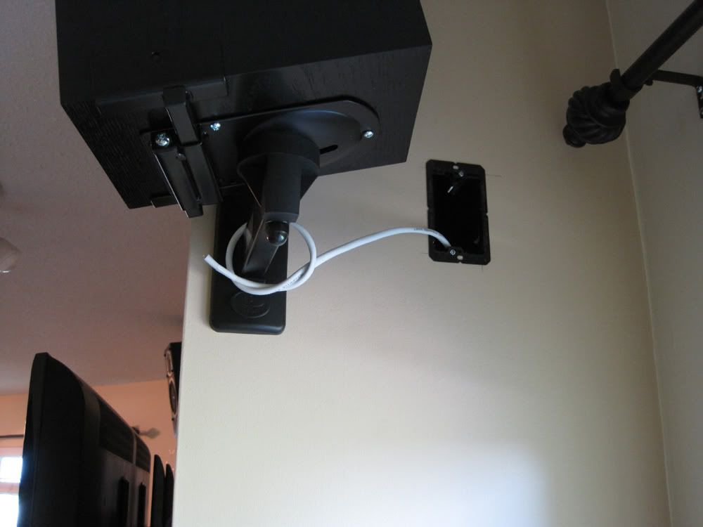

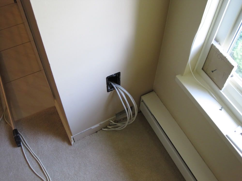

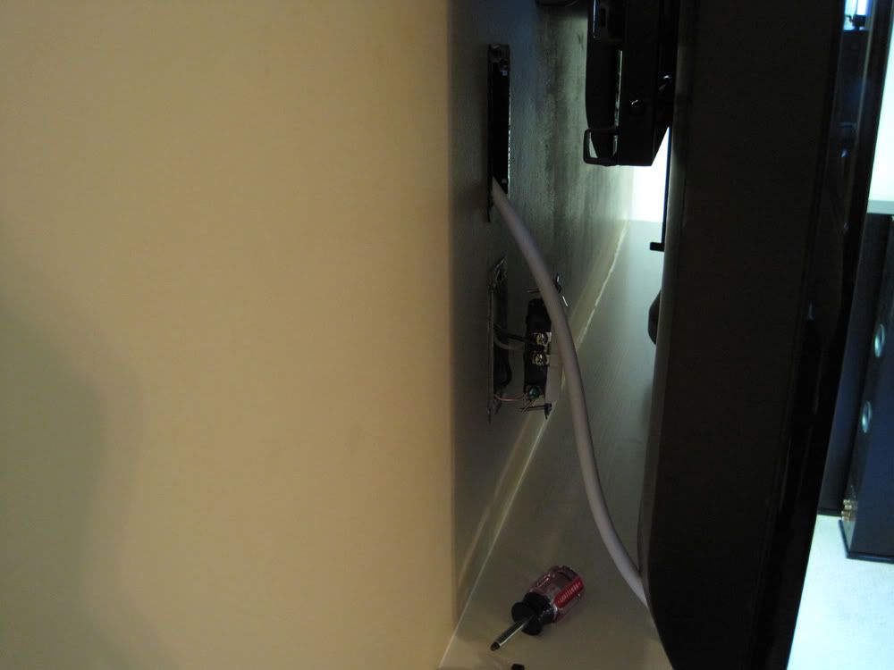

This is how it looked before I did the in-wall wiring. As you can see it's a little messy.

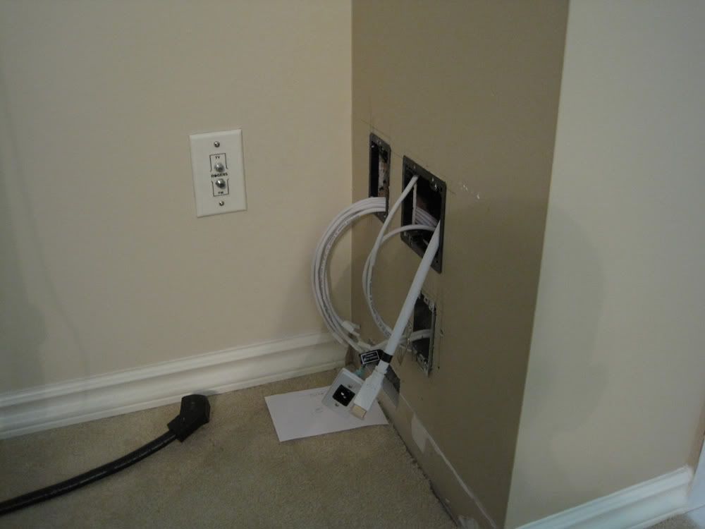

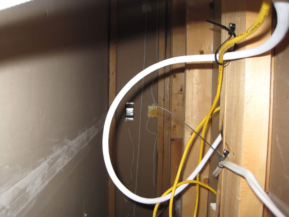

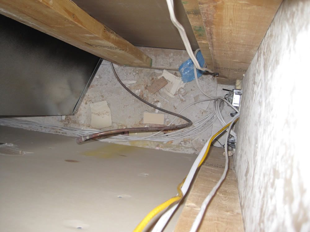

I cut my wall holes, attached the low voltage mounting bracket and labeled the wires before feeding them through. I numbered them on both sides of the wire.
Then I put in zap ties to pin the wire to the wall and keep it away from touching the top of the fireplace. I pulled it tight to keep the excess wire from dangling before tightening the zap ties.

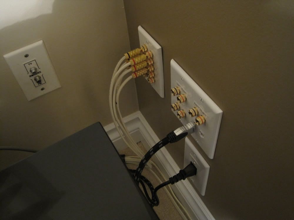

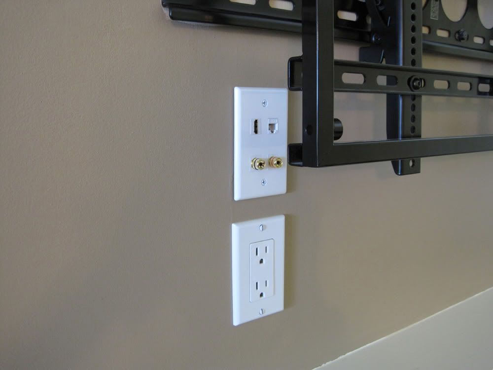

Now the finished product. Plates on looks great. Very clean and professional.

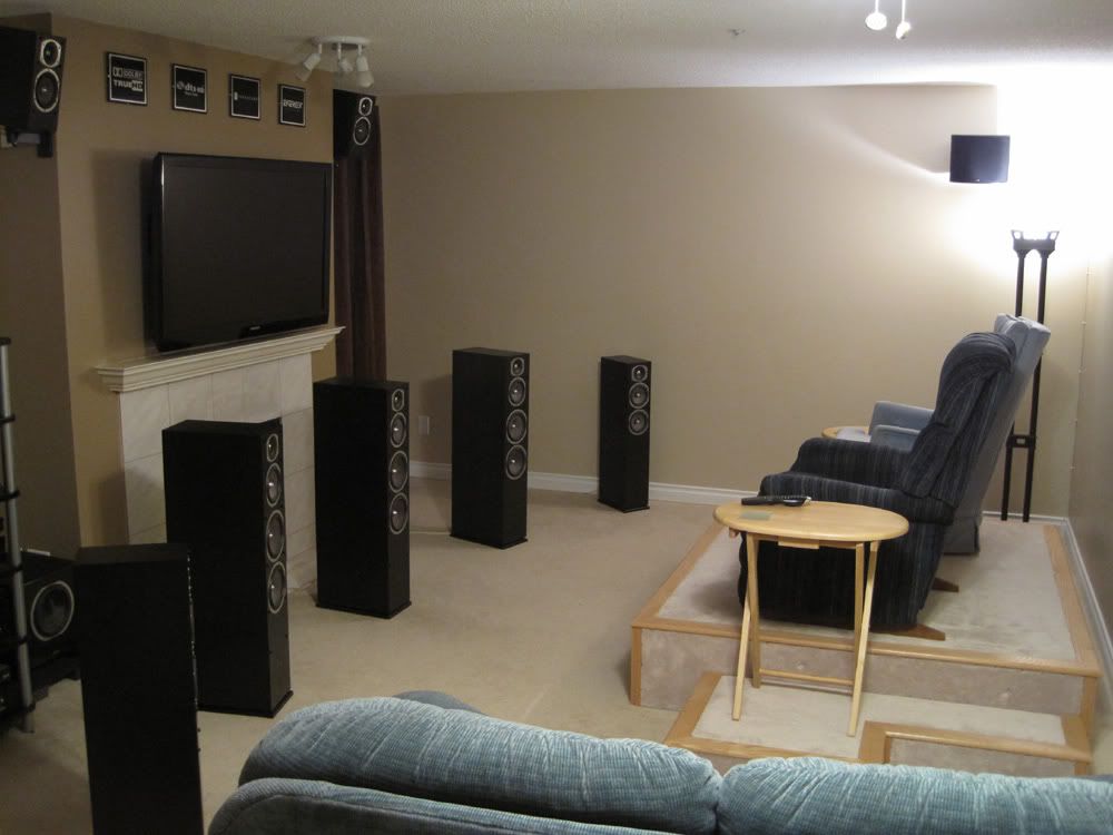

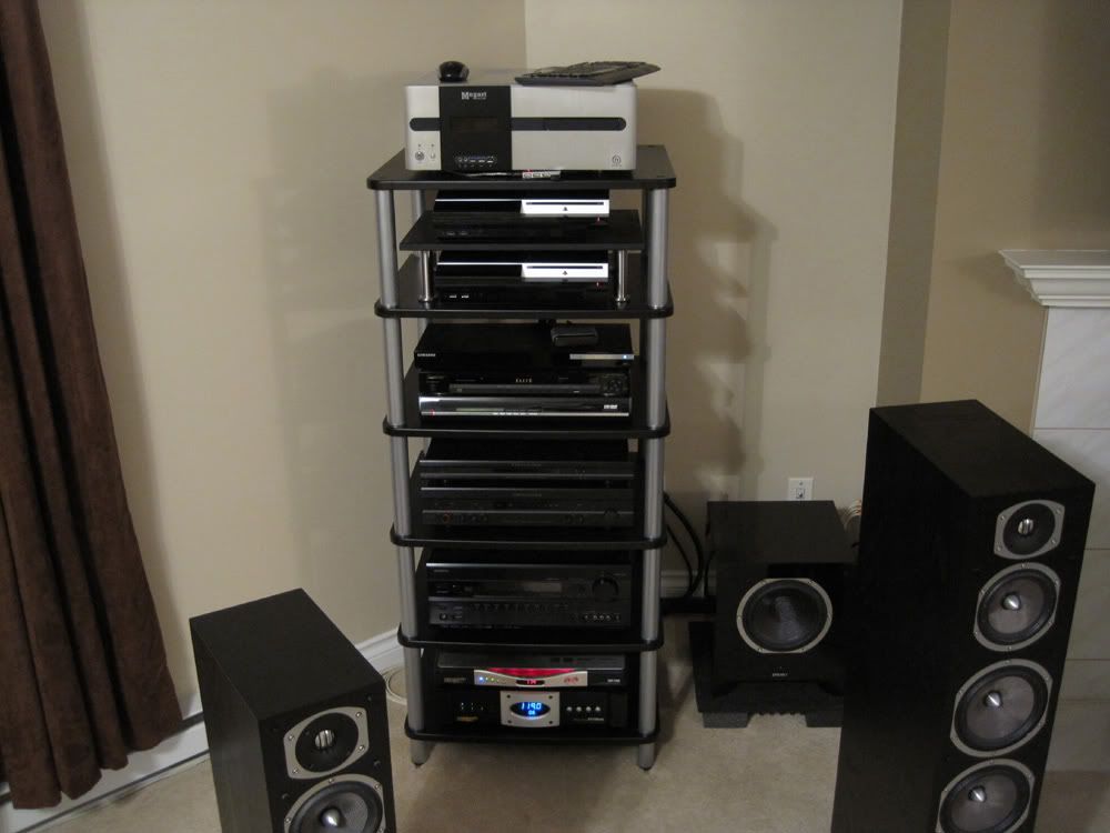

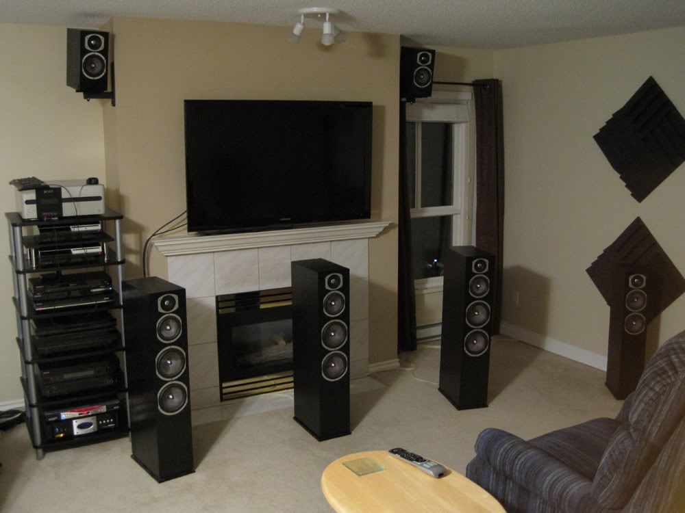

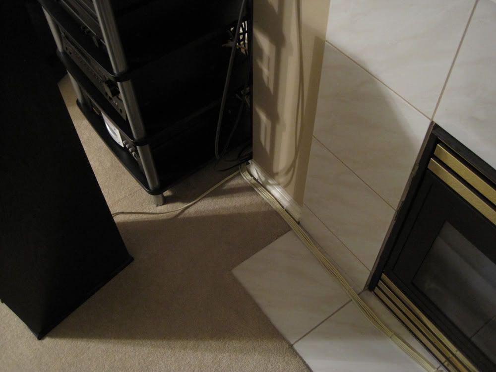

Here are a few new shots
Before
After

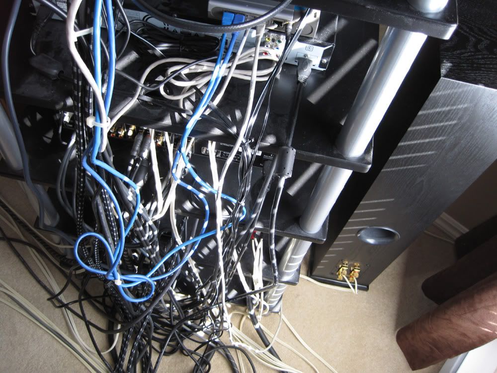

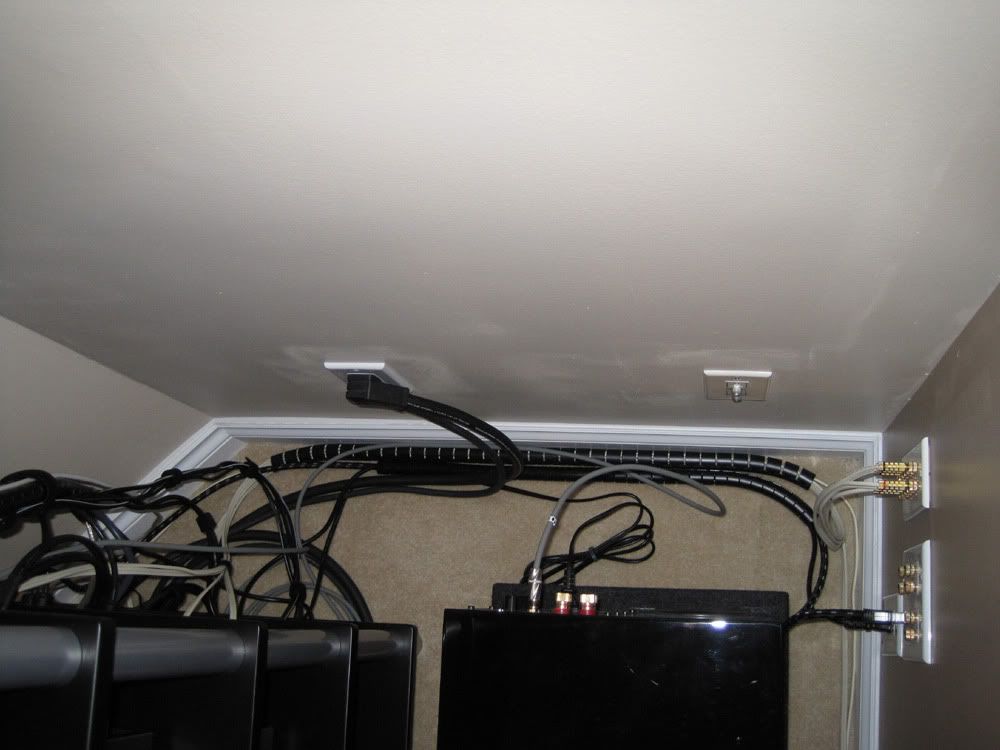

And I did a little Cable Management
Before
After
cablemanagement_zps7e586d44.jpg?t=1348356757

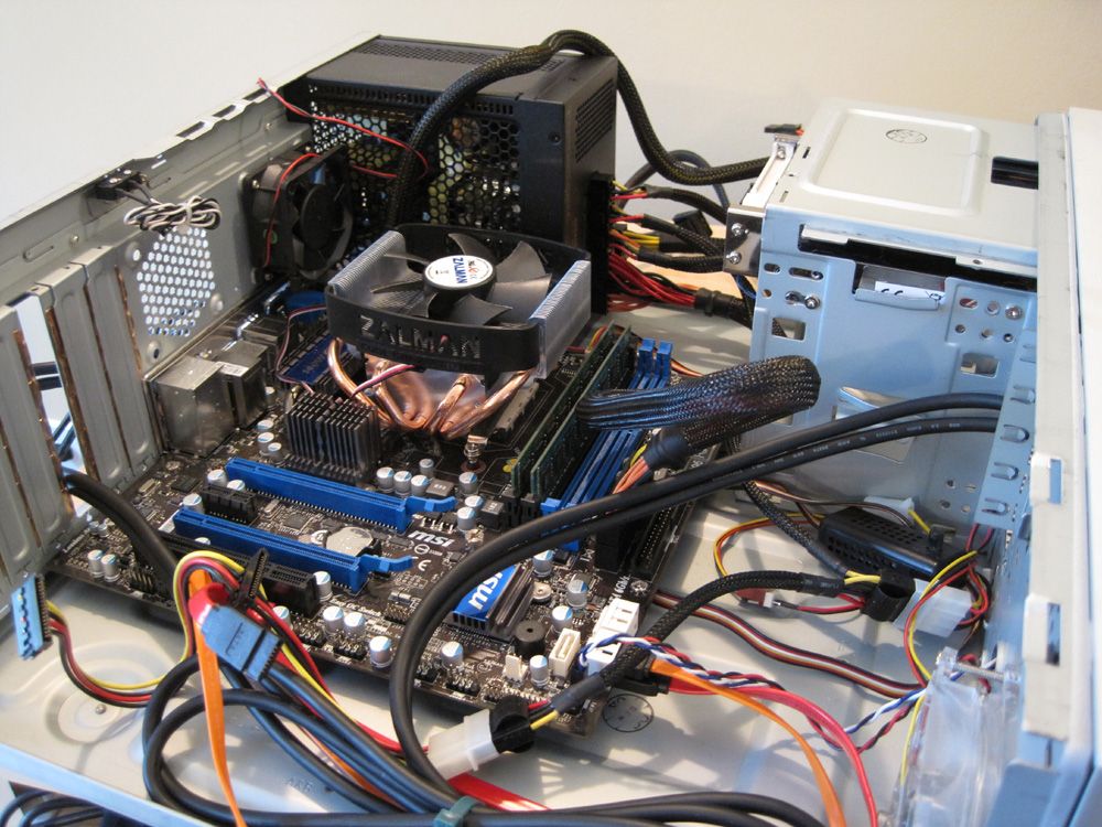

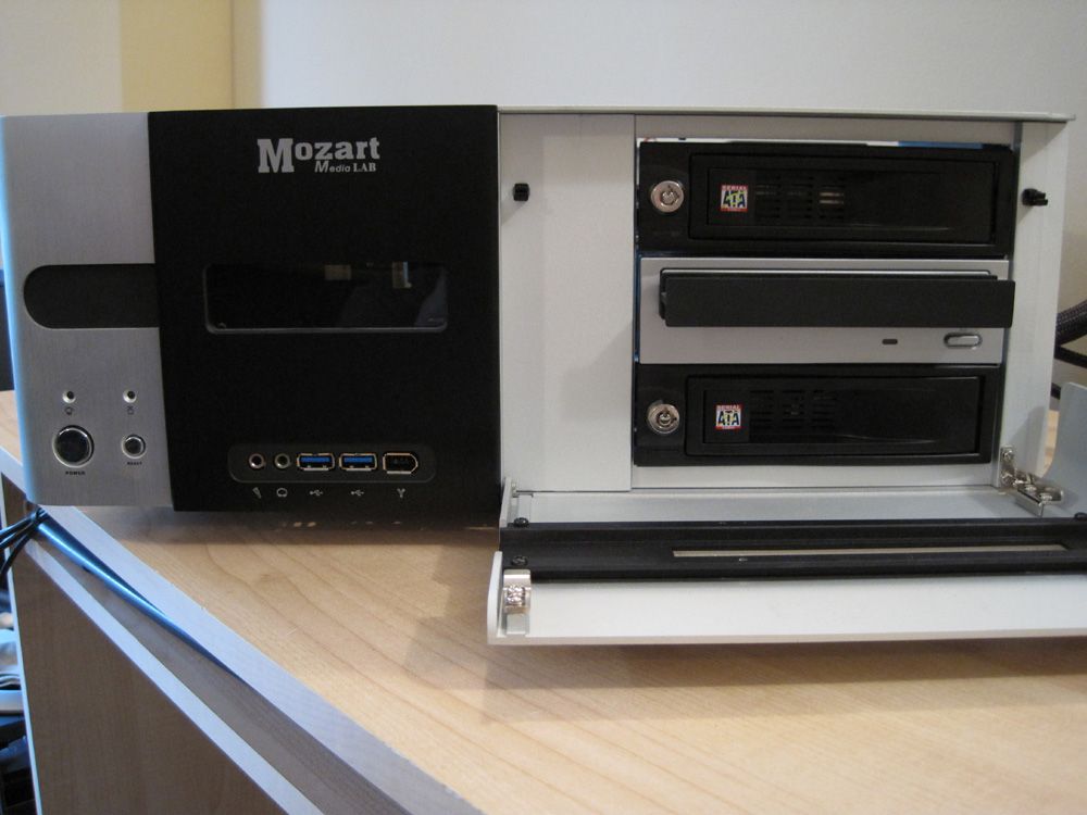

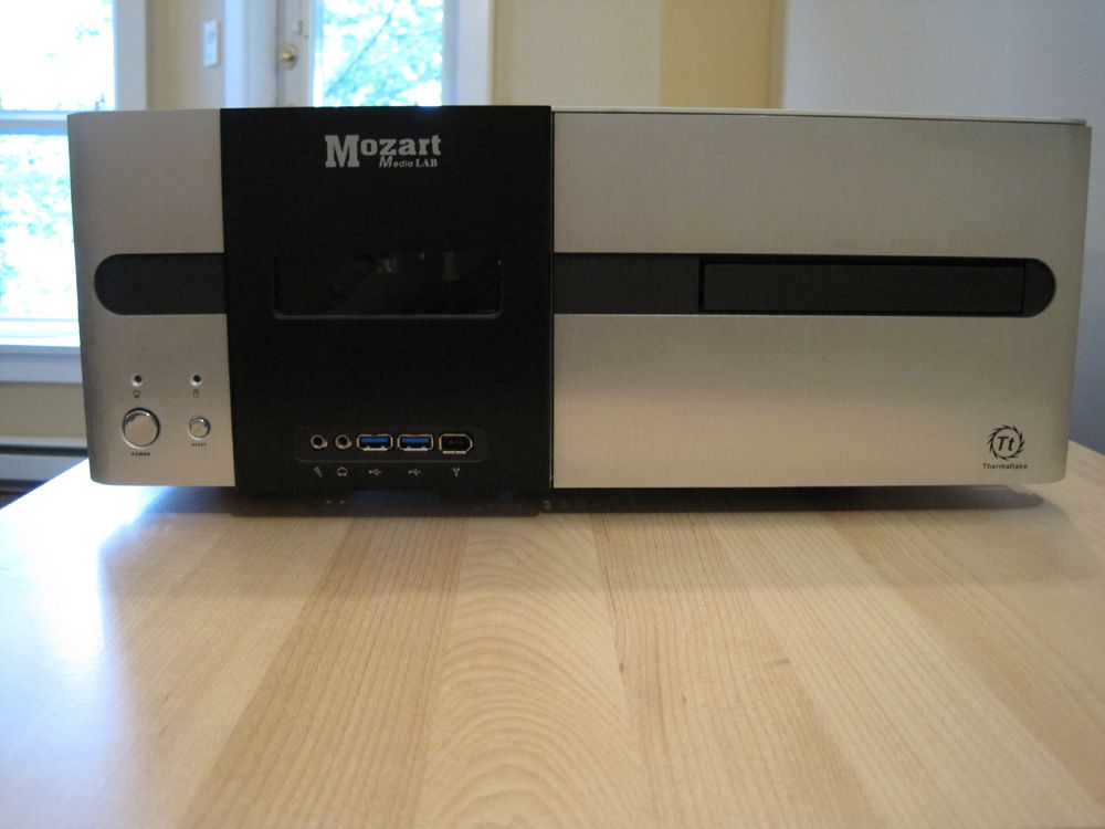

Here's a few more mod's I did on my HTPC
First, here are the new parts I put in a while back, showing the Seasonic PSU and Zalman heatsink

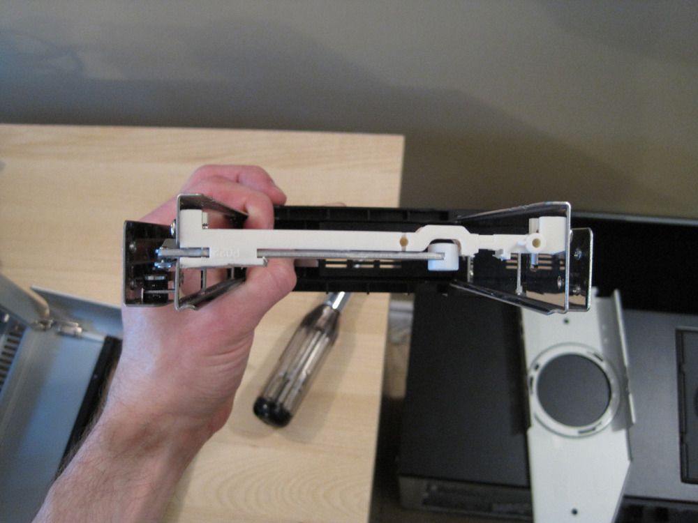

Next, I had a faulty hotswap SATA connection and the warranty was gone, so I converted it to hold IDE HDD instead. I had to cut the plastic back a fair bit but it works just the same.
Here it is with HDD installed

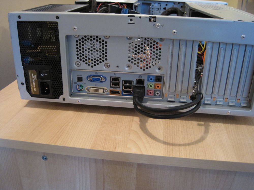

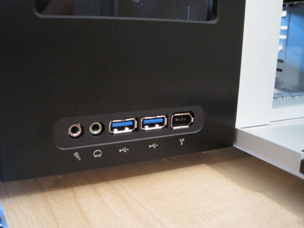

I also converted the front panel to house USB 3.0 using USB 3.0 extension cables. This was a lot of work actually and its a pain to take the front plate off to show you what I did. Maybe I'll snap a picture next time I make an adjustment.
Here's where the cables connect to the back putting the rear USB 3.0's into the front panel

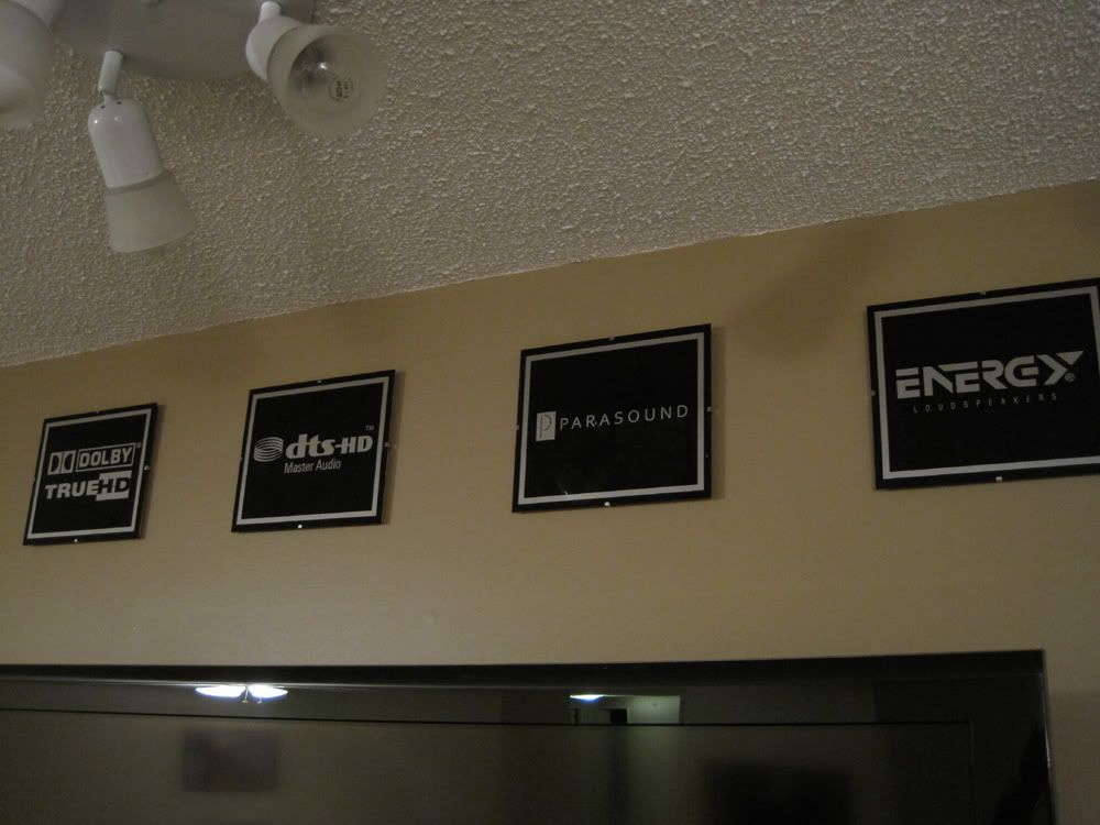

Wow, great room - love the look of so many speakers staring at me. Where did you get the dts, dolby digital, etc. signs? thanks
Thanks. I'm quite happy with how everything turned out.
I got the signs on Ebay. About $13 per sign. They look even more professional in person than through my camera.

Great setup! I really like the wire management as well.
Do you have any pictures of how you have the surrounds set up?
Do you like having the height more than the rears? I am looking to buy a new receiver and I am thinking about maybe doing heights instead of rears. It would certainly be easier to wire!

Cool I want to be surrounded by sound as well!! Great

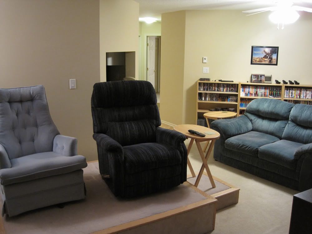

Why are the chairs on risers the tweeters are supposed to be at ear level smile.gif
Thanks! Wire management is a great pain!
I don't understand, what do you mean how I have the surrounds set up? The 3rd pic on post #40 shows my right surround with the wire neatly pinned to the wall. The pic below that, I just missed the left surround with my camera angle, sorry. Trying to show the rooms awkward shape as well. I'll get more pics up later.
Heights are better than rears I find. They tend to get more action.
I can't please everyone! rolleyes.gif Haha. The chairs are on the riser because the TV is too high for the seating distance, would be like front row at a theater otherwise. I am planning to rip apart my mantle and rebuild it giving me a chance to lower the TV. I would have done this along with everything else but my friend who designs that stuff was busy during that time and I just wanted to get my theater working again. Also because I re arranged the room and had no where for the riser to go, I figured I'd use it rather than throw it out, sort of convenient. I may also build risers for the speakers though.

Oh yeah, hiding the wires do look a lot better, great job!.
Can you tilt the towers a little so they would be pointing at your ears? :)  these should work http://www.amazon.com/Lovan-Speaker-Stands-Matte-Black/dp/B000OONBZ8
