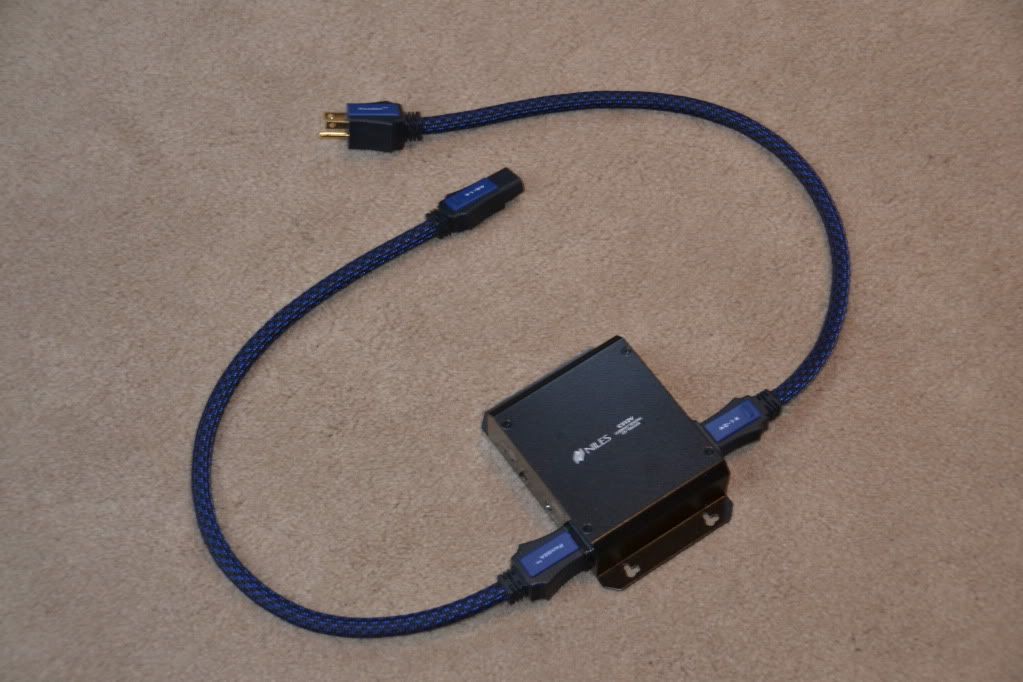

I couldn't take the lack of auto on/off between the AVR and amplifier (helps the family out too since they often forget to turn off the amp when shutting the system down), so I purchased a 12 volt trigger and short Pangea power cables to connec the AVR to the Furman power filter. A 3.5mm mono cable then connects between the 12v trigger and amplifier to turn it on and off when the AVR is turned on or off. smile.gif
The Onkyo does have a 12v trigger, but it is designed for zone 2, not the main mad.gif

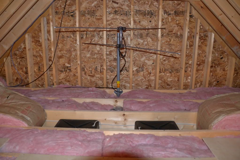

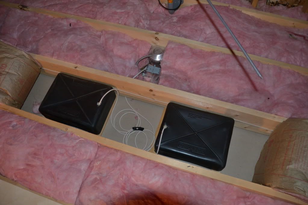

I thought I would also post a couple pictures of the Dynaboxes and FM antenna located in the scuttle above the family room....I mean HT... I've been very happy with the result on both the sound quality of the speakers and FM reception
Dual Dynaboxes for the two in-ciling center speakers
Dynaboxes with FM antenna
Other side of the dynaboxes - ceiling with dual center speakers (angled woofer and directional tweeter)
