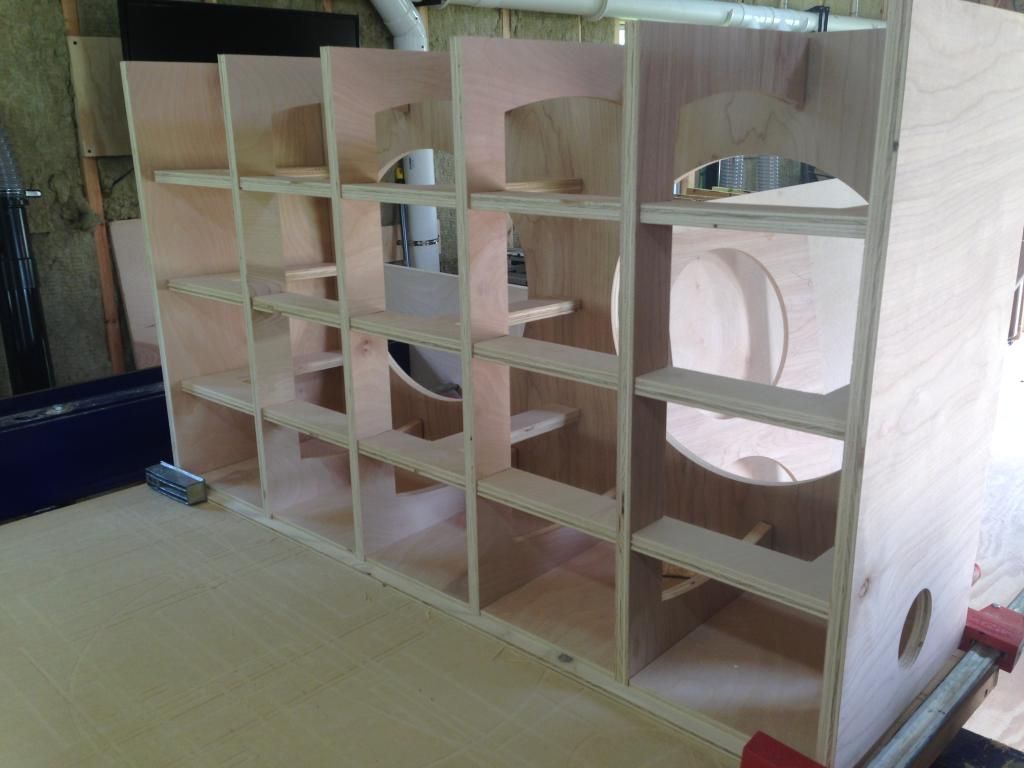

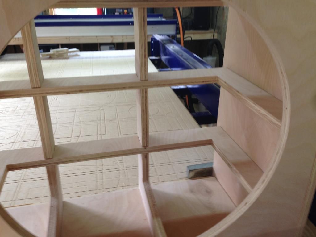

Originally Posted by Gorilla83 View Post

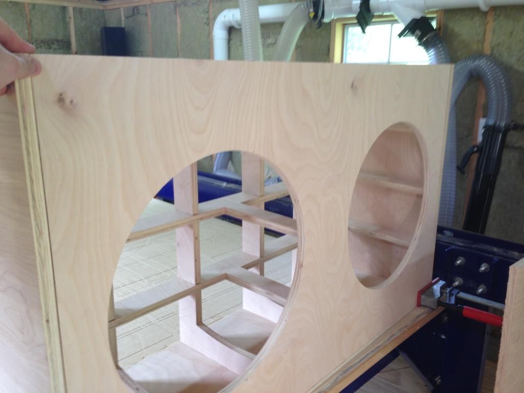

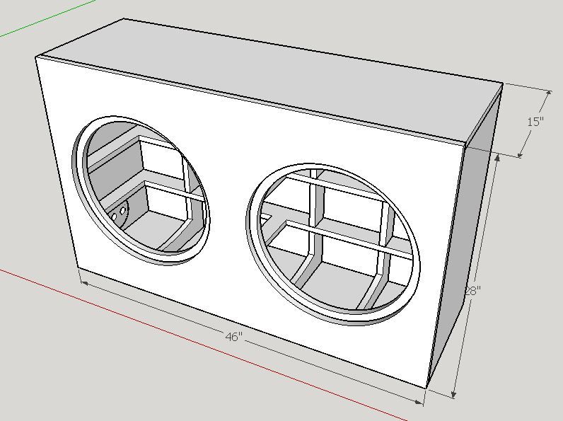

This last box I proposed for behind the rear row had one box with dual woofers. The issue with the dimensions here is that the panels are tall and long which consumed unnecessary lumber when it came to nesting the sheets for cutting. I'm thinking of doing two (or eventually more) boxes split up to make cutting more efficient. Proposed - 2 of these behind rear seats? This is also nice because I could play around with placement easier. Only downside is more external wiring, but not a huge deal.

Why not go all out (more than you already have) and put the subs in the riser firing upward underneath the seats?
I've thought about this, but this essentially means I would have to rebuild the entire riser to the proper dimensions, internal cubic feet, add bracing, new carpet, etc. The current riser is built 12" on center with fiberglass insulation, 2x12 construction, double plywood decking, etc. That's a lot of work and money (this riser with carpet cost me 450-500ish already) for something I'm not certain I'd be pleased with the end result, right? I could build a couple of these boxes for under 200 (plus quite a bit of my time of course) and they could essentially be used anywhere.
Gorilla83 is offline
I like your current solution. You could do less bracing and couple them to your riser, so you really beat up your back seat passengers. If you went that route, less bracing would mean more tactile transduction to that brick house of a riser you built.
Cool, thanks for the input. I'm going to play around with these this weekend and time permitting cut one of these boxes as well as the 24 box for Mr. Sibuna.

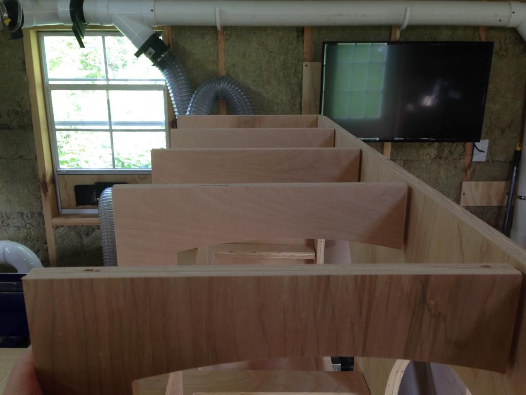

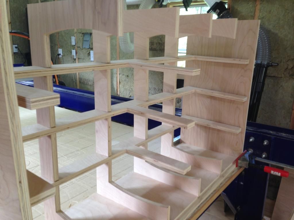

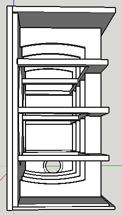

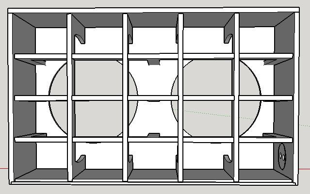

Fortunately I was able to cut a prototype for the rear enclosure today. Details:
I'll be powering with one channel with either my Peavey IPR7500 or Inuke6000 DSP.
Google sketchup, including dimensions:
Cuts and dry fitment:
Should be gluing her up in the next few days. Finishing will be duratex to match my other gear - I love that stuff!
carp, ambesolman and popalock like this.

Looks great ... glad you finally made something audio related for yourself with the cnc

I'd be happy to let you cut mine on your CNC! You could could cut it and mail it off, should be there by the time I get back into town
Just so you have the plans...
