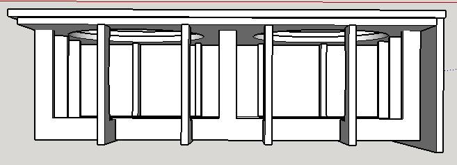

Originally Posted by klipsch View Post
Do the subs come with pre-cut BB plywood dual opposed box pieces for gluing and screwing?
If there is room, I'll gladly swing by again on the 2nd

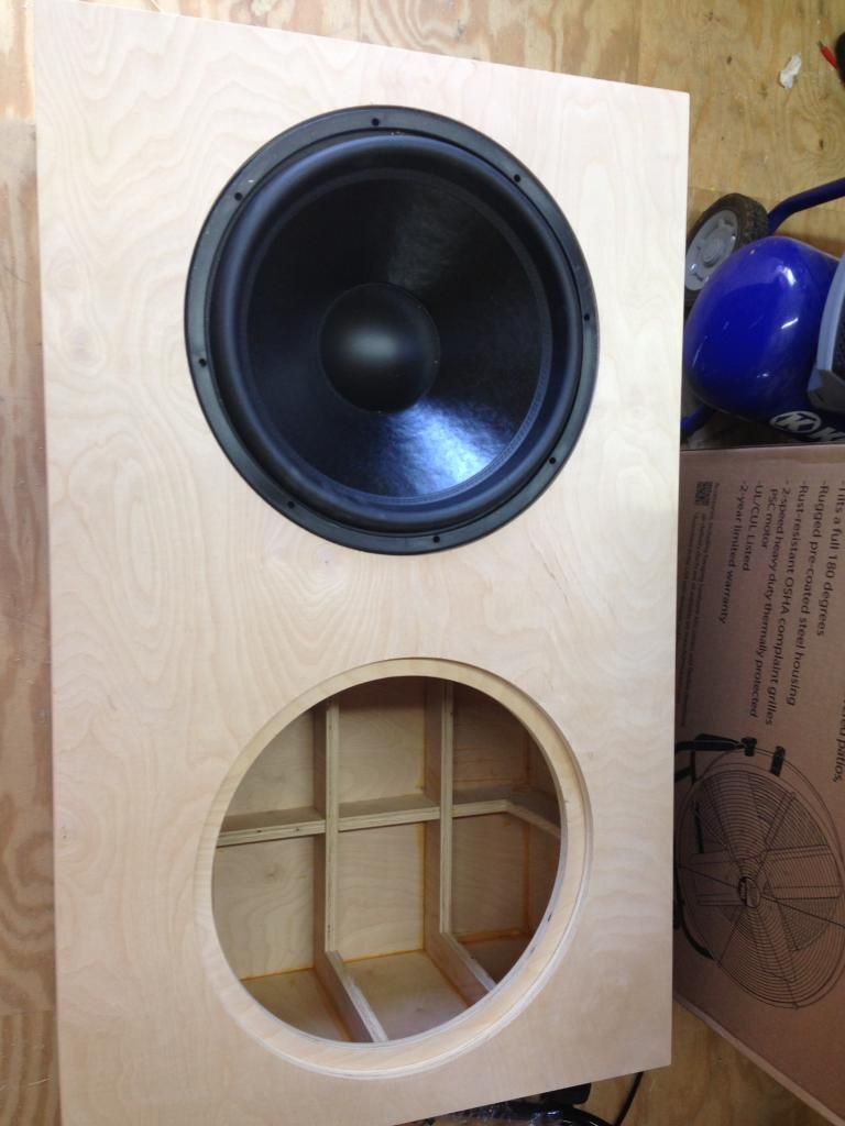

Honestly - I've already got several drawings down for DO 18s that could be cut quickly and assembled very quickly.
And I'll mark you down for the 2nd. Send me your email so I can add you to the list - communicating here via PM is awful lately.

Examples - DO 18s

Originally Posted by Gorilla83 View Post
Examples - DO 18s
What volume you get with that? How close together do the braces need to be, every X inches?
Sent using Tapatalk since the mobile version is still 👎
These guys are a little smaller around ~7 cubes. They were built to fit 8 DO boxes right behind my screen. Ideally I'd add another cube if wasn't space limited (maybe another inch in the 22x22 direction. Ideal bracing will be leave no sections larger than 6-8" unbraced when covered by horizontal and vertical bracing.

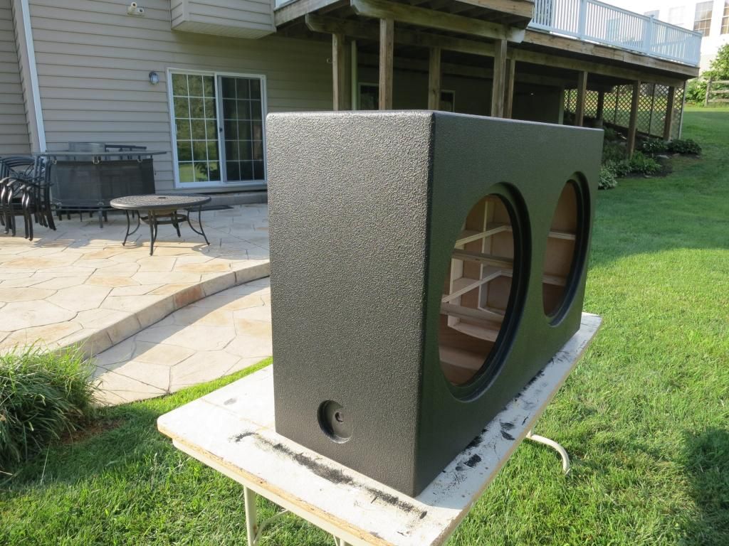

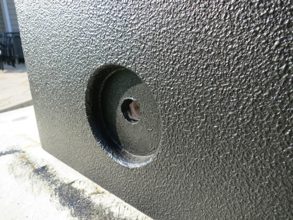

A few updates:

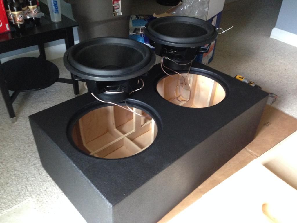

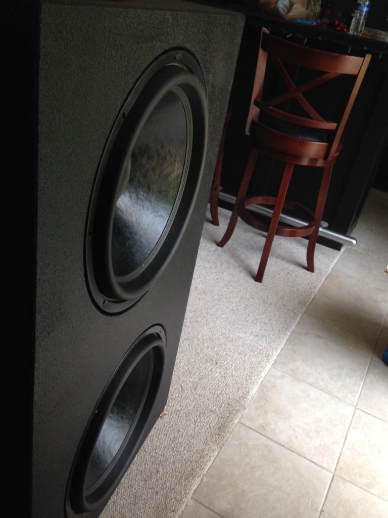

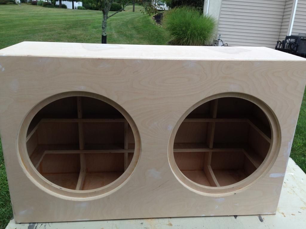

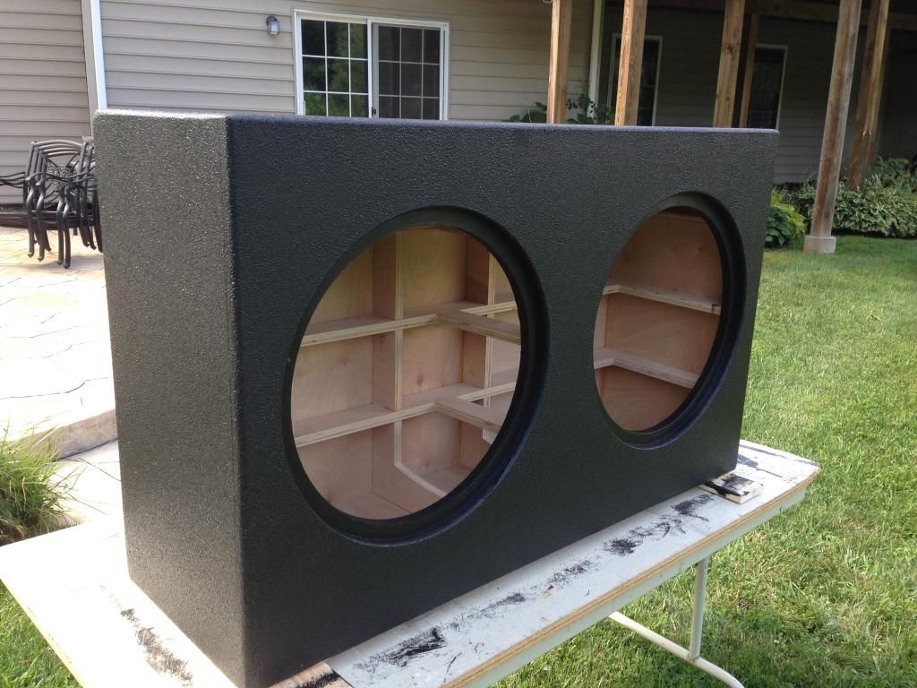

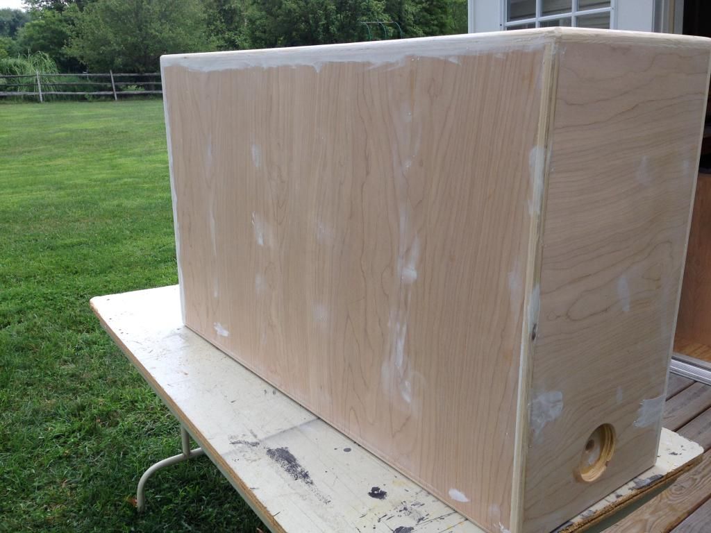

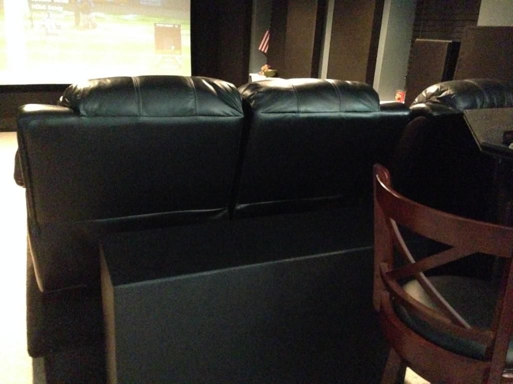

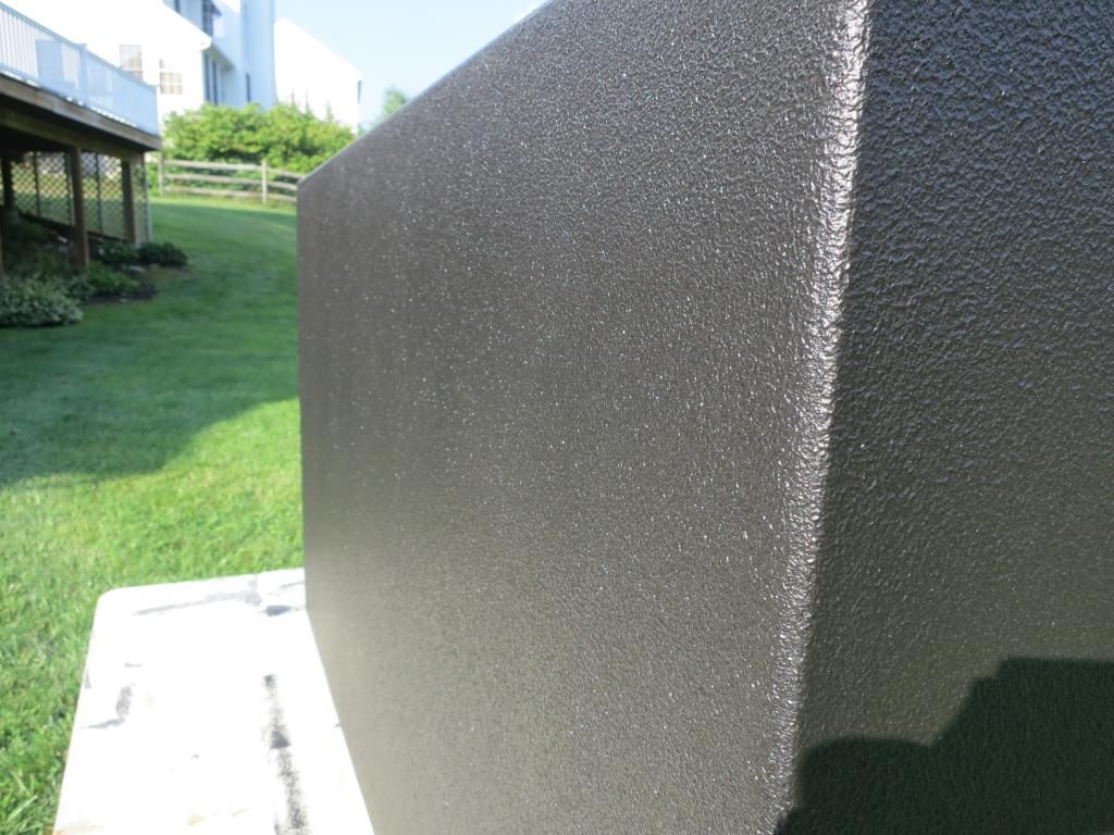

1) I designed/built a sub to be used in the rear of the room, behind the riser in a nearfield setup. This was more of an experiment, but turned out pretty well. These are 2 more SI 18 D4s. (for a total of 10 in the room right now) It's powered by one channel of a newly added Inuke 6000DSP and EQ'd currently by my minidsp.
Some pics of design, build, and install:
Gorilla83 is online now

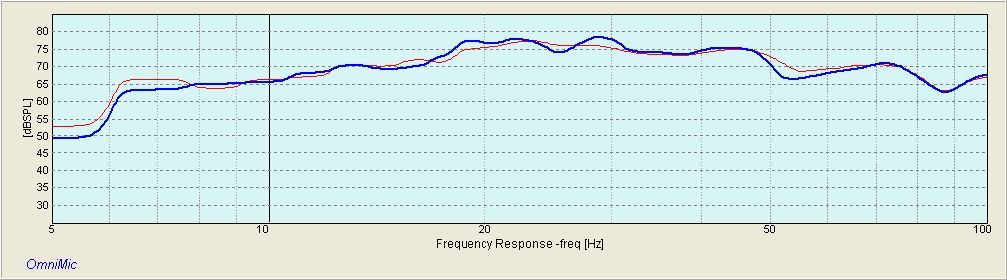

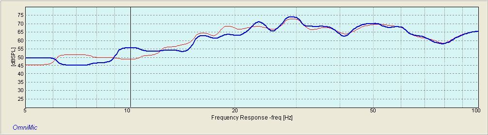

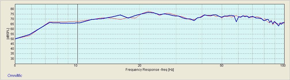

Some quick/dirty sweeps before EQ/distance settings/phase:
Rear subs only:
Front subs only
All subs
All subs after distances set and 4DB shelf applied at 20hz - NO smoothing used

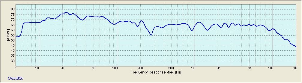

Full range sweep, back row (used to have big nulls before all treatments) 1/24 smoothing
No smoothing?! That's just nuts. Very impressive Andrew.

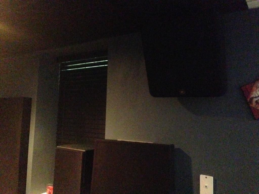

Thanks Jim! I hadn't spent any time on 'real' EQ just yet - that is just a small shelf on the back end, but no cuts or other boosts. The back row really smoothed out a lot after this last round of treatments.

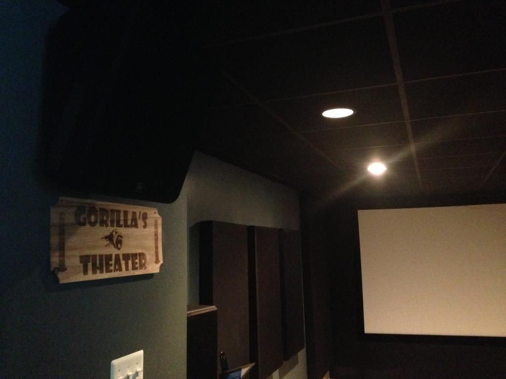

Also - Got a chance to swap out my klipsch surrounds with a pair of JBL Pro Cinema 8340s and the JBL mounts. I really like them so far with the 20 minutes of demo time.

Man.
You have come a long way from this:

Man, that is incredible! Great meshing with the mains even without EQ! Is all the measured at the second row?
beastaudio is offline

That is without EQ? Da fuk? Nice work.

What are the setting for the low end shelf? Was that to extend sub 20 Hz with the Amp? I have the same amp and would like to do the same.
Excellent job btw.
