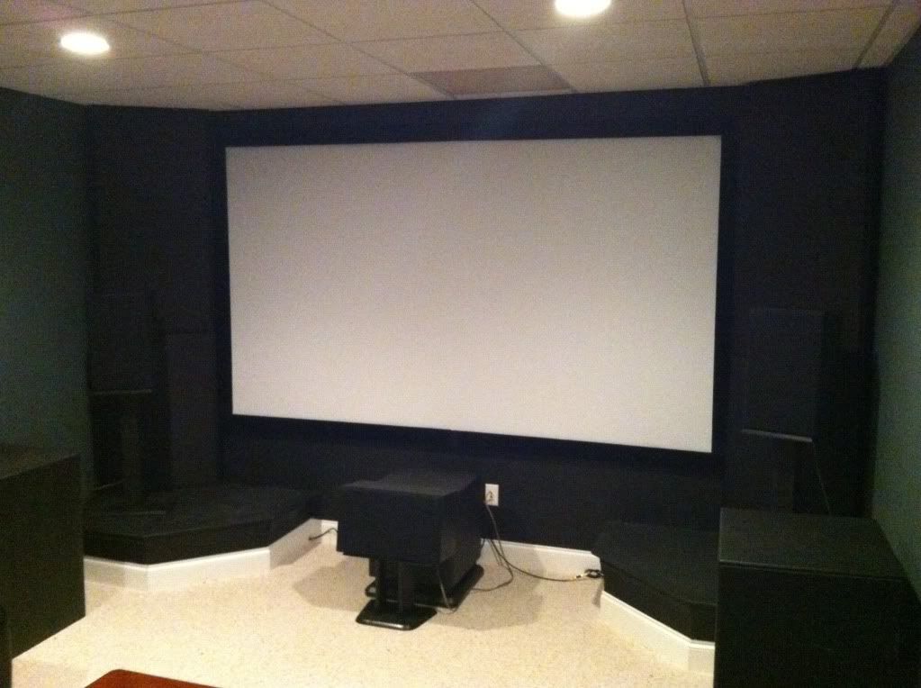

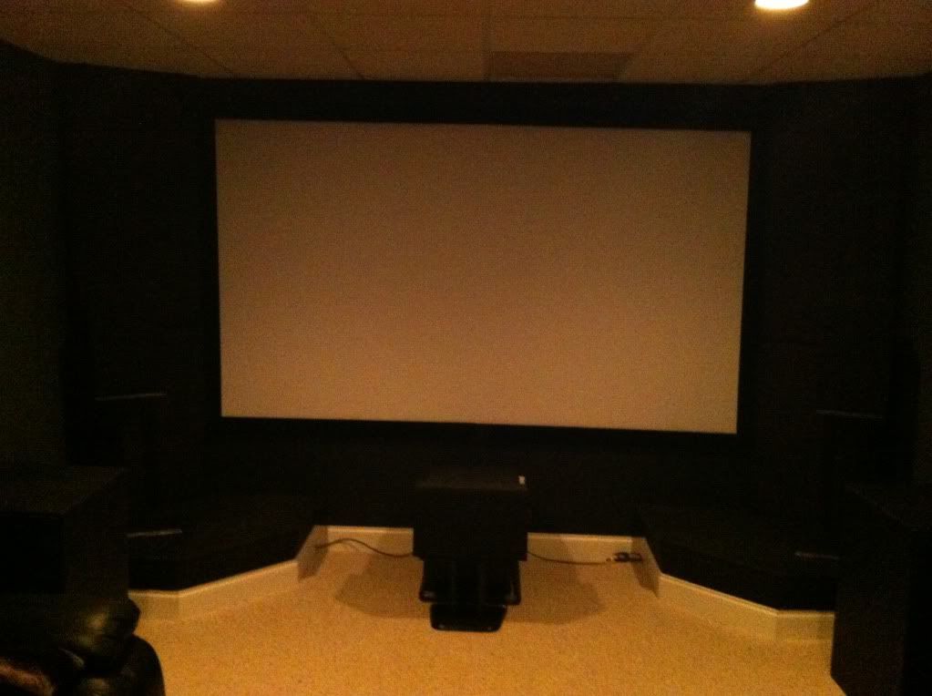

Now that I've finally gotten most of this room roughed out, I figured it was time to post some pictures and some basic info. As my wife can attest, this room is a constantly evolving projecting - the setup is subject to change at any given day, haha. This is the 3rd listening/media room in my house and the most recent. There are 5 total rooms in my house with audio/video setups in the house ranging from the garage to this room, but this is my favorite so far. I'll post up some info on the other rooms sometime soon.
The room before - light yellow paint, shelving in the corners, Mitsu 65" DLP, basic Polk Monitor 70 setup, HK receiver, etc.
Setup as of today:
A few months ago the wife and I decided we wanted to change to a projector. At first, this was going to be a simple ceiling mounted install that would be a directly replacement for the DLP you see above. The project evolved into removing the shelves, restructuring the corner frame/drywall, paint (entire basement!), new dedicated 20A lines for the equipment, remote triggered relays, moving furniture, new decorations, etc. I'm sure MANY of you can relate!
Notes: While I'd like to do something with the ceiling, converting to black is likely not practical since this is a multi purpose room.
Viewing area: (open) 13x22
Bar area: 19x22
Hallway: 5x20
2 other rooms are in the basement comprised of a a gym/play area and a workroom
Electronics:
Receiver - Denon 4311ci
Media - Oppo 93, Sony PS3, Roku 3 HD, Xbox 360, Verizon FIOS HD DVR
Power - Panamax 4400 20A Conditioner/Surge protection X 2
Projector - Sony VPL-HW55ES
Screen - DIY AT screen using Seymour XD fabric, 130" in 16:9
Sub Amps - Peavey IPR7500 x 2, Inuke 6000DSP x 1, driven by remote triggered relays in utility room.
Mains amp: Sherbourn A7-350 7 channel
EQ - MiniDSP 10x10
Speakers:
Mains - Yorkville U215B
Center - Yorkvillle U215B
Surrounds - JBL 8340A
Subwoofers - 4 x Dual opposed Stereo Integriy D4 18's up front, 2 x SI18 D4's in rear/nearfield (10 total SI 18" drivers)

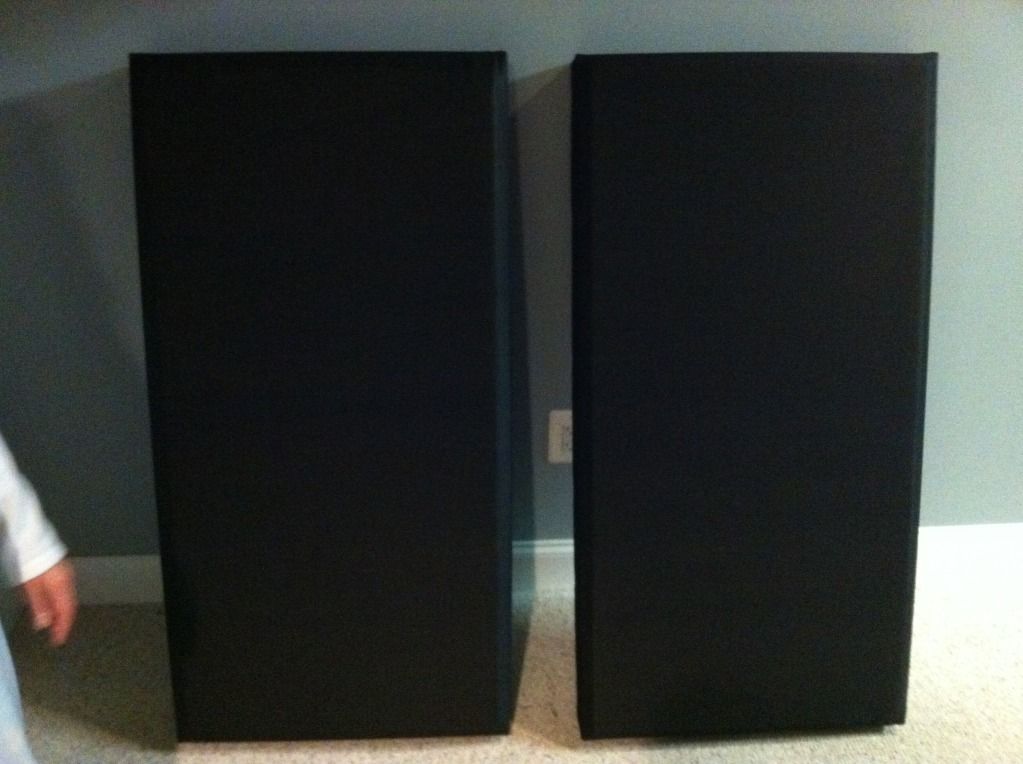

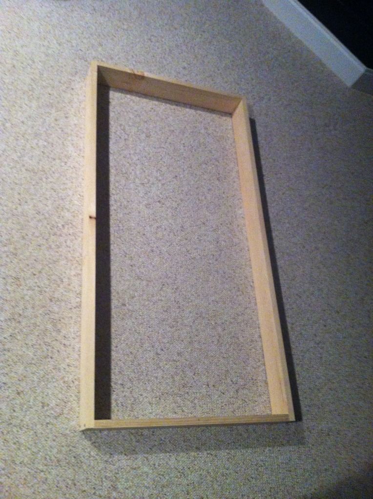

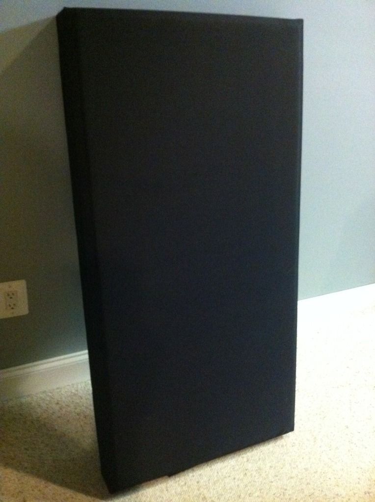

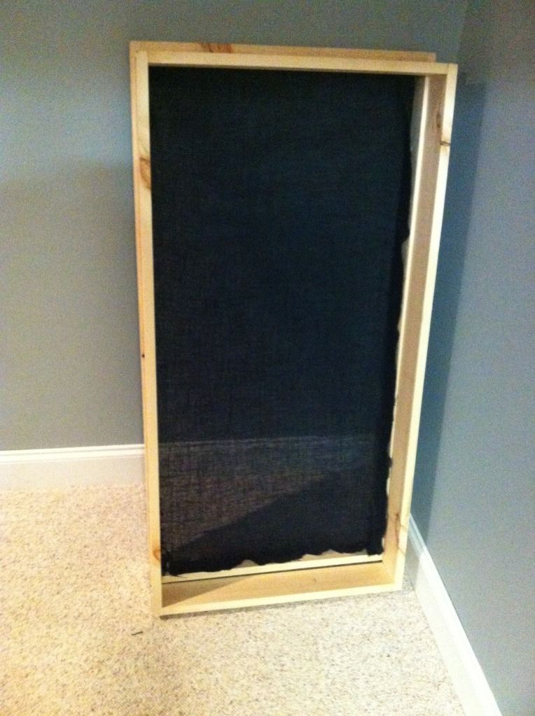

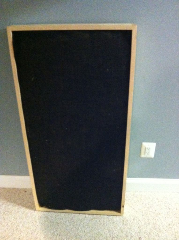

Room Treatments - DIY

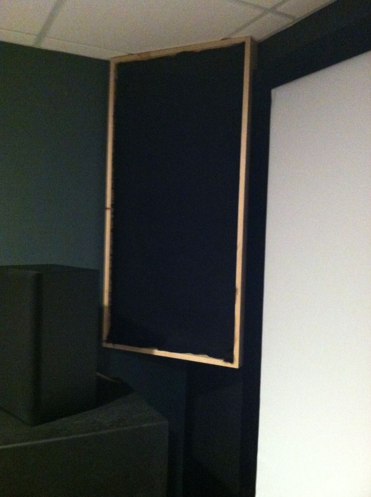

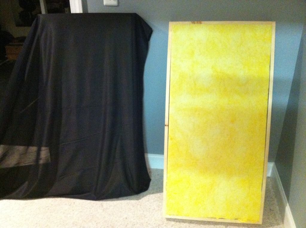

All treatments 4" thick 3# rigid fiberboard with 1x4 frame and covered with black speaker cloth. Most are 2x4' in size.
Front wall floor to ceiling coverage 4" thick semi-rigid fiberglass
3 X rear corner bass traps (floor to ceiling)
7 X side wall traps
Ceiling - 1 foot thick R38 above tiles over entire ceiling, Certainteed Theater Black F ceiling tiles
Other:
Custom Riser 9'3" wide x 6'6" deep, 10" tall
Custom Equipment cabinets x 2
Omnimount Projector Mount
Dayton Omnimic V2
Euroboom Mic Stand - for room sweeps
Logitech Harmony 880 Remote
Monoprice 12gauge oxygen free speaker cable (all)
Monoprice Coaxial cables
Monoprice Wall plates, assorted
Gym area
Hafler DH-200 Power amp and matching pre-amp
Bose 301 speakers
Energy 10" Subwoofer
Pictures from 2012 when the room was set up
Corner 'shelves' removed and bases cut down and reframed:
Wall sealed and primered
Room after paint - Sherwin williams Flat black and Harbor Grey Sides

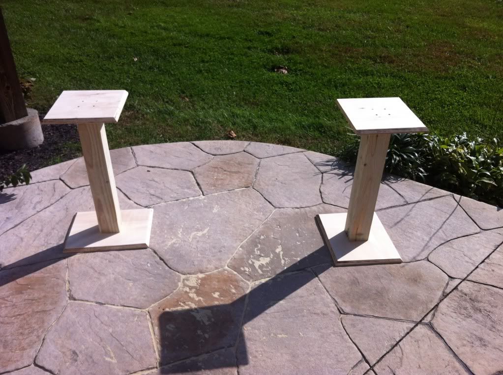

Corner area made into custom speaker stands, flat black
Screen assembly
Projector hung, near flush mount
Custom wallplate behind rack
Screen hung on the wall
Main view of the room
Bar area leading into theater
Screen
Equipment rack
Back hallway
Gym area

Updates! I've begun building the frames for my bass traps/panels. The first areas to be treated with the front corners and first reflection points. I'm supposed to receive my OC703 board sometime this week, so I should have at least a few of them up and running this weekend!
Frames built and burlap backing applied:
Mount installed and test fit in the corner:

OK - Got a bit done last night! My fiberboard got delivered and went to work. 2 traps done, 2-4 more coming up this weekend. smile.gif Figured I would share, here is the progress:
Details:
1x4 pine board for frame, 1.5" drywall screws
Black burlap backing for rear of trap. This was 2.99/yard locally at JoAnn fabrics and was something like 32" wide.
Johns Mansville 814 2" Board x 2 per trap. Pretty much identical to OC703. I actually ordered OC703 but they wound up giving me this stuff. After some research I found it actually has slightly better absorbtion coefficients across the board vs. OC703. It comes in a 9 pack of 2x4x2" panels instead of the normal 12/pack in the OC703.
Black speaker grill fabric from JoAnn fabric - I liked the look/feel of this a LOT better than the burlap. It was 8.99/yard locally at JoAnn fabircs. It was much wider than the burlap at 60" wide so I got a lot more out of it per yard. It took less than 1 yard per trap to cover the front/sides. It also masks the yellow insulation much better too.
1 trap stuffed with 4" of board:
Back side of stuffed trap - burlap backing:
First (prototype) completed trap:
Special thanks to my wife who helped me get them wrapped. I did warn her that this is only the beginning, LOL.
Tada - two completed traps!

Ok, UPDATE. Put in a ton of work this weekend around the house and of course including the basement. I really need to take some better pictures other than my camera phone, ugh. Sorry for the crappy pics below. tongue.gif
Key basement accomplishments:
1) Built speaker stands for SHO-10s:
Picture before they were stained black -
2) Reinstalled top trim for L/R speaker stands and painted them black.
3) Cleaned up terminals/wiring under each speaker stand. Moved Caps down from the stands for now. Did some quick sweeps with the Caps in front of the stands and the FR is tremendously improved. They will be staying there from now on.
4) Started playing with/breaking in the PSA XS15 in time for next weekend's GTG.
5) Constructed a total of (8) frames for bass traps. I completed all 4 front corner traps with insulation and wrap. I did run out of the speaker cloth material so I couldn't fully complete the others, but I'm getting more on Wednesday. cool.gif
Frames for rear corner:
Front of the room - please don't mind the wiring exposed for now - it will not be staying there. eek.gif I think the traps blend in rather well though.
Gorilla83 is offline
