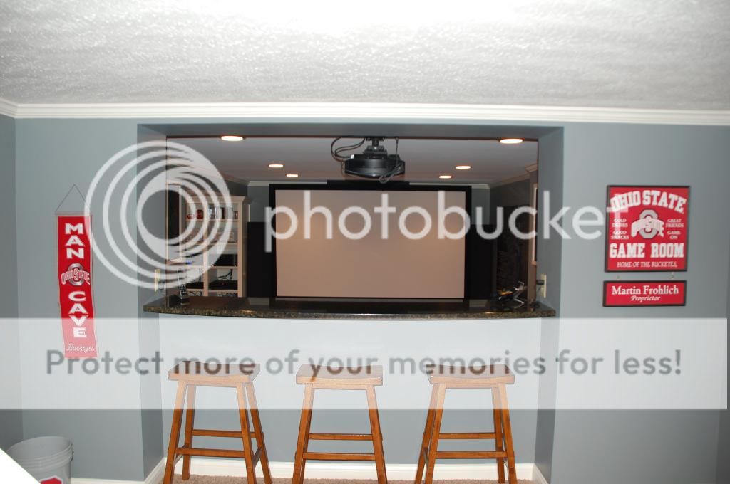

Here are some updated pics:

post #249 of 269 Old 03-21-2016, 10:56 AM
DekPM19's Avatar
Join Date: Mar 2005
Location: Pooler, Ga
Posts: 862
Quoted: 116 Post(s)
Liked: 37
Looks good I like the look of the ati amp with the heavy duty handles on the front.
Allen
DekPM19 is offline

Your front wall pics is one of my fav in all of AVSLand. Symmetry, Clean and BIG. Good stuff.
