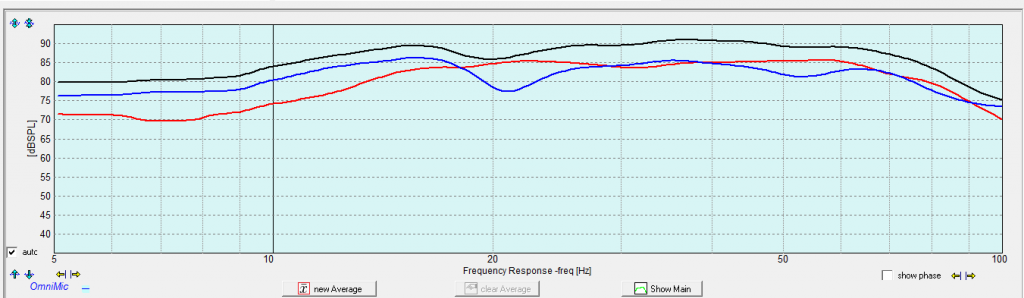

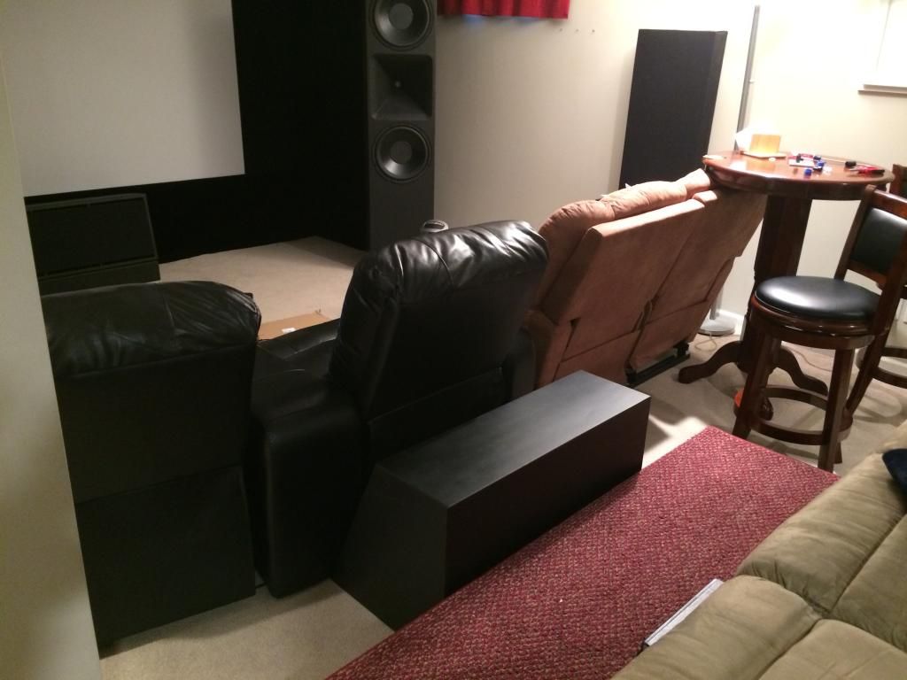

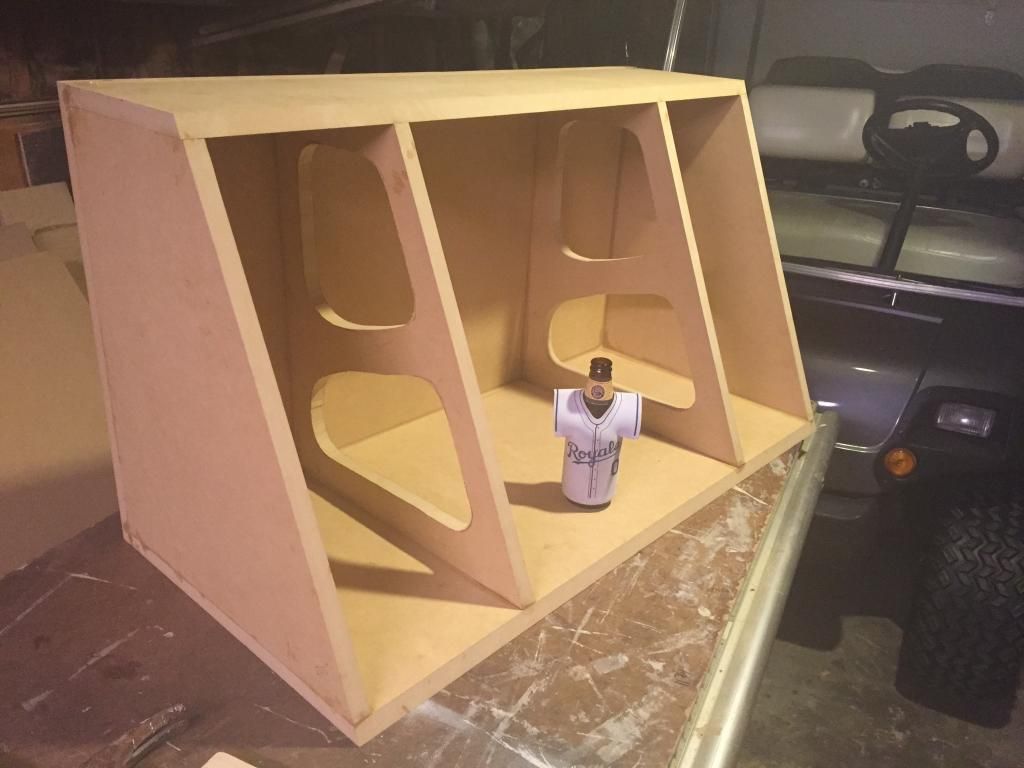

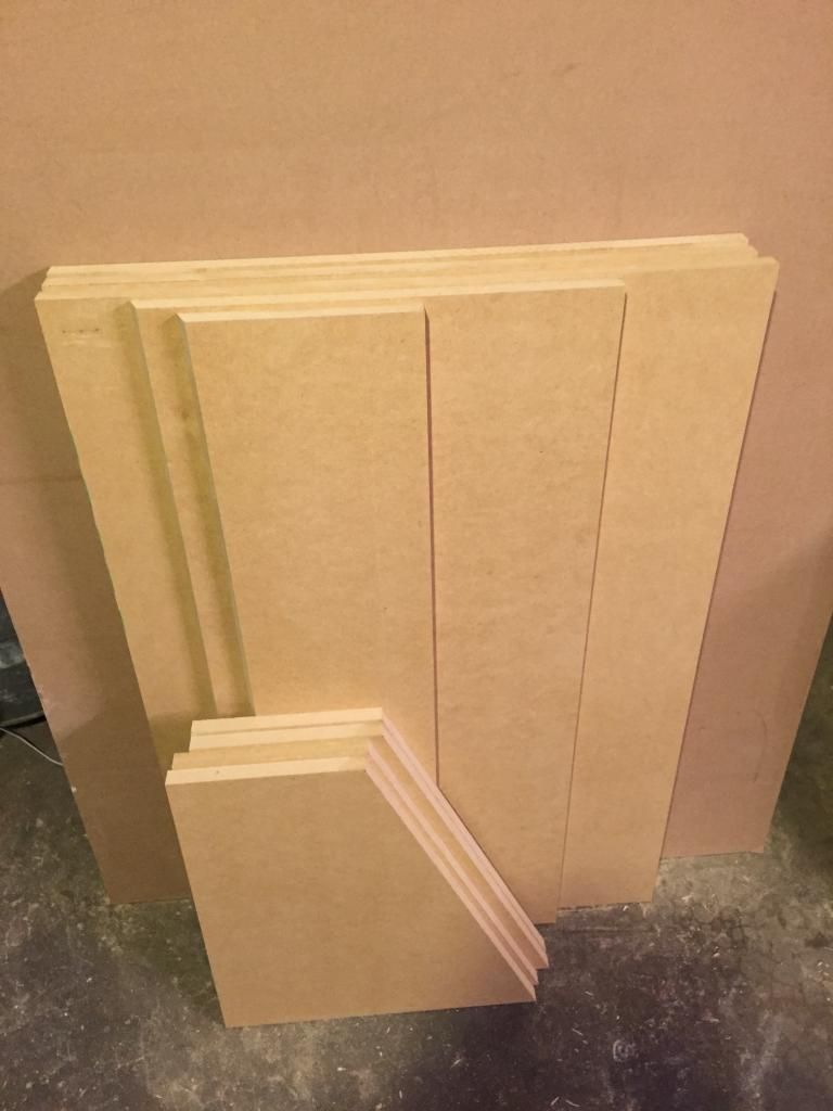

post #134 of 1475 Old 12-24-2014, 10:23 AM - Thread Starter
carp's Avatar
Join Date: Aug 2003
Posts: 8,849
Mentioned: 460 Post(s)
Tagged: 2 Thread(s)
Quoted: 2613 Post(s)
Liked: 1880

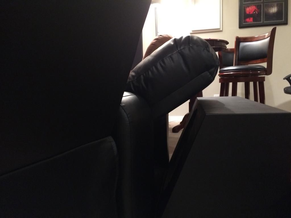

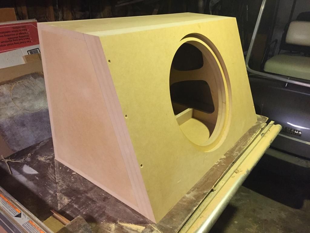

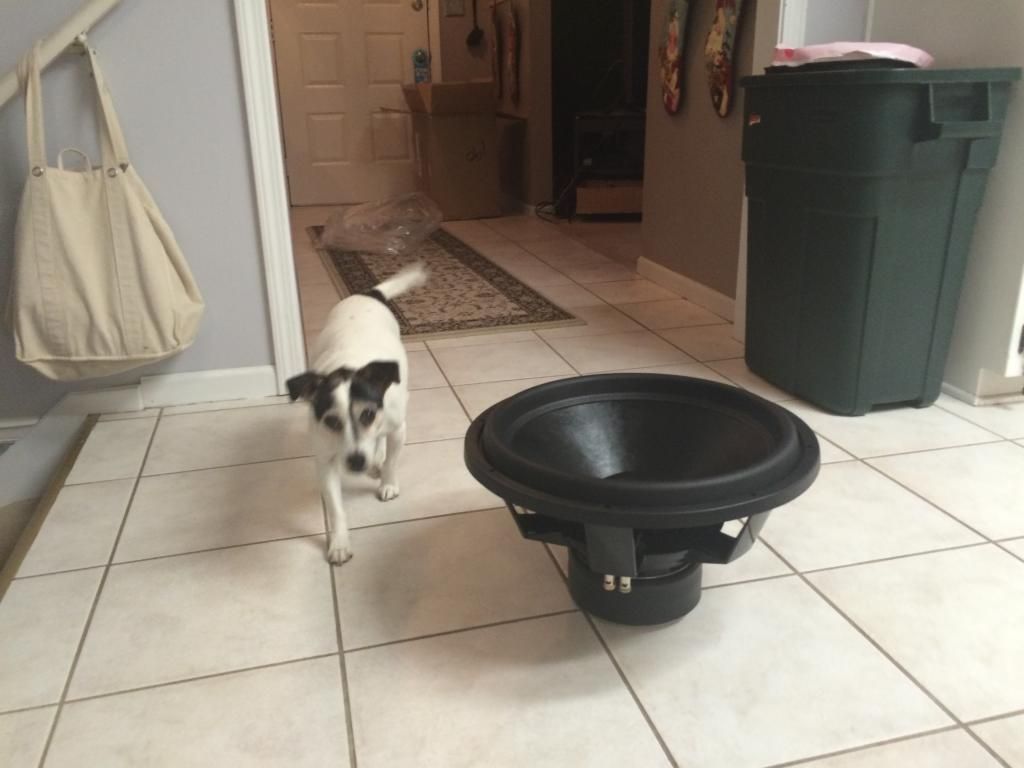

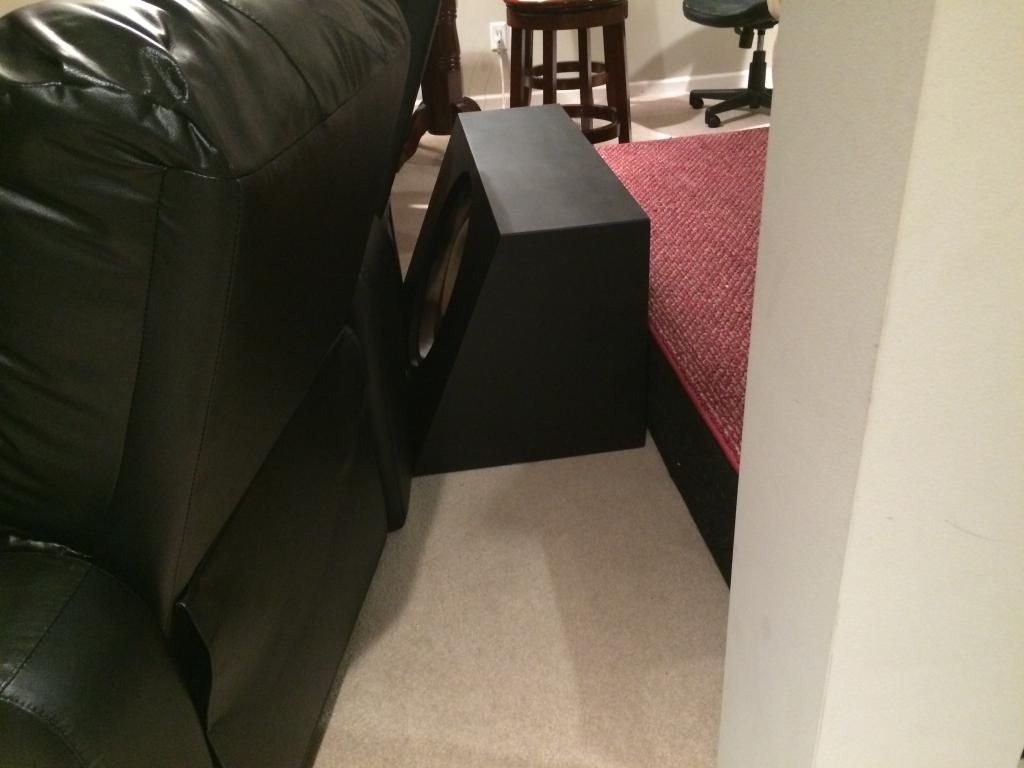

Decided to finally go nearfield. Huge thanks to Doug (d_c) for building me a box that will fit behind my seat and in front of the second row riser.
Doug sent me these pics yesterday:
I ordered a B stock SI 18 on Sunday, shipped from North Carolina on Monday, and it got here today (Wednesday).
I got a D2 so I can use a spare channel from an Inuke 3000 which will give it roughly 600 watts. I know the driver can take a lot more, but all my upfront drivers are getting 625 each so this should be plenty since the sub will be so close to me. I thought about using the Dayton Ultimax driver or maybe even a UXL or something else - but - when it's 149 including shipping for the driver, and I already have an amp for it since it's so efficient it's a no-brainer. I should have done this (errr I mean asked Doug) a long time ago!

post #138 of 1475 Old 12-25-2014, 04:20 PM - Thread Starter
carp's Avatar
Join Date: Aug 2003
Posts: 8,849
Tagged: 2 Thread(s)
Liked: 1880
Originally Posted by Pain Infliction View Post
Nice! No need to spend the extra money on the UXL since this is nearfield. Enjoy!
What are the box dimensions?
Thanks! It's pretty thin since it has to fit. It's 11 inches deep on the top, 19 inches deep on the bottom, 20 inches tall, and 36 inches wide.
carp is offline

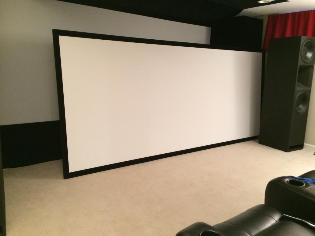

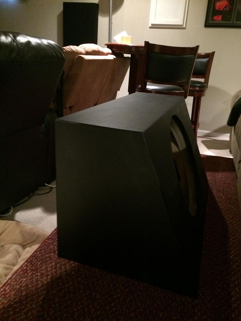

post #143 of 1475 Old 12-31-2014, 03:04 PM - Thread Starter
carp's Avatar
Join Date: Aug 2003
Posts: 8,849
Tagged: 2 Thread(s)
Liked: 1880

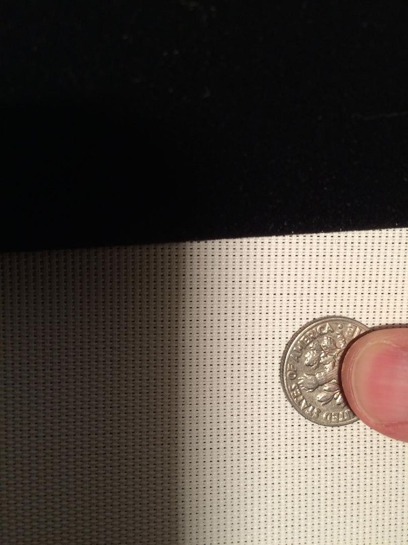

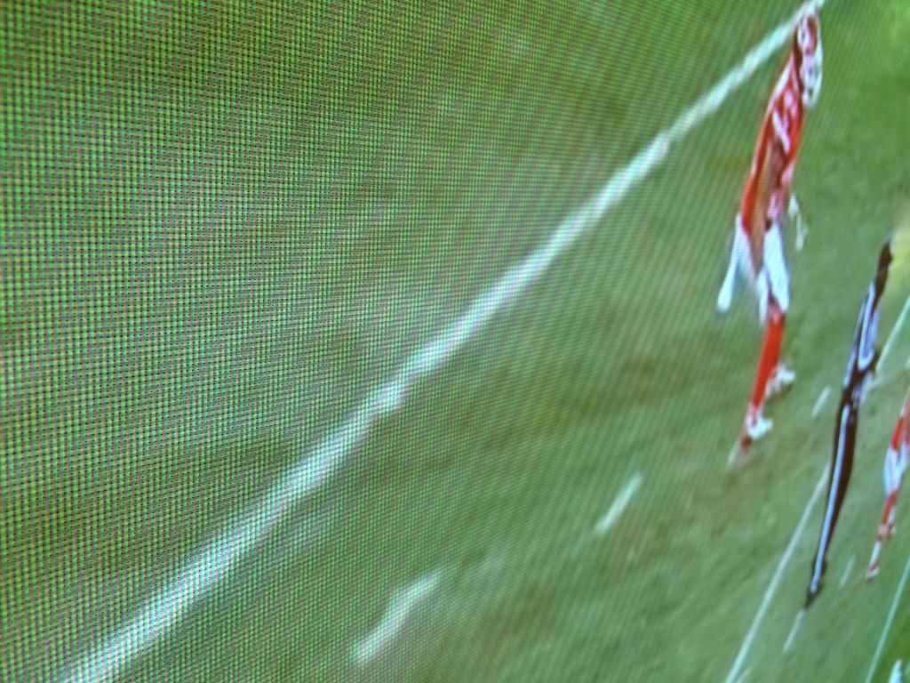

A couple of new additions. Neither has worked out yet, haha, just my luck.
First was the new AT screen from Elite that I bought off of Amazon.
Same exact size as my current screen, 158 inches diagonal.
Too bad it looks terrible:

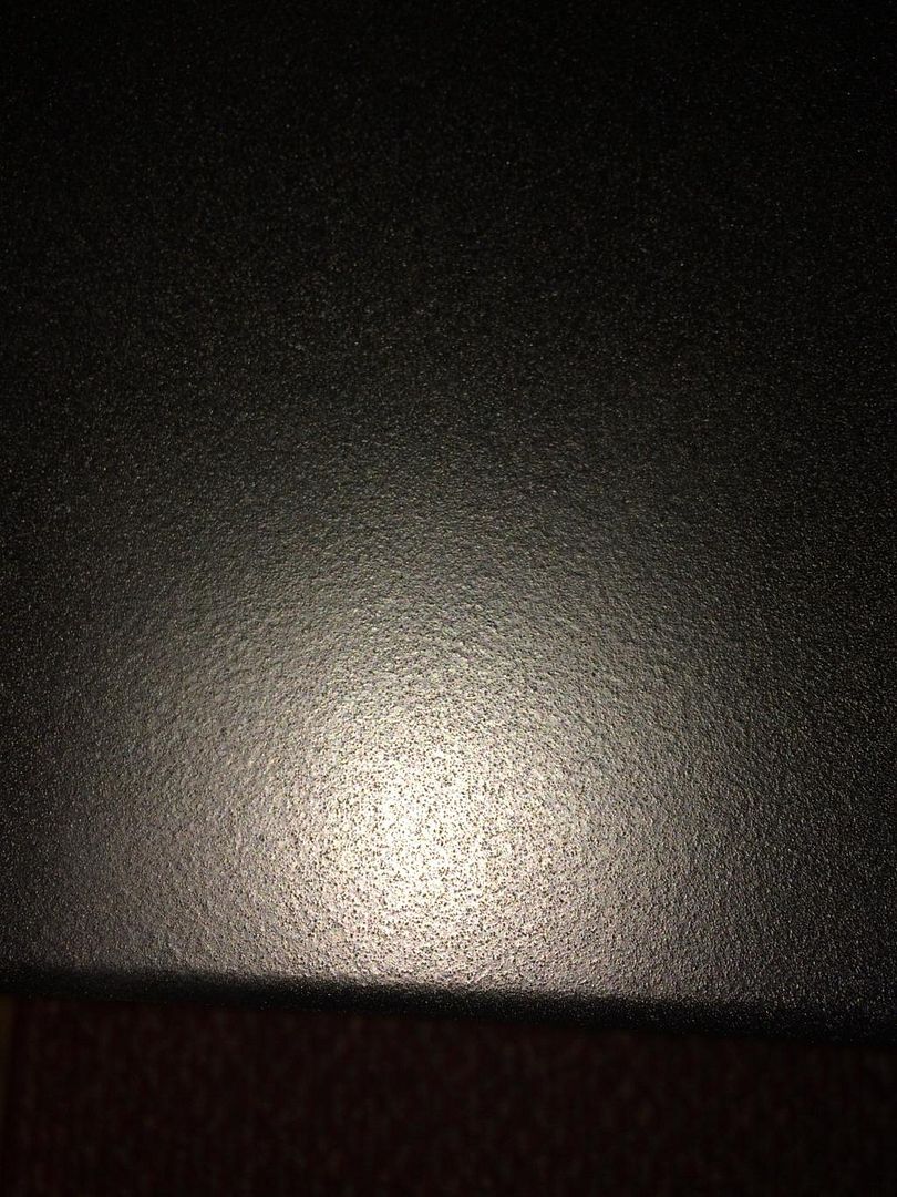

So, with advice from Steven @Scrappydue who went through the exact same think I called Elite and they told me they will replace it if I send in all the proof of purchase and pics that show the issues. The guy told me the screen may not have been designed to work with a projector that puts out pixels as small as mine. Hmmmm it's supposed to be a 1080p screen, says so right in the title.
Whatever, Scrappy loves his replacement AT material so I'm hoping I will too. Asim (asoof1) has the same material as I do but his screen looks awesome, he sent me a bunch of close up pics that look fantastic.

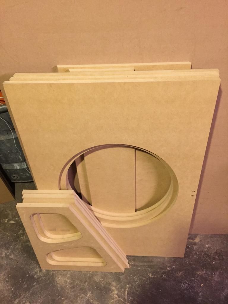

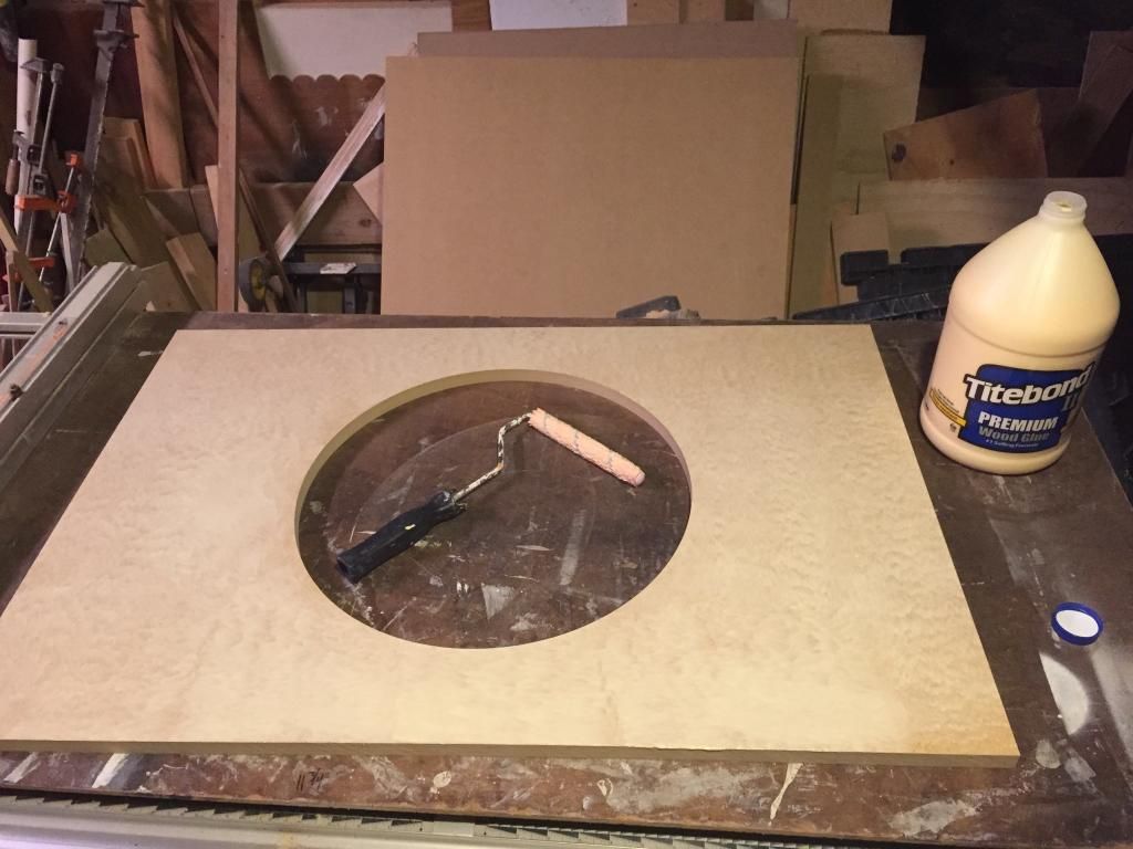

Here are more pics of my nearfield sub that Doug built.
I couldn't get Duratex because they won't ship it when it gets below freezing because it ruins it so Doug suggested I use Rustoleum truck bed liner. Good call!!
Fully reclined, no issues with hitting the box or driver.
The driver isn't in yet because I hate speakons. Yes, that's right. I hate them and they know I hate them which is why they screwed me over today.
We used a 2 pole female speakon and I'll I have is 4 pole male connectors. Little did I know that you can put a 2 pole into a 4 pole but not the other way around. Da*n you speakons with your stripping of the little screws, screws that just keep turning but don't tighten because the threads are jacked up, that little part that holds the wires in place and is nearly impossible to cram back into place before twisting the speakon back together - and now this. I told you Jonathan. @Archaea Speakons suck. Let me tell you how many times I have had a speaker wire come loose from a normal speaker terminal connection - zero.
Ok, end rant, just want to hear this bad boy right behind me!!

Can't say enough about what a great job Doug did, I told him that his corners and edges lined up better than my flat packs did and it's the truth!!

Where is all this screen talk and pics posted? I wanted to see what others are posting.
stitch1 is offline
post #147 of 1475 Old 01-01-2015, 09:20 AM - Thread Starter
carp's Avatar
Join Date: Aug 2003
Posts: 8,849
Tagged: 2 Thread(s)
Liked: 1880
Here is some posts by Asim, he is what got me thinking to try the Elite screen:
Official JTR speaker thread
The other shots I was talking about were what he texted to me I can sent them to you.

That finish looks great on your new sub. So only one seat gets the special nearfield treatment? That sub is going to be pounding on you! Hahaha love it!
Sucks about the sreen. I don't fully understand why they are going to send you another screen. Shouldn't that screen already be the correct one?? Why are there two different kinds?
Thanks - haha, yeah it's the selfish nearfield treatment for sure!
As far as the screen goes I really don't get it. At first I thought that Elite is just trying to sell as many of the lower level screens as they can knowing some will return them since that's what happened to Scrappy due (Steven) and me, but asoof1 (Asim) got the same material as I did and he sent me a bunch of close up screen shots and his looks great so I have no idea what to think...

Digging the near field thing that's for sure! Very impressive both for music and movies. With just the one driver I really can't tell it's behind me, even well above 80hz. If I move my head over a couple feet it's obvious but if I stay dead center I can run it up to 150hz and it's not localizable at all. Currently I have it crossed at 80 with a 6 db boost at 70hz for a nice kick drum punch feel. Who knows how I'll end up running it, right now it's just fun to experiment.
I did hear a very quick "pop" during a bassy movie scene, not sure what it was. No way I could bottom the sub with 1 channel from an inuke 3000 (600 or so watts since I have a D2 SI 18 so 4 ohm load on the inuke), so maybe it was a bad amp sound or a bad driver sound as a result of the amp clipping?
I had to pull down a huge hump from 35-65 hz for the nearfield sub, but here is what I ended up with.
Red = 8 subs up front
Blue = nearfield sub
Black = both combined, nearfield sub 8 ft. delay added on inuke
Love this stuff, looking forward to doing some measuring/experimenting tomorrow.
