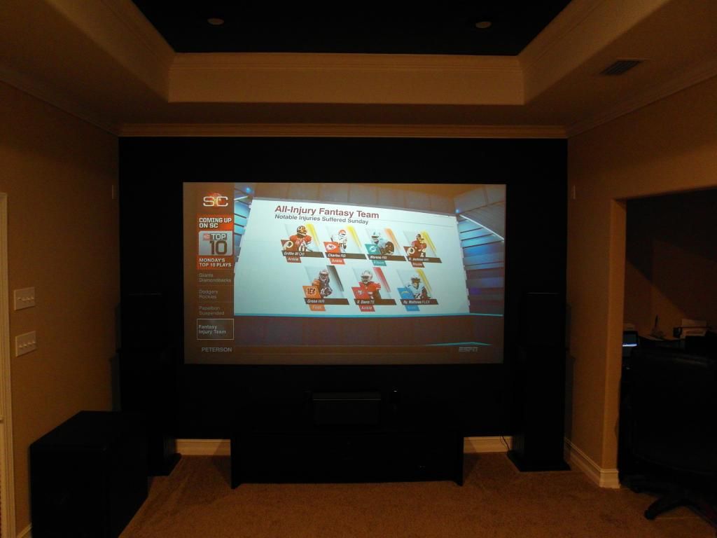

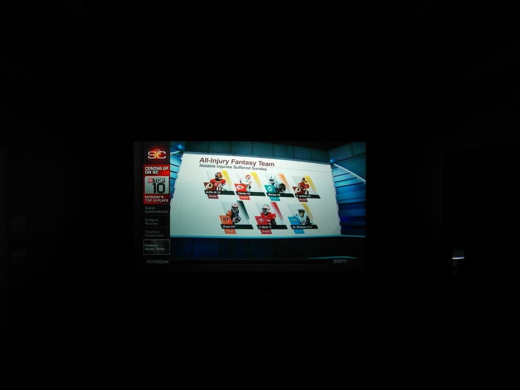

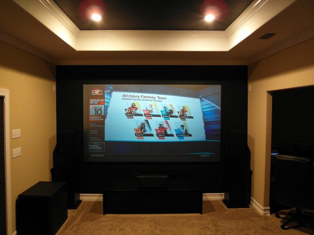

Bulb Hours & Software Version (9/16/2014):
All 4 Can Lights ON (Custom 2, High Lamp):
Front 2 Can Lights ON, Rear 2 Can Lights OFF (Custom 2, High Lamp):
Front 2 Can Lights OFF, Rear 2 Can Lights ON (Custom 2, High Lamp):
All Can Lights OFF (Custom 2, High Lamp):
