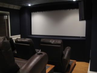

The celtic cloth has a long history on the forum of being used as an acoustically transparent projector screen. I tried doing a search to find that thread I mentioned earlier, but didn't have much luck. In that thread though, the person tested the audio capabilities of different materials used as AT projection screens (including dalite, vutec, celtic cloth, and screen research clearpix) and the celtic cloth had the least adverse affects on audio. Try doing a search for "celtic cloth" and you will find a lot of first hand accounts of people's experience with it. I am very happy using it as speaker cloth and find no issues with audio quality (I'm no audiophile, however).
bluesboyjr is offline
post #21 of 32 Old 05-13-2008, 04:44 PM
bluesboyjr's Avatar
Join Date: Oct 2004
Location: Hoosier
Posts: 245
Here is a pic of my theater with the celtic cloth in place.

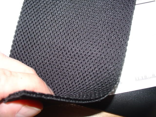

The samples of Dazian are on the way. I just received a sample from Fabric Mate for their AudioMesh line.
Check this out. Is the useable as speaker cloth? It says that its rated for seating and panels. I am not so sure if its good for speaker cloth. I can certainly breath through it but not as easy as the cloth sample from SpeakerWorks.
This material is pretty thick, spongy and the back is not as weaved as the front. Feels very durable.

Well, a lot of samples came and I got around to comparing them today.
In comparison of my samples from Fabric Mate, Dazian, Speaker Works and Parts Express. The PE material is very .... purple looking, not so "black".
s
The Fabric Mate material, while very cool look and feel, does not seem to be the best fit for my application. I want something more traditional.
Dazian Celtic Cloth, is very black. But it appears very solid compared to the Speaker Works material. As if it would affect acoustics somewhat. I put the cloth to my mouth and blew...lots of resistance.
The Speaker Works material matches in black with others except for PE (as this is..purple looking) and is not as transparent as the PE material but definetely appears to be ready to use for speakers.
Why hasnt anyone mentioned Speaker works? Its about 12.00 sq yd (67" wide by 36")

So many people have been perfectly happy using GOM for speaker covers that relatively little effort has gone into the search for a better alternative.
Not sure why McCall doesn't like it. I believe DE specs it in his HTs.
It's in mine.
post #30 of 32 Old 06-03-2008, 01:16 PM - Thread Starter
kezug's Avatar
Location: NW Indiana
Posts: 2,279
It's in mine.
Thanks, so does anyone have 3 yards (67-70" wide x 36") of Black GOM that they are willing to sell?
