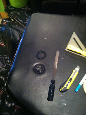

Well since it's the last day of 2012, I wanted to finish this project tongue.gif
Yes, I got the part 11 1/2 months ago, and stuck it in a corner and just finished it today.
Made a template for location:
I did not have a 1 3/4" boring bit, so used a 1 1/2" boring bit and a file, switch fits fine

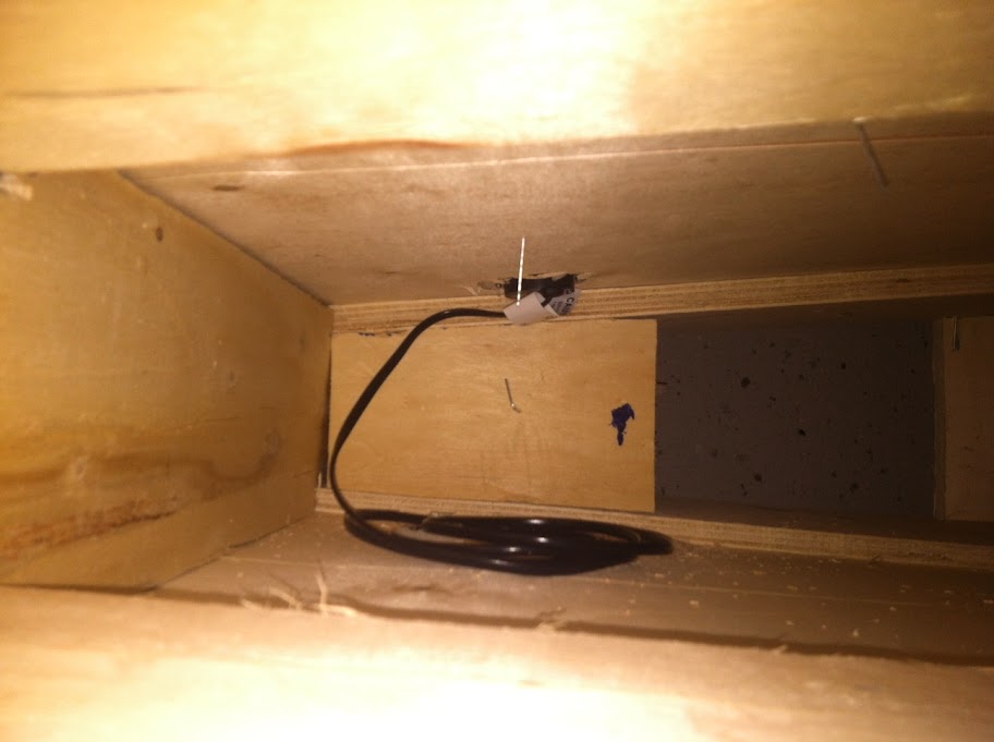

Here is inside of the arm to show nothing to worry about
Use 4 wood screws to hold it, put bezel on:
