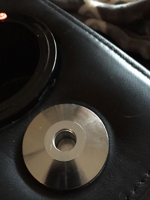

Roman,
I bought the 4 Fusions a year or so ago and have a minor issue on one. Where the tray tables connect to, the metal cover that appears to be spring loaded is not coming back up. We tried to push down a little bit to see if we could get it to spring back up but it's not budging. Do you have any idea how we can fix this?

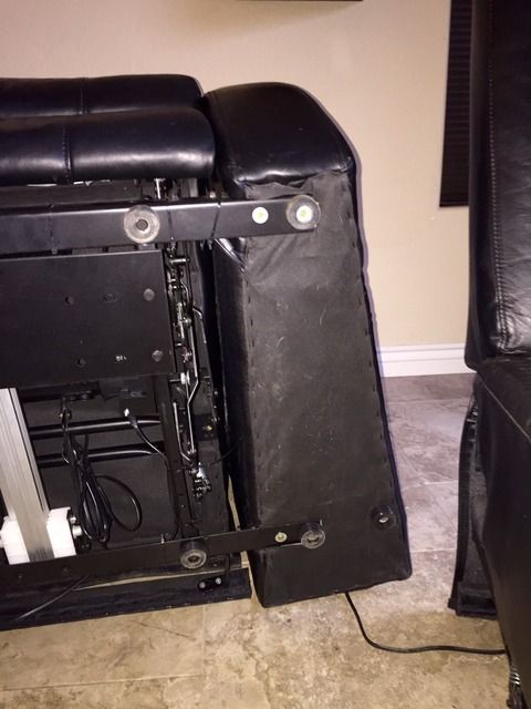

I would disassemble the spindle to see why the pin is not moving. For that you would need to reach from the bottom of the chair arm and loosen the nut that holds the spindle in place. Unscrew the spindle cup and take the pin and the spring out. See if something got inside and prevents the pin from moving up.
See attached pictures that may make it clear how the spindle is assembled.

Roman,
I'm guessing this material needs to be pulled off in order to gain access to the bolt underneath? Or is there another way I'm not seeing?

Yes, it does, unless you want to remove the cup holder, but I would recommend just removing some staples to get access to the inside of the arm.
