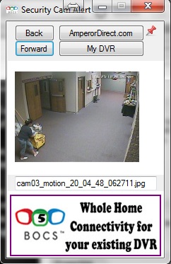

Howdy all:
I have a seemingly unrelated request for help:
Long story short, I've been helping another company develop a "Security Camera/DVR" business (Makes a good input for BOCS so it seemed like a good mutually beneficial effort), anyway, the issue with Security DVRs is that they are not great at alerting you when there is an alarm. Either people are not fully setting them up, or they just don't bother.
So, I've developed a nice little piece of software that interfaces with your home security DVR and will alert you by both Skype and Text message if and when you get an alert (motion detection or however you have your DVR set up).
So - if you:
1) Have a Home security DVR
2) Would like to be instantly notified of motion events by skype and text message

Howdy all:
Thanks for those of you who helped with the beta program - had great response from AVS followers.
We are now releasing Security-Cam-Link as a free software package to everyone. Thought I'd share a screenshot - and make sure everyone knows that the download is open.
This is a desktop application that links up with any Security DVR, allows it to find you via skype, and displays any camera activity (a picture each time there is motion) right on your desktop or phone. You can page back and forth through recent motion shots and all pictures are time/date coded.
Thanks again to all -
