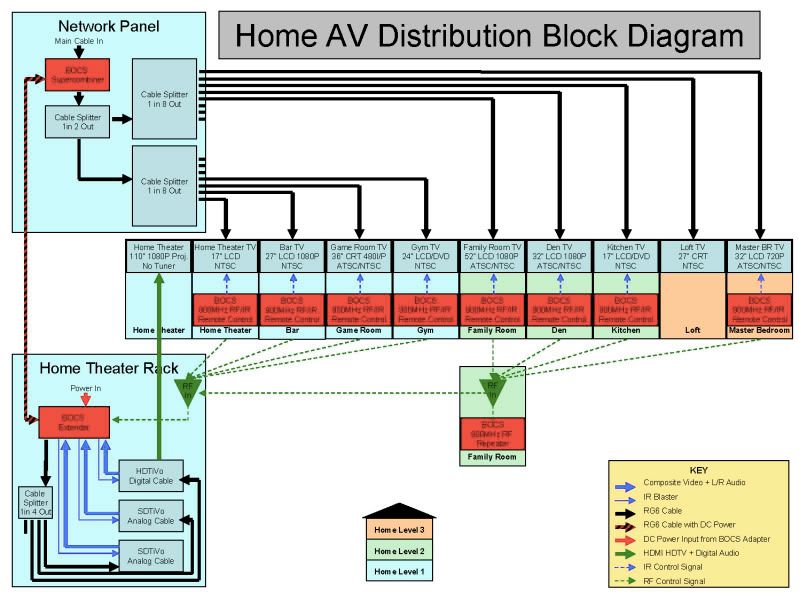

I am probably crazy, but I liked the idea of this product so much that I had to take the risk and order the SD Media Xtender Product with a special deal from www.bocsyourway.com. I'll review the unit once I get it installed!
Now for my comments on the HD Xtender product...
1) They did a demo of the system at CES2009, so not entirely vaperware.
2) Looking at the CES photos, it looks like they will take Component Video In and use a hardware MPEG2 Encoder to reencode the video and audio and then modulate the signal onto RG6 Coax via QAM for distribution throughout the house. I don't think going from digital to analog and back to digital, sacrificing some video and audio quality in the process will be a Hollywood issue. Might be a consumer quality issue though???
3) This approach does trade off some quality. But this offers a lot of flexibility and cost savings. My wife has been bugging me to get another TiVO for the exercise room. I have been wanting to watch TiVO at my bar. With ~9 TV's in my house, it is cost prohibitive and would be extremely complex to have 9 TiVos. As it is, I have 2 Series2 and 1 HDTivo that is a significant investment. The current product will work for my SD content on all my TV Tuners. I'm hoping the HD product will integrate nicely with the SD product when it becomes available. This way, I can have 3 SD sources and 3 HD sources. Of my 9 TVs, 4 have integrated QAM Tuners today, 1 is early ATSC, but I'm not sure if it does QAM. The other 4 have NTSC tuners.
4) This HDXtender approach requires your HDTV to have a QAM tuner integrated or you will need a STB with one connected to your TV.
DLB
1) Great news!
2) Disappointing but understandable
3) Yes, this is a great option for all of my secondary viewing locations. Did they mention a MSRP yet?
4) Also, if you want external sound, your TV needs a digital audio output.
edpowers is offline

Originally Posted by edpowers View Post
1) Great news!
3) I heard about $1000 for the base system once it becomes available. I did not hear when it will become available.
4) True, or Analog Audio out, or an external QAM tuner with audio out, but this defeats the purpose of this system somewhat.

Originally Posted by AceCannon View Post
Perhaps I am being overly simplistic. But could you not use a cheap/used Extron matrix switch to distribute your 3 sources in component video format to all the TV's in any combination you choose? This would support HD and SD video formats. Distribution could be via coax x 3 runs per location or a single cat5e run per location via baluns.
As someone else suggested, it just depends on what wiring/cabling is already in your house. I ran typically one cat5 and one RG6 to each room when I bulit my house. The exceptions are my family room, game room, and home theater, where I have more.
I came across the HDR44 from ATON, which utilizes 2 CAT5 cables per zone and can push 4 HD inputs to 4 HDTVs for less than $1000. I may consider this for the future still.
I also came across a single HD input to single HD output solution using 1 CAT5+1RG6 for about $300 each, which I could maybe use in conjunction with a component matrix to put a solution together.
The probelm with the last 2 solutions is a whole lot of extra work for me to install and the risk that it won't work well despit the sizeable investment. Somebody will solve this problem for us on the HD side eventually. Hopefully it will be BOCS, and soon!
David Baldwin is offline

I'm one of the founders of BOCS - thought I'd answer a couple of questions and also ask some advice from the experts on this forum.
As concisely as possible...
1) Current SD product is mass production - we found a way to hijack the FM band that most cable companies avoid to circulate three new channels around the home - Remotes are 900Mhz VERY long range and control connected devices via IR bugs provided. (Secret friends and fmaily order site is BOCSyourway for "wholesale pricing")
2) HD product is up and running - we demonstrated it at CES - basically a "modular approach" adding an HD modulator on top of the current distribution and control system. It is not readily available today as it will take us some time to get from "trade show demo" to a productized version. Frankly, we are in the middle of a fundraising round to complete that task but are targeting July for a release at this point... Anyone ever around Boulder, I'd be happy to give you a demo.
I'd definitely be interested in your collective opinion on HD features...
We currently avoid HDMI due to various compatability issues and have settled on Component - but...
What would you consider critical optical inputs?
How many HD inputs would be optimum for a consumer setup?
How pervasive in your home setups is QAM? (Alternative is ATSC)
I'd bet everyone on this forum gets the idea of the product - so what other features might you consider cool for this kind of product?
I'd appreciate any insight anyone can provide - and I'll make sure to post beta tester offers here as well..
David Feller
dfeller@bocsco.com
David, First, Welcome to AVSForum! There is an incredible collection of AV Experts that participate on this forum. Alan Gouger and team that run AVScience do a great job!
I received my BOCS SD Extender order on Wednesday, March 11th!!! I'm in the process of getting it installed. I will write a detailed review here when I finish the installation.
In the interum, I can say that I am impressed with the quality and performance of the product so far!
Your probably wondering why it is taking me so long to install such a simple product. Well, I ran into some issues with my cable distribution infrastructure that took a while to troubleshoot. After finding and replacing a bad cable, a bad connector and bypassing my existing cable amplifier, I was able to see how well your product can distribute composite video over cable. I'm impressed!
I will be placing another order for additional remotes in the next few days.
I love that the HD Extender modules will add onto the existing SD System allowing me to leverage my initial investment. I understand that the HD extender is Component video based, and will still transmit over the standard cable infrastructure.
What is the audio interface? Optical and/or Coax audio would be great as most HD sources also have a digital audio output. How many HD channels is the system capable of having. I understand that up to 6 SD inputs are supported with 2 SD Extender Boxes. What is the possible mix of HD and SD channels? I would consider 3 HD + 3 SD channels to be sufficient for the near future, but the flexibility to do more is always better.
I have 1 HDTivo and 2 SDTivos today.
I will likely add some PC based channel for Video, Music, and Photos.
I may look add interfacing with my Honeywell home security system at some point. There is probably some nice integration that is possible between your system and home security systems and home automation systems too!
I understand that up to 12 remotes are natively supported. This should be sufficient for me. I currently have 9 TVs and 1 1080P projector in my rougly 4200 finished square feet. Only 3 or 4 of my TVs have HD Tuners today. I also have an HTPC with 2 HD Tuners that are ATSC and QAM.
How is the HD Video decoded? Do I need a ATSC/QAM decoder for my 1080P projector?
Macros on the remotes would be nice, especially a power on/off sequence.
Backlit remotes would be nice, especially for my home theater, which is pitch black.
An INPUT button on the remote would have been nice, but with the included ability to program buttons, I may do this.
Compatibility with one or more of the popular and more powerful RF remotes would be interesting. Logitech?
I'll have to look at the remote code list again, but the ability control the PS3 would be nice (XBOX360, etc) given their added media capabilities.
If you want a beta tester for the HD units, I volunteer!
Dave

BOCS Extender Review by David Baldwin
About the author: I consider myself to be a home theater enthusiast. I have loved to tinker with electronics and computers as long as I can remember. This interest led me to pursue a degree in electrical engineering and a career with a leading semiconductor manufacturer. I am tolerated by my lovely wife, son, and daughter. I also enjoy offroading, golf, and most sports.
When I began looking for a whole home audio and video distribution system, I had a few key objectives in mind.
The first objective was to be able to watch Tivo’d shows in our exercise room. My wife and I are pretty busy between our careers and our kids activities and don’t get as much time as we would like to watch TV. Up until now, we only had basic cable available there. It seemed as if there was never anything on worth watching when we made some time to exercise, but we had loads of shows on the Tivo’s that we never got around to watching and couldn’t watch in the gym.
The next objective was to simplify our system to make it easier for everyone to use. This included grandparents, babysitters, even our housekeeper. Nearly every TV in the house had a different remote control and miscellaneous complexities that caused nearly everyone to have some problems, or create some new problems for me to figure out. Can you spell time sync?
The third major objective was to add functionality without increasing and if possible to decrease our associated monthly costs. The thought of adding a 4th Tivo in the exercise room was troubling me. On top of that, I really had no convenient place to put the box in our exercise room, which led to a side effect of the BOCS system that my wife is thrilled about. More on that later…
The final major objective was to choose a system that would allow for a reasonable level of expansion including HD (High Definition) distribution at some point in the future. Assuming that most or all AV (Audio/Video) sources will transition to HD in the future, I wanted a system that would support both SD (Standard Definition) and HD sources.
As you undoubtedly deduced from the title, I at least tried on the Extender SD product from BOCS, a company based in Boulder, Colorado. www.bocsco.com Read on to see how the system held up to my evaluation…
BOCS has agreements in place with a large network of regional and internet electronics resellers and is rapidly expanding. I’m more technical than most, so I opted for purchasing over the internet and installing the system on my own to save some money. If you prefer to have someone else install the product for you, contact your local Home Theater Installer and ask for quote.
BOCS is currently offering an Introductory Starter Kit on their web-site for just $299 and includes the main extender box, along with a special cable combiner (opposite of a splitter), a Remote that is both IR and RF capable, and a comprehensive wiring pack that even includes a tool to trace your existing cable wires back to you central cable splitter. This is a great deal, because the suggested retail price for the kit is $499 and competitors’ products are less integrated, therefore more complex, and also more expensive.
This basic kit provides everything you need to distribute up to three audio and or video sources throughout your entire home via your existing cable system. This system also continues to distribute your existing cable television signals throughout the house. You only need to add additional remotes at TV locations were you want to control the remote AV sources. The remotes have a suggested resale price of $49, but I found them from major internet resellers for less. They even make an RF extender product that will increase the range of your remotes in larger homes.
Executive review for those not interested in all the “Techy Details”:
We are having a great experience with this product in our home. The product works as advertised. The product is well documented on BOCS’ website. The sales and support staff is knowledgeable and very helpful. Order placement was relatively straightforward. My order did have a minor delay, but BOCS made up for it by paying the shipping costs and throwing in a free remote! Who does that anymore???
I was impressed with the packaging of the product. It was double boxed with plenty of bubble wrap, peanuts, and foam and even had all edges of the outer carton well taped. The quick installation documentation was printed clearly on nice glossy paper and the full manual is included on a CD-ROM, which should save a few trees. The product itself was impressively constructed. It has a solid metal case, with rubber feet, and quality connectors and cables. The remote is impressive, with logical button layout and well placed impressions in the back so that it doesn’t slip out of your hand.
The installation procedures were well documented and it was relatively straightforward for me to install. If you don’t feel comfortable changing a few connections at your main cable splitter, connecting cable boxes and such, or programming universal remotes, you should probably call BOCS or your local AV Installer before making the purchase.
The product operation really blows me away. The picture and sound quality is very clear throughout my entire home. It is very easy to use and will be in my home for a long time to come!
BOCS demonstrated their HD expanders to this system at the 2009 Consumer Electronics Show. This unit will be an add-on module to enable a HD input that accepts component video that most HD sources have outputs for. BOCS is currently working on their plans to release the HD expander product later this year. I’ll be among the first in line to upgrade my system!!!
This system will succeed in meeting all of my major objectives when the HD expander is released and works to my satisfaction!!!
Read on for all the “Techy Details”:
I don’t have anything else to add in regards to the order placement and packaging other than some photos.
The installation turned out to be a little more difficult than I originally anticipated, but not because of the BOCS system, but rather I had two bad RG6 coax cables/connectors and an issue with my current cable distribution amplifier not working in conjunction with the included BOCS Supercombiner. The crazy combination of these multiple issues led me through a confusing debug path into the wee hours of the morning.
After running in circles for a while, I finally set up a 17” LCD TV, a single cable box, and the extender product right next to my distribution panel. I quickly discovered and replaced the bad cable and then through further analysis bypassed my existing cable distribution amp and found that the Supercombiner’s integrated amplifier actually performed better and was able to drive all of my TV outputs very well. One final problem made it easy to identify a bad RG6 F-connector that I promptly replaced.
With everything working at the distribution panel, it was time to go back to the family room, where my HDTivo and 52”LCD are located. After cranking up the amplifier gain with a few button presses on the remote, and programming the remote for my equipment, everything was working great except that I couldn’t get the Live TV button to work with my HDTivo. After trying all of the different Tivo codes and having the same issue for every one of them, I was getting ready to contact BOCS, when I came across the ability to learn A/V source codes into the extender. With just a few button presses, I taught the extender the LiveTV code from my Tivo remote and all was fixed!!! I am really impressed with the remote and the extender’s control flexibility.
With this setup working, I pulled my wife’s SDTivo (Series2) out of the master bedroom (without her knowing) and set it up in the family room. I programmed a second remote in the master bedroom to work with the 32” LCD TV. I had to program the Live TV code into the extender again for the second input. I ran into an issue trying to run the RF output from the first Tivo into the RF input of the second Tivo as it shows on the instructions. I tried to use the local TV output to the second Tivo, but that didn’t work either. I ended up using a standard cable splitter to drive the RF input on each Tivo from the STB Out connector on the extender and then everything began working great.
OK, now I was feeling really impressed with the functionality and the picture quality and was ready to move the whole setup down to my Home Theater equipment rack and add the third Tivo, also a Series 2 SD Tivo, from my Game Room as my 3rd AV input. This was graduation for the BOCS Extender product as far as I was concerned. I wasn’t about to reorganize and rewire my entire AV Rack unless I knew this system was a keeper!
I connected everything up the same as I had done with the first 2 Tivos upstairs. I programmed the LiveTV button again into the extender. I used a larger splitter to handle the 3rd Tivo box as I did when adding the second box. Everything just worked, until…
Ladies and gentlemen, if something is going to go wrong, it’s going to be when your skeptical wife is asking you to show her how to watch her favorite show in the Master Bedroom before she goes to bed. When I moved the components from the Family Room down another level to the Home Theater and placed it in a rack full of equipment on the complete opposite corner of my 4200square foot home, the remote control operation from the Master Bedroom became intermittent. My wife stopped short of demanding that “her” Tivo be immediately returned to its original location.
After reassuring my wife that this problem was easily resolved, I quickly placed an order for an RF Repeater along several more remotes to complete my SD installation. The repeater was easily added to the system and resolved the control issue from the Master Bedroom. See the diagram below for my complete system block diagram.
Additional Notes:
This system would make it really easy to integrate a Windows Media Center computer in a SD resolution mode using a video card with composite video out today and should support HD video when the HD expander becomes available with a video card supporting component video output.
This system would also make it very easy to add CCTV (Closed Circuit Television) system (Video Security). Someone rings the doorbell and you hit one button on the remote from any TV and you are instantly looking at the CCTV video feed.
There are some other great Ideas on the BOCS website including integration of video and music from a Sony 400 Disc DVD/CD changer or even an Apple IPOD.
You should even be able to distribute Blu-Ray via Component Video output when the new HD expander becomes available. I have a Sony Playstation 3 with an IR Remote add-on and look forward to experimenting with its ability to serve media over BOCS.
Based on a recommendation from BOCS’ website, with three Tivo’s in my home, I assigned a Tivo to my wife, one to my kids, and the final Tivo to myself. This will make it even easier for the family to manage and watch our favorite content from anywhere in the house without conflicts.
