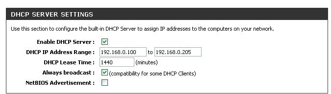

My dlink DHCP gives out IP range 0.100 to 0.205
seems I may have a bigger issue. Over at DSL reports they are saying that the bridge won't work through the Time Warner Amp that they installed to boost my through put. I may need to resort to plan B Powerline Ethernet unless I can figure out a way around all these issues.
zetachi is offline
Yes, that address range is for DHCP - you are assigning a static IP address, NOT a DHCP address, so you want it below 100.

OK so I'm at wits end here. I consider myself pretty good with computers but this is kicking my butt.
I'm gonna post my trials and tribulations one more time then these are going to be up for sale and it's off to powerline ethernet
Time warner cable, D-link DGl-4300 wirless router subnet is 192.168.0 2x actiontec MI424 one rev c and one with no rev but older.
setup as in diagram
I've gone through the setup numerous times and have yet to be successful.
Usually once I configure and complete the reboot I can no longer log into the router. If I pull the cat5 and reconnect sometime it logs in but then loses it again. I even configured the 2 routers via direct coax and no luck.
I do get internet if i plug 1 router into my dlink and connect the pc to it so that seems to work but can't get the 2 to make a bridge with the coax.
Any suggestions, tricks long shots I'll take any advice to try as I would really like to work.
Update. I changed IP on at router to 192.168.0 subnet and can now log in after reboot. I can ping local network as well as outside but can't get FF or IE to connect to any web page while bridged to my router.
ping to internet address gets all packets sent and rec'd but message destination net unreachable?
I think you are getting closer though it might not seem like it. I am confused though, so can you answer this?
If you connect your PC to your router, can you get to the Actiontec connected via CAT5? Via coax?
If you connect your PC to the Actiontec connected via CAT5, can you get to your router and the Actiontec connected via coax?
If you connect your PC to the Actiontec connected via coax, can you get to your Actiontec connected via CAT5? Can you get to your router?
When you are moving the cable around, are you using a command line like 'ipconfig /renew' to make sure Windows is aware of the change in connection before firing up FF/IE?
