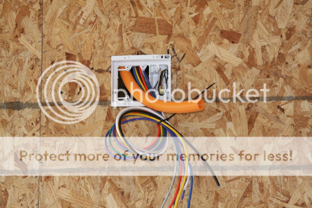

What great progress! Nice job on the color-coding.
The LV cables near the front of the boxes makes me nervous about the drywallers rotozipping your cables.
Will the spray foam cause trouble for the backless LV add-on rings?
These pictures are from February, drywall and texture is done (waiting on the cabinet guy to finish before they can start paint). I was really nervous about that as well but my builder assured me that it wouldnt be a problem. I havent seen any damage to any of my cabling post-drywall.
Thats another picture we didnt take. After all the cabling runs were complete we went around to all the boxes that would get foamed and taped the backs of the boxes closed with duct tape. I had originally wanted to use backboxxes, but finding them in small quantities was impossible. Plus, the manufacturer said he didnt think the boxes would stand up to the foam expansion anyway. We wound up with a few boxes getting some foam penetration but my builder used open cell, so its pretty easy to carve out.

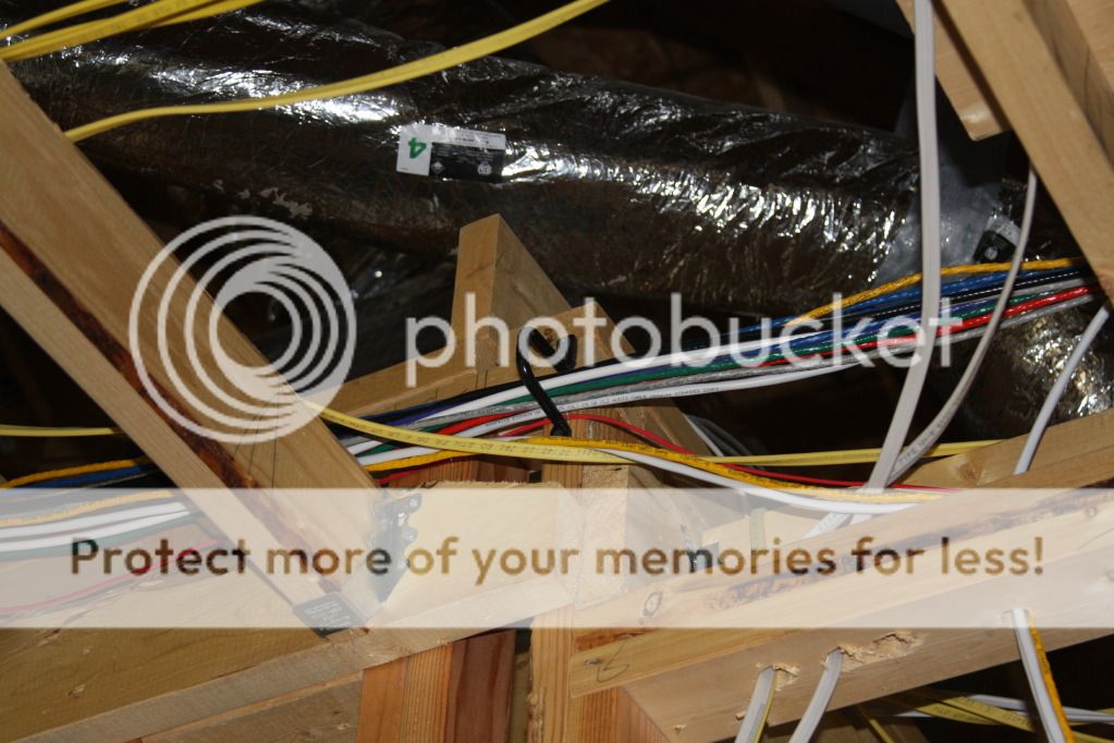

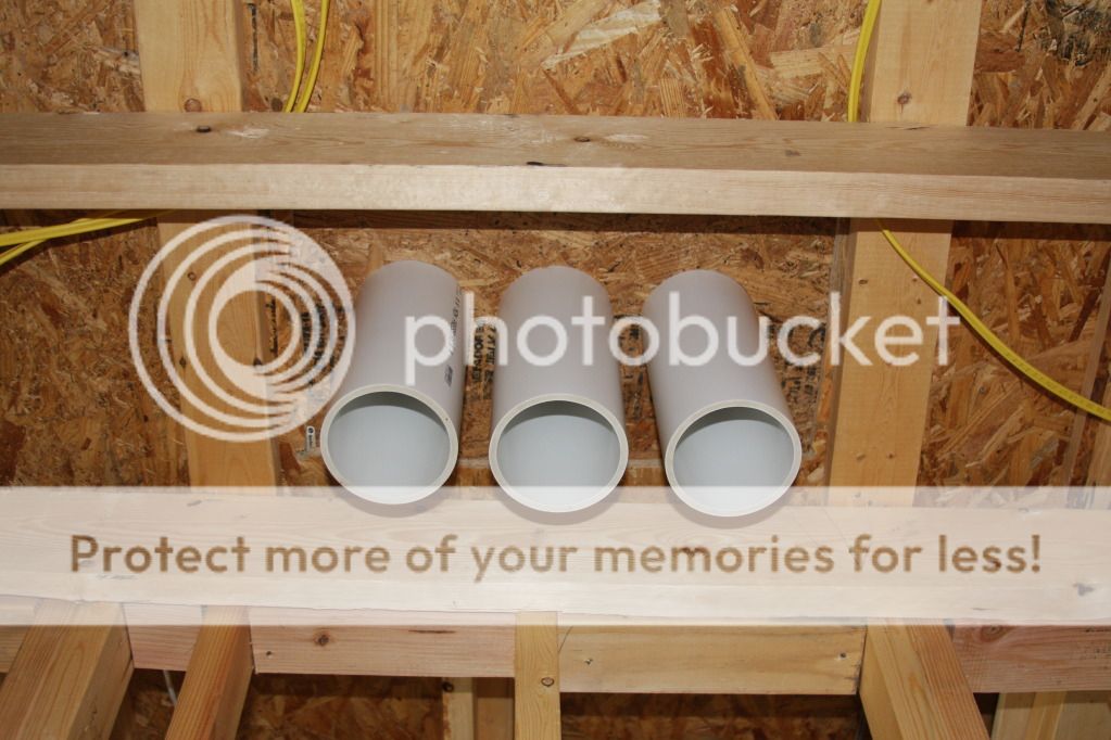

So a few more pictures I forgot to post last night.
This is a speaker drop. I used this product and was happy with the majority of locations I used it. It gives the drywall guys something to cut around so you can find your drop and allows you to go in after the fact and cut whatever hole you need, you arent tied to a specific speaker mud ring. The piece is designed to push away from the hole to make your cut and then break away so you can pull the wire out the hole. There are pictures on the product link that explains this process better.

This is one of the chases in the attic space. I used non-conductive D-rings to keep things organized and to maintain some spacing away from the romex running all over. Ill try to get a picture of the decked attic space to show how I was able to keep things tucked to the sides and maintain substantial space up there for storage. Those D-rings were also great to "lubricate" the cable pulling. I put them at every turn so the cables were rubbing the D-ring, not any wood and it worked out great.
After the pre-wire was done we pulled all of it into the attic space. This is the conduit plate I built that we will feed the cabling back through after the interior is painted. That space between the studs the conduit is coming through was the area I cut out to pull. After the pull was done I built a plate to cover that hole and hold the conduit. That is 4 inch conduit and I glued a coupler to the tops of each to keep them from falling thorugh the hole. Simple and solid. I know those look long now but after drywall there is only about 4 inches of excess.
