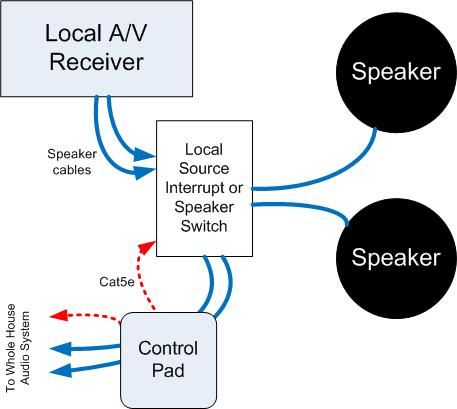

You should be pre-wiring the house for "whole house audio" distribution, and then adding some cabling/links on top of that scheme to allow for a basic AVR-based setup like I described above. But you absolutely want to get the wiring in place, especially for speakers and keypads, to enable you to "grow into" a whole house setup.
Which means home-run speaker wire, looped through keypad/volume control locations in each zone, and a cat5e wire in parallel to the keypad. (We really should make a sticky with this info - I've typed that sentence too many times)
Then you'll want to add some additional speaker wire from the areas where you may have an AVR that will feed its "2nd zone". So an additional speaker run (4-conductor) from the central closet to each of the MBR and the Family room. That will allow you to feed speakers from those locations (the AVR) to any other speaker(s) in the house, by connecting the lines back in the central closet.
The reason to do that is that now, if you add a whole house audio system, you've got all the wiring back at the central closet done correctly.
Also, you can use an "local source interrupt" device to share speakers (like in-ceiling surrounds) between a whole house (party music) system and an AVR's surround use.

Whole house systems can be implemented with fixed output multi-channel amps, and the zones trimmed with volume controls, or it can be a "system" with a variable-volume output and a "keypad" control device in the zone. The wiring scheme I described allows for either type of system to be used, which is why it is recommended.
Hmm...local source interrupt. Is that like a source selector?
Not a source selector - sources are selected by the system. LSI is the best term available, although it goes by a number of names - NuVo uses the LSI term for the device to allow one set of speakers to be shared by both a "local" AVR and whole house system.
Wonder if I can find a similar diagram around the forums...
I'll save 'ya the googling...

You've been a tremendous help, Jeff! I just want to say I appreciate your willingness to help and your knowledge of the subject.
That diagram helps clear things up! I believe I'm starting to understand my options. I also feel I may be over thinking this. I can only imagine how complicated it can get if you're putting audio in 8-10 rooms!! I'll be leaving work shortly and Ill have time to do some research and collect my thoughts when I get home. Seems it wont be difficult to setup, but it crept up on me! I'll probably be running wire this weekend.

Really, it's the transition from 2 or 3 zones to >3 where most of the complexity occurs. Adding the 8th or 10th zone is just a matter of money...
Edit: The house isn't extremely large. Its a 3/2, ~1600 sqft. From your original reply, that sounds still to be the easiest.
Ah, ok, so with those 2+2 zones, you may be covered. I'd still recommend home running all the speaker wire to a central place (along with cat5e's for control), but that central place can be your family room AVR location, as that could easily be the location for a small whole-house setup in the future, and simplifies your immediate wiring needs.
