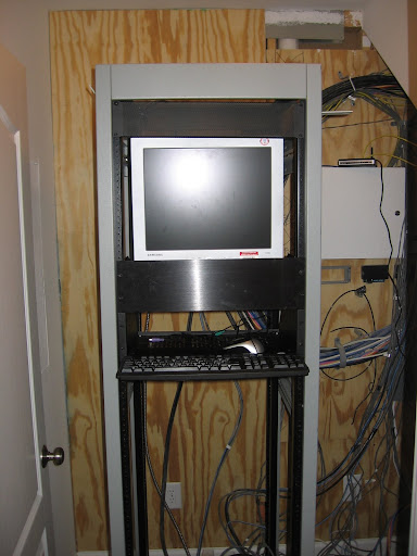

All video/audio,computer, etc. equipment will be in a 6 foot rack.
Other items will be mounted on the plywood wall.
So lets just say I pulled ALOT of cable.
I won't be able to buy everything at once, but I have the wiring in place for when I make the purchases :-)
Here is a pic of the equipment room (and cable pull) where the brains of the house will be. Excuse the mess... I have not trimmed the wire yet.

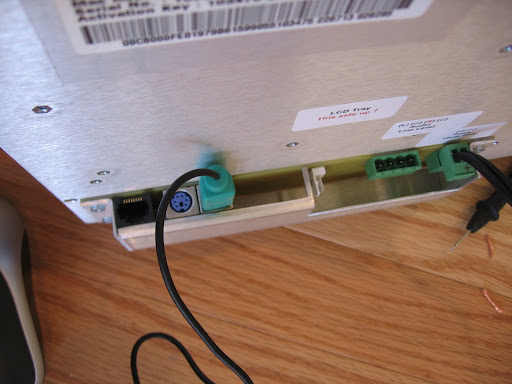

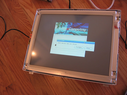

Turned on one of the touchscreens for testing... here are the pics.
I checked with my multimeter and I have no voltage drop over the length of in-wall wire...so I ended up connecting the stock power supply in the equipment room...leaving me with a flush mount!

I was impressed w/ the build quality of the touchscreen units. Also Dwayne with Touchtronix seems to be a nice guy. He hangs out at http://www.cocoontech.com and Touchtronix also has started their own forum. Those would be a good place to look for deals if they come up.
As far as the wireless tablet... I have not looked in to models yet... but I do plan to get one. I will also be using an old second hand PDA hooked up to WIFI.

Well, I did a little bit more today. I put a couple of shelves in the rack...and made a keyboard shelf (I will put in an actual sliding one later). I'm still waiting on my Dell server (running Ncomputing server and MainLobby Server/Client) to arrive. I will install the linux media server shortly.
On the touchscreen side... I bought a a Square-D pull out disconnect switch at Home Depot and gutted the enclosure. I mounted the 2 stock touchscreen power supplies on one of the TouchTronix provided mounting plates. The plate is the perfect size for this box. I can slide the plate in behind a couple of dimples on the sides of the enclosure and it fits snugly inside.

Well... My automation server arrived from the Dell Outlet. It is a Vostro 200 series with 2GB ram, 320GB sata hd, Pentium Dual-Core Processor E2140 (1.60GHz, 1MB L2 Cache), Windows XP Pro, etc. etc. etc.
I have it hooked up and running NComputing and MainLobby/ML Server. I didn't have time for any programming...I just ran some generic screens.
While working on the system... the IP Touchpanels went in to screensaver mode! So I went to screen properties and changed the screensaver to the built in picture slideshow... it works! Digital picture frame mode
I'm now planning on letting these go to screensaver for a short time and then go to standby mode so the backlight will last a while.

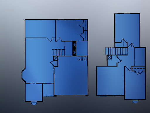

I made a floor plan in Photoshop @ 1024x768. I have not done enough reading yet on how to integrate it into a Mainlobby scene. Mario... is there anything out of the ordinary that I have to do? I will be using it to show lighting, fans, garage door, HVAC, and alarm zones.

Cinemar offers a floorplan conversion to a custom library that integrates directly into MainLobby as Library Items. You can do it yourself though using tools like Flash/Photoshop. Just create movieclips that are the shape of each room so you can click on the exact room. Send an email me directly if you need pricing.
There is also a thread here on the forum that I believe dives into it a little bit.
http://www.cinemaronlineforums.com/f...r=asc&&start=0
In our designs, we removed the doors from the actual floorplan and then used our door library object in its place. It shows red when the door is open.
Hope that helps.
