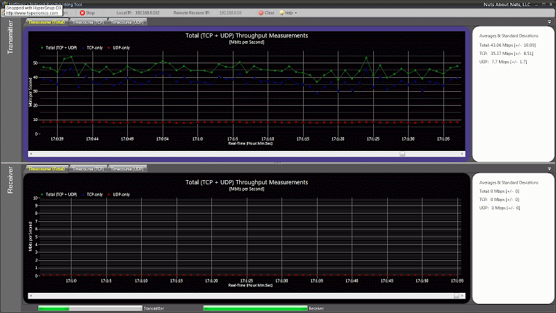

First I used the Netstress network throughput meter to measure the throughput of the old WAP and the RT-N53. The RT-N53 performed well. One of the big challenges with WIFI is being able to get consistent and repeatable results. its a real challenge and takes some thought. I shut off all other wifi devices except for my test pair. That means all cellphones, ipads, airport expresses were all turned off. Regardless it was still impossible to get any sort of consistent results with Netsress. The measurements I posted were the most typical and also the slowest. There were a number of times where I saw extended throughput of over 100Mbps on 5 Ghz. There were even a few times where I saw throughput as low as 40M on 5 Ghz but typically they were closer to 60Mbps. I didn't see nearly as much variation on the 2.5G band. All tests were done using WPA-Auto-Personal encryption and default settings for each band. 20Mhz channel on the 2.5Ghz band and 40Mhz channel on the 5Ghz band. NOTE: The router does support 40Mhz wide channels for up to 300 Mbps operation at 2.4Ghz. I decided to leave it 20Ghz mode for compatibility reasons. The Netstress benchmark was set for 300M network and 1 TCP Stream and 1 UDP Stream. All other settings were standard.
Living room test: 20 feet away line of sight to WAP
The first chart shows the performance of the old WAP using the Netstress at ~20Mbps with 1.5mbps variation.
Throughput over WIFI to existing Buffalo WAP from TV Desk using 2.4Ghz Band
Now we examine the performance of the RT-N53 in this application. It doubled the peformance of the old router at 2.4 Ghz and
even better at 5.0 Ghz
2.4 Ghz: ~ Average 44Mbps +/- 4Mbps
5.0 Ghz: ~ Average 52 Mbps +/- 4Mbps
Not only is the throughput excellent but its consistent with only 4mbps variation over a many minute test with no dropouts.

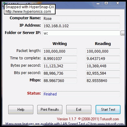

The next phase of the benchmarking was the file copy tests: I used Lan Speed Test (LST) to measure file copy throughput. The following tests used 1 Gigabyte test file size.
File Copy Performance using Lan Speed Test 1.X:
Code:
Band        Write to NAS:   Read from NAS:
2.5Ghz      56 Mbps           45 Mbps
5.0Ghz      65 Mpbs           46 Mbps
Ethernet*    89 Mbps           83 Mbps
*Ethernet is 100M and provided as a reference.
Asus RT-N53 to NAS from TV Desk 2.5 Ghz Band
Asus RT-N53 to NAS from TV Desk 5.0 Ghz Band
Ethernet to NAS from TV Desk

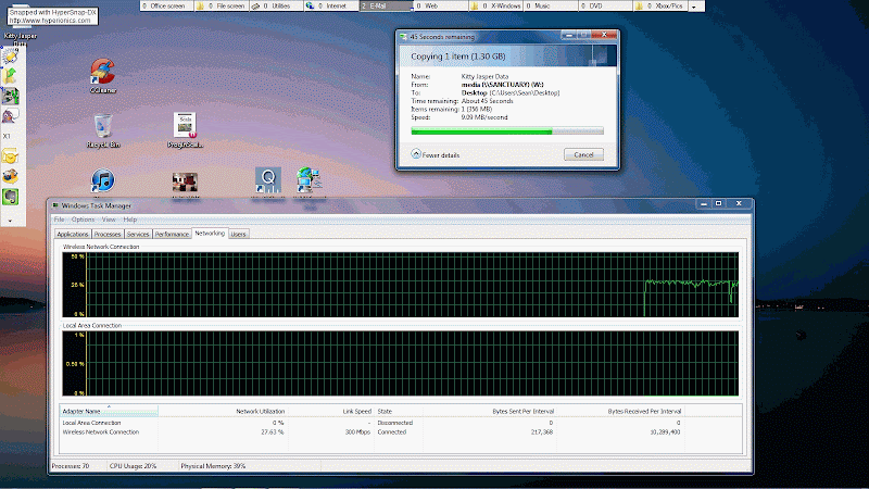

I also wanted to show that what you see in windows might actually be here: Note here you see the 9.1 megabytes/sec from windows explorer but once you add in the overhead of the various protocols your looking at more like 10.3 megabytes/sec on the wire/air.
File Copy using Windows on 5.0 Ghz at night
The next morning I run the same test and am getting ~5 megabytes/second. I added a second stream copy in the opposite direction and expected to see 1/2 the performance but the performance on the first stream barely went down. Wifi weirdness.
File Copy using Windows on 5.0 Ghz the next morning
