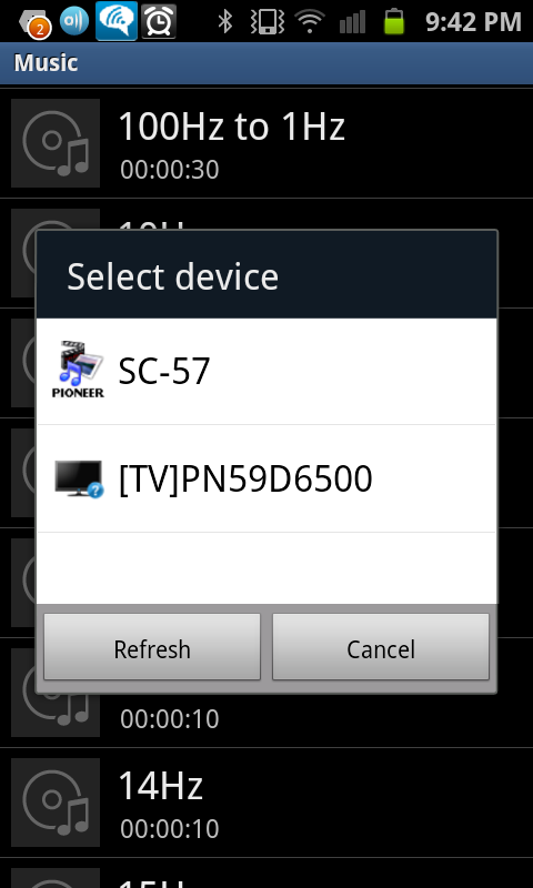

I purchased a Pioneer Elite SC-57 in Jan of 2012. For the first 8 months of ownership I was able to setup my network settings to see my upstairs Home Media Server. Everything worked perfectly... then one day it just stopped.
I've been about 8 months now without the ability to stream media from my phone or Home Media Server to my AVR, which is one of the primary reasons for purchasing the AVR in the first place. Oh yeah, my daughter has an Airplay enabled MAC and she can no longer use airplay either.
Here are a few detail in regards to my setup:
  • Pioneer Elite SC-57 (DLNA Compliant) - LAN Line hooked directly from Router to AVR
  • Verizon FIOS Internet Service
  • Gateway Desktop PC with Windows 7 - Wireless Connection from Router to Desktop
  • Windows Media Player 12 (I think?)
I've tried everything that I could think of over the past 8 months to get everything to play nice:
  • Called Pioneer Tech Support (worthless)
  • Called FIOS Tech Support (worthless)
  • Inquired about this issue on the dedicated SC-55/57 AVS thread (no help)
  • Went through network security settings and totally disabled firewall (nothing)
  • Setup and resetup WMP Homegroup (nothing)
  • Reset router multiple times (nothing)
  • Checked all cable connections to cancel out the obvious (nothing)
  • Went through the trouble shooting tips in the AVR manual (nothing)
  • Ensured sharing (public and local) are enabled in WMP
  • Ensured remote control of WMP was enabled
One of the trouble shooting tips was to make sure the DHCP was active on my router. When I plug the LAN line into my AVR, It assigns a IP address and shows a MAC address, but I still can't see the servers on my network like I could several months ago.
I believe I have isolated the issue to the AVR itself, because when I enable Allshare I can stream media to my upstairs PC and also have the ability to stream media from my PC to my phone. When my AVR was fully functional, I was able to stream media from my phone to the AVR through my Allshare app. I could also access my PC WMP through Allshare and stream music directly from my PC to my AVR.
I've learned a lot over the past few months about all things network, but I'm still not able to fix the issue. With that said, I'm at my whits end and will be calling in the Geek Squad to come check on the issue. Don't worry, It's a free one time service for "premiere silver" members.
When they come out and "IF" they can fix the issue I will report back here. I'm open to suggestions if anyone has any, but I really I just wanted start this thread so I can document a detailed solution that I can reference in the future.

I got distracted with playing with my new subs and I let my pride get in the way (thinking I could figure it out myself). I finally reached a point a few weeks back where I just threw my hands up and sent it off for service under warranty. I got it back from warranty on Friday and they said it was 100% fully functional with no issues.
Get this... I hooked it up to my home network last night.... Still getting the same results. This really really sucks. My wife gives me enough ***** as much time as I spend on doing stuff I enjoy with this hobby. Issues like this, when I have to spend hours upon hours upon hours trying to trouble shoot WTF is wrong with a piece of gear really detracts from my love of this hobby and makes me want to throw my AVR off of a building.
I'm starting to hate Pioneer, FIOS, Microsoft (Firewall, Windows, Etc...) and anyone else that has anything to do with my home network...

See, I'm able to control my AVR from the IControlAV2 app... I'm able to get internet radio... Just not able to stream music from my home PC to my AVR anymore... It's mind boggling to me.
BTW, if I didn't make it clear already. My AVR and my DVD player are the only two pieces of gear physically connected to my router. Everything else is wireless. Why is my Elite AVR the only DLNA certified product NOT showing up on my network? Why can I stream music from my PC to my phone and visa versa using AllShare? Even all of my TV's are shown on my network and allow me to stream music/video directly to them.
If Dropkick's step-by-step instructions above doesn't address my issue, I am going to schedule an appointment with the Geek Squad and physically take a leave of absence from work so I can hover over the tech to watch him figure out the problem.
Beyond frustrating. I hate to point fingers, as I'm sure when the issue is resolved it will point back to user error, but man... I'm going to have a hard time recommending Pioneer to anyone.

Thanks for your response Cebolla. I will try to take the time tonight to digest your input and give this a shot.
I can tell you right now, that I used to be able to control my home PC media server through my ALLSHARE application on my Samsung Galaxy S II andriod phone.
That's really the main capability I want back...being able to control the music from my phone to my AVR or even from my home PC through my AVR using my phone...
I can control music through my phone to my PC and other other devices on my network, but the Elite is no where to be found on the network. It's not showing up...
I've been able to ping my AVR using the CMD prompt and it indicates that packets are sent/received successfully, but I just simply can't find it on my network... WTH?

So it's your phone that's the Samsung device, I assumed it was the TV! No problem, at least you've got an Android device to play with and it should be no problem installing the BubbleUPnP app (free version for now) on it from the Play store.
If you run BubbleUPnP and go to Devices option you should see the SC-57 listed as one of the Renderers on your network (if its working under DLNA that is). The Libraries section lists all the DLNA servers available on the network, which should include the ones running on the PC (if they are working under DLNA), as well as the Local Media Server (which is the BubbleUPnP's own local server for media files stored on your phone). Hopefully the SC-57 is there and you are able to select it. If you also select one of the servers and then go to the Library option, you should now be able to select music tracks from the appropriate folder in order to add them to the playlist (the free version limits the playlist to 16 tracks). Go to the Playlist option to see all the files in the playlist and go to the Now Playing option to control the playback of the playlist's current track. If the AVR is connected properly via DLNA, it should now be able to be controlled by BubbleUPnP to play the tracks on the playlist from the selected server.
With the BubbleUPnP app still running on the phone, you should also be able to see its Local Media Server as a standard DLNA Server in the Home Media Gallery of the SC-57 and be able to select and play its file contents by using the Pioneer's remote / buttons on the box or the Pioneer iControlAV2 app (making sure to keep the BubbleUPnP app's DLNA server running in the background by switching out via the home button in order to run the IControlAV2 app on the same phone).
I assume by not being able to see the AVR, you are referring to when you are using the Samsung Allshare system, which hopefully is where the actual fault lies. It should be there if you use a fully compliant DLNA controller, like the BubbleUPnP app.
I'd expect you to be able to ping the Pioneer as that just proves it is physically connected to the network and can properly send/receive low level data packets. The fact that the Pioneer iControlAV2 app on your phone can see & control the AVR and the AVR can access its internet radio also tells me that and much more!
Nope... here is a screen shot of the iControlAV2 app... Not showing up.

Bam!
I'm going to make the time to translate all of this into a step by step process in the second post to ensure it helps out others.
Big shout put to Cebolla for all of the help.
I think the most frustrating thing about this entire ordeal is that I simply did not know what question to ask. I spent probably 40+ hours over the course of 8 months dealing with Pioneer tech support, FIOS tech support and performing my own independent research.
You know what, maybe I did know the right question to ask, but finding the answer was way harder than it should have been...
8+ months without streaming media and the fix literally took 90 seconds. Ridiculous!
