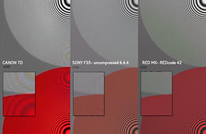

Here is a zone chart example of a Canon 7D DSLR video "lineskipping" CMOS, which in this case has to represent the "lower end" HD video cameras.
The F35 CCD 2K and a RED One-MX 4.5K which I believe here is windowed down to 2K.
Loook at the difference in resolving detail in the 100% crops. The 7D, even with 1920x1080 is just a "porridge mess". The F35 shows in finer details exactly the problems that end up as arifacts. The Red One is the only one that resolves clean.
(click on it)
To conclude; there is always possible to "mess up" in all part of the chain in 4K too, and it will be done.
The positive is that the new and best 4K cameras will shoot at higher than 4K resolution for better 4K results and people starts to learn proper digital 4K workflow.
Another fact to understand; A motive in front of a 2K camera and a 4K or higer resolution camera is the same.
The 2K camera can not resolve the details, they will merge together in blocks or a "soupe" just because 2K is not enough resolution to represent the details. And details are very important part of good image quality.
Example also is sharpness: 2K has to be electronic sharpened more than 4K to appear sharp and this produces artifacts and can look "oversharpened", while a 4K camera will have a more natural sharpness. (ref. image in last link)

Originally Posted by coolscan View Post
Of course 4K can be done badly, it's already done all the time.
Difference is that there is a whole lot of 4K worklflow education being done, specially by RED, because RED cameras will only output RAW and people mess that up all the time and gives the camera a bad reputation.
Another part is the recently understood need for capturing in higher resolution than the intended output.
Red as an example; as the first 4K motion CMOS camera maker they started with a 4K sensor, but found soon out they needed higher resolution to downsampled in post, so they offered a sensor upgrade.
The best 2K camera Arri Alexa has a 2880x1620 CMOS sensor downsamples 1.5x in camera and outputs 2K ProRes files. It is not very sharp and does not fully resolve fine details so it is prone to artifacts if you are not very careful in post.
RED cameras has been the only 4K cameras till now, but Sony has now shifted their technology from their previous 2K CCD and releasing a 20MP CMOS camera that outputs 4K preprocessed in camera.
Now you should start to understand the reasons for this.
What you do not appreciate enough is that RED & others have single CMOS sensor chips, essentially Bayer scheme. While the traditional high-end video cameras are 3 RGB chips. REDs are cheaper but do not forget they cut corners comparing to the 3RGB especially if we are talking about 4K perfection. So they have to go through the 4K claiming that it is better since one has 4K and downing to 2K is better. But in reality 3RGB 2K will be at least the same though the camera is more expensive. All this due to the fact that in the end the market is driven not by the highest PQ but by just-good-enough PQ @lower price.
(click on it)
F35 and Red pics would have to be carefully analyzed as to what kind of processing is applied. Notice there is aliasing in F35 only for vertical direction which asks what were the parameters of zone generator used. On the other hand Red is that clean and sharp that: 1. maybe it goes over 2K res and the pic is scaled, 2. some PQ enhancement is applied, nothing wrong with this but it may be showing up artefacts for other signal structures. I would say it is rather F35 which looks like undoctored full 2K res.
For sobering, those pics show well craziness of the 4K. Slight artefacts visible at the highest frequencies with 4:4:4 uncompressed pics of theoretical content are proof that 4K is better. This is quite far from reality.
I do appreciate CMOS sensors very much and so does all camera manufacturers except Sigma as they use Foveon CMOS sensors.
It seems to me that you desperately seeking "far and deep" for any argument to prevent to change both opinion an understanding. Or maybe you just want to be contrary for "the heck of it".
RED is cheaper with newer better technology because they do not take extortion prices for their cameras.
You just throw out some claims like that "RED cuts corners" without any facts to back that up whatsoever.
These two cameras was released about the same time. Cost about the same. Though the Alexa needs a external $30K recorder to record RAW.
Do you see the difference in technology advancements?
The Alexa is a camera that delivers good 2K images, no doubt, and nobody disagree that it is a little on the soft side unfortunately.
Here is a crop of th middle of the zone chart I posted in the other thread.
Alexa on the left, Epic-X on the right.
Some years ago Sony Motion Camera division would have agreed with you very much.
At the same time Sony was manufacturing CMOS sensors themselves both for their own DSLR's and for Nikon DSLR's.
Nothing new that the various Sony "fiefdoms" don't talk to each other.
Sony Motion Camera division has been "thrash talking" CMOS for years, with good help from Panavision's John Galt who was in charge of developing the Panavision Genesis based on the F35. He was also the one who allegedly talked Sony out of building the F35 with a 4K CCD sensor and has forever argued against 4K. You and John Galt would be very good friends, I'm sure.
What you seems to have missed in my post when you now start this strange argument for CCD cameras, a technology everybody has left, is that Sony Motion Camera division also have left CCD behind.
Their new F65 4K camera is all CMOS, so now Sony would not agree with you more.
Same with their latest Sony NEX-F100 s-35/APS-C CMOS prosumer video camera.
You are grabbing at straws here.
In a CCD camera the light is split by a prism befor the 3 sensors.
Sony has always claimed that their F35 was striped RGB.
Here is a close-up of another zone chart for F35 which shows that Sony's claim of "stripes" are far from the facts.
You think this is better than CMOS? You don't think this is prone to create artifacts?
