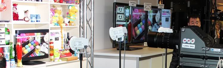

Did you read about this demo?
Another NHK Super Hi-Vision (SHV) demo involved shooting and displaying at 120 frames per second (fps) instead of 60. At far right above is the camera used. Just above the lens is a display showing 120-fps images and to its left one showing 60-fps. The difference in sharpness was dramatic. But to the right of the 120-fps images and to the left of the 60-fps were static portions of the image, and they looked sharper than either moving version. At the left in the picture above is the moving belt the SHV camera was shooting, and it looked sharper than even the 120-fps images.
http://www.schubincafe.com/tag/super-hi-vision/
You can click/save on the image above in the link. It opens up to a much larger image.
Yes, it says parts of the image where moving.
If there is no motion every frame is exactly the same, down to the pixel. Flashing the same image 120 times a second is no different to 12000 times per second or on continuously.
If we view a still image on refreshing monitor like a CRT does 120Hz look sharper than 60Hz?
LCD monitors are updating displays they don't refresh, the image is displayed constantly until pixel data is altered. They therefore don't flicker and if consecutive frames have the same data nothing changes on screen.
Yes, I know that HFR has no effect on static images. I was addressing movement, something that is a real world happening. Something that cameras have to capture, be it movies, sports, whatever. What I am saying is that MTF is not the only thing that affects what we see on the display when it comes to resolution.
