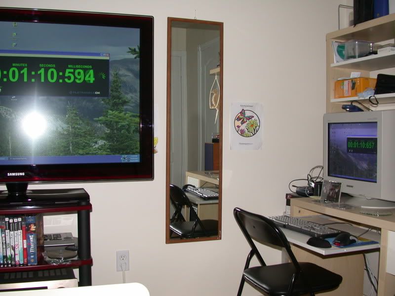

I had a Pioneer 5010, and have a Samsung A650 plasma, and I took lag measurements for both using "clone" mode on my PC. The reference monitor was a CRT.
The Pio (with or without game mode on) averages 64ms lag. The Samsung has 64 - 80ms lag. These measurements were all taken using the HDMI input of the sets at their native resolution.
Pio in top pic, Samsung in bottom.
tqn is offline

Apparently the FP site's stopwatch isn't very accurate
So give this a try
PS; Try increasing the shutter speed to 1/1000
PPS: If you really want to be accurate, try the method below
http://www.hardforum.com/showthread.php?t=1423433
That's a very interesting site. Thanks Nielo
joebloggs13 is offline
post #30 of 86 Old 08-09-2009, 09:21 PM
NOAMattD's Avatar
Join Date: Jan 2009
Posts: 373
I would just take a video at 60fps, then you can pause it and get as many "samples" as you like.
