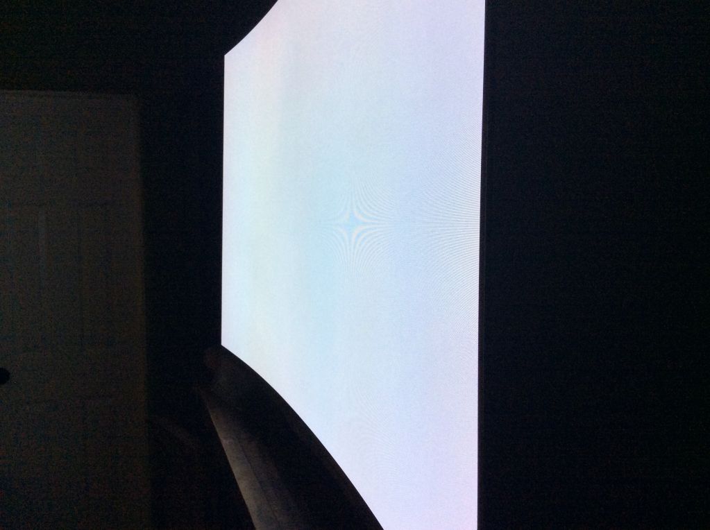

5X10, it may just be the pictures, but it looks like there's a bit of an issue with white uniformity. On my monitor I see some colored splotches not unlike what you typically see with an LCD/LED. Do you see this with your naked eye or is the camera accentuating it?
it looked more yellow to the naked eye, after thinking about it, it kind of looks like the outline of the back panel, on a white screen
I'll try to capture it on camera after this movie
Edit: since my kids were in the room, I paused the movie and switched to white slide
I asked my kids and they said yellow
It almost looks like a 4:3 screen, outside bars are white, inside part has yellow tint, which reminded me of the outline of the back panel

So you see no pinkish areas like I'm seeing in your pix?
no sir, its the camera
i was going to post a straight shot of a white screen, but my camera picks it up with a blue hue, that isnt there in person
camera is off an ipad

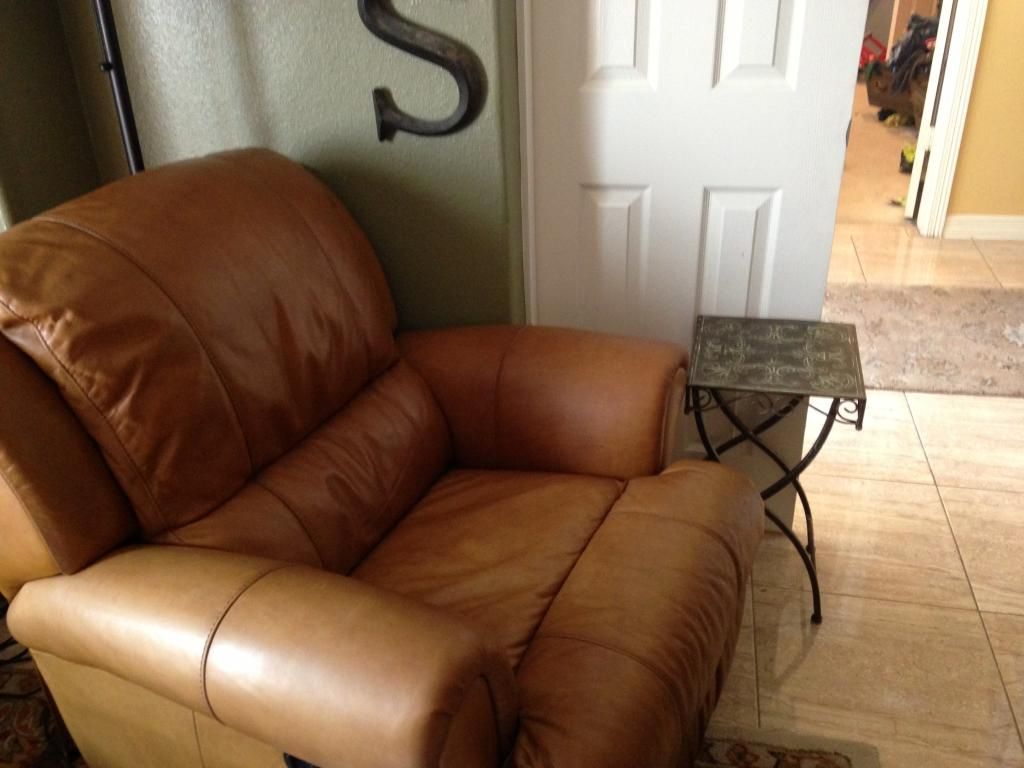

What is the color of your wall? I suspect at full brightness of white, it is strong enough to lite up the wall and cause reflection on the screen.
Could be the couches or the flooring, agree with you on the reflection
Would be interested to see what's in the other members(thats also reporting this)room

My wall is yellowish/egg shell color. Only at full white screen, I can barely see the very faint yellow tint in the middle of the screen. I'd categorize this as the curse of the curved screen
