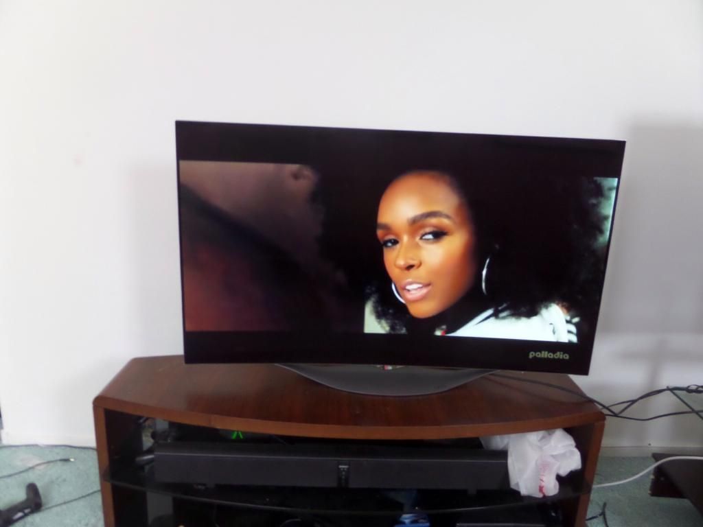

Vegas oled's Avatar
Join Date: May 2014
Posts: 1,921
Quoted: 1050 Post(s)
Liked: 749
Some random Photos
Morning5 and losservatore like this.
Vegas oled is offline

Originally Posted by Tyrindor View Post
Honestly, I just see black crush that has the effect of making the picture seem vibrant. It's hard to tell with a camera, so maybe i'm wrong, but I see literally no details in her hair. If you want a picture that "pops" than this set is likely great, if you want one that is accurate.. let's see if the pros can manage to dial this set in.
This photo stated prior to calibration. I do recommend you take a ISF course in calibrations. And yes this ignorant post has now put you on my ignore list.
