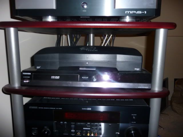

The Dish Network DTVPal DVR is a dual-tuner HDTV DVR that supports SD and HD channels from an off-air antenna. Satellite and cable (QAM) are not supported. The DTVPal DVR allows you to watch one HD channel while you record another; it will also record two different channels while you watch a third, previously recorded show. You can use pause (up to 1hr), instant replay, and rewind on live programming. Recording capacity is 30 HD hours and 150 SD hours with a 250GB hard drive. The bundled IR remote includes buttons for 30 sec skip, 10 second replay, and supports four speeds of fast forward and reverse, slow motion, and frame-by-frame advance.
The DTVPal DVR features an electronic program guide (EPG) with up to 8-days of program information when TVGuide On Screen (TVGOS) is available. TVGOS is distributed by many CBS affiliates across the country, but is not available in all markets. You can check here to determine whether TVGuide service is currently available in your area. If TVGuide service is not available, the DTVPal's EPG will display the more limited program information -- typically 8-24 hours worth -- offered by your local broadcasters via PSIP. If TVGuide service is available, but does not have information for a particular channel, then the PSIP information (i.e. 8-24 hours) from that broadcaster is shown instead.
All recording on the DTVPal DVR is performed with VCR-like timers, created manually or set through a program guide selection. When you select a show in the program guide, you are given the option to (1) create a reminder, or (2) schedule a recording in that time slot: once, daily, weekly, or M-F. You have the same options when selecting a show with keyword search. A list of all existing timers is shown on the DVR -> Daily Schedule screen, where you can cancel, edit, or add a new timer for a single or repeating (daily, weekly, M-F) recording in a specific time slot.
The DTVPal DVR lacks many features found on subscription-based TiVo, DirecTV, and Dish Network satellite DVRs. Features absent from the product include comprehensive program information on all channels, conflict management, dual channel buffers, external storage expansion, multi-room viewing, remote scheduling via web and mobile phone, picture-in-picture, picture-in-guide, guide filters / favorites, and the ability to transfer/offload recordings. Most notably, the DTVPal DVR relies on time-based recording rather than name-based recording; it does not know when a scheduled program has changed its day, time, or duration. The DTVPal DVR lacks the ability to record only new episodes and ignore repeats.
The DTVPal DVR has RF, composite (RCA), component, and HDMI video outputs; it has analog stereo and optical (TOSLINK) audio outputs. Output via component and HDMI is selectable 480p/720p/1080i through a menu. All outputs are active simultaneously and the box will downconvert HD channels to SD through composite and coax for older televisions. There is no Firewire output, and no way to directly download recordings from the DVR.
Despite initial reports to the contrary, external drive expansion is not supported. That said, you can replace the original drive with a 1TB version, increasing capacity from 30 HD hours to 142 HD hours. Software updates to address known issues will be made available for download over the Internet using the DTVPal's ethernet connection.
The DTVPal DVR has a 90-day warranty, while the same product rebranded as the Channel Master CM-7000PAL has a one-year warranty. Both will replace defective units with a refurbished unit if you are within that warranty period. Beyond the warranty period, one must pay full price for a replacement; there are no repair options available. If this is a concern, Sears offers a two-year extended warranty for $45 at the time of purchase.
Credit for this image to Crave .

All images were supplied by member RegGuheert.
Be sure to see the Pre-Purchase Questions section for pictures of the guide and recorded list.
Credit for this image to navychop.
Credit for this image to rustycruiser. More unboxing photos can be found in this post.

Unboxing photos
Powered on in a dark room
Setup photos
In-use photos (pics washed out by camera flash)
