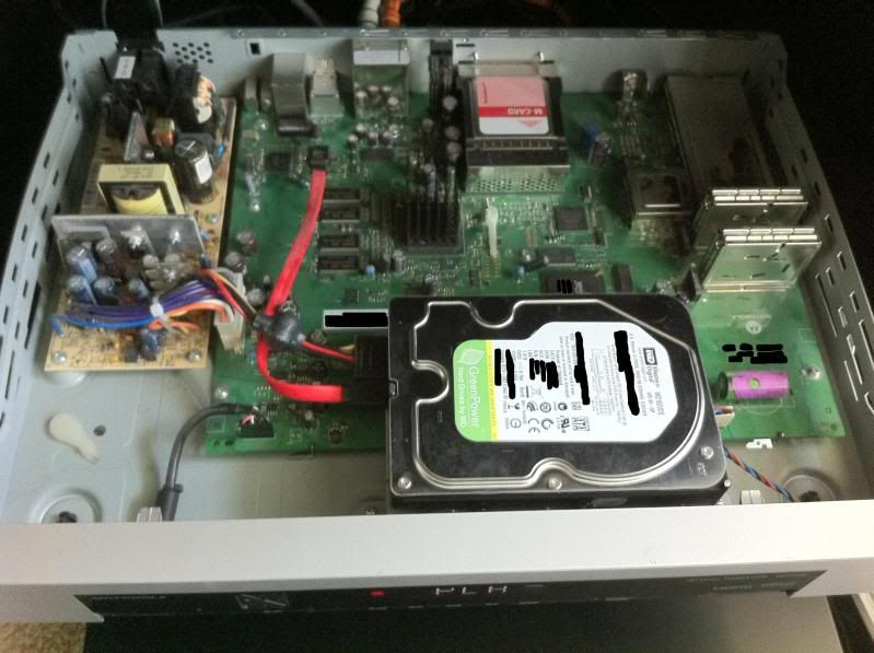

This is completely wrong. Video devices such as cable TV/Sat DVR's and the TViX do NOT have many similar parts to a personal computer. The chips designed for these devices are purpose-built for a very narrow set of tasks. They tend to be quite a bit slower than, say, the CPU of a personal computer, but all of the hardware and software/firmware involved has a very specific task: AV presentation. It is both because of the lower overall cost and because of the superior AV presentation that this type of hardware is used instead of commodity x86/x64 PC parts.
Here's what the inside of my cable box DVR looks like:
Other than the hard drive, there is little resemblance to anything in my PC...no intel or AMD CPU, no Nvidia or ATI or Intel graphics, etc. What is there was designed for a very very specific task. There was no need to include noisy legacy buses that even today's newest PC's still have.
To say that the internals are mostly the same as a HTPC, and thus should deliver the same result would be akin to saying that human DNA is mostly the same as chimp DNA, so their capabilities should be roughly the same (obviously the picture and audio qualities of a HTPC are not *that* different from dedicated DVR devices, but you get the point). I'd say that, other than the clear video noise differences (which are subtle, but obvious during A/B tests), my biggest complaint against HTPC's is lackluster deinterlacing. I find that dedicated video devices do a far better job of proper deinterlacing.
