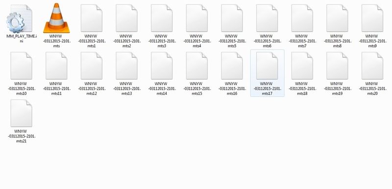

Another newbie question here. When I use this unit to timeshift or to watch a show while recording, there is a bar towards the bottom of the screen that shows at what time you are at in the show, and what time the unit is recording. The bar goes away when I fast forward to catch back up to real time TV. Trouble is the bar is opaque and blocks a portion of the screen (in Saturday's playoff game, a very important portion - the stats like the score, down, yards to go, etc!). Is there any way to get rid of the bar while watching the show in time shift mode?
