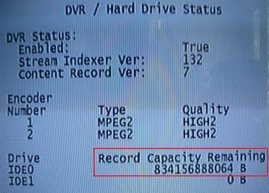

Boosh! Must just be a bunch of zeros at the end.
I doubt that the drive is ill...my bet is that it's just a different revision of that hard drive model that has a slightly different number of sectors.
Now I'm wondering how much smaller a drive could be and still work...
What if a 750 GB drive were used? Would the DVR still "think" that there was 1 TB of total space? What would happen when it hit that 750 GB physical limit?
***UPDATE*** I tried imaging a 750 GB Seagate hard drive with the 1 TB image and the cable box reformatted it to 160 GB. So it looks like your hard drive can only be just a tiny bit smaller than the WD10EARS used to create the 1 TB image.
TNO821 is offline

I'll summarize the successful drive upgrades mentioned so far in this thread and which model of drives were used:
DCTneo (WD10EARS x 2) - DCT6416PIII x 2, firmware 16.53, Access Cable Saskatchewan
TNO821 (WD10EARS, WD10EVDS) - DCH3416, firmware 18.77, Comcast in the SF Bay area
chs4000 (WD10EVDS) - firmware 18.76, Wave Broadband
sailorickm (WD10EARS) - DCT6412PIII
lambchops (WD10EARS)
Hoglard (WD15EARS with 1TB image applied) - DCT6412PIII, firmware 16.75, only able to record ~150GB software limited by Cox cable?
sandbagger (WD10EALX, required jumper pins 5/6 for SATA3 mode)
j1194 (WD10EARS from ebay, imaging incomplete w. error but works anyways)
riley847 (WD10EARS) - DCT6416PIII
markj801
DCTneo's brother (WD15EARS with 1TB image applied) - DCT3416
Sitargo (WD10EVDS) - DCT3416, firmware 16.74, Cablevision (Mexico City)
dan74 (W10EVDS) - DCT3412, firmware 16.79, Flow Jamaica (Columbus Networks USA)
jimichunga working DCT3412
Flacido (WD10EADS-98M2B2, WD10EADX-00T)
terraphantm (WD10EALX, required jumper pins 5/6 for SATA3 mode) - DCH3416, firmware 18.46
Alexander63 (WD10EARS) - DCH3416
StevenHB (WD10EARS) - DCT3412 (Comcast)
deeplake21 (1TB Seagate Barracuda 7200.12)
Any additions or updates, let me know and I'll keep this post updated so long as I reasonably can....
DCTneo is offline

Originally Posted by Hoglard View Post
Another success story: DCT6412III was upgraded with WD15EARS yesterday.
The only thing which I was not prepared for was what felt like more than an hour before the new system fully booted. For most of that time it was doing something at the boot-up screen where progress bar was showing 8 of 12 segments. I guess it was probably checking the disk (1.5TB formatted as 1TB).
Guys, I have a problem.
Everything looked OK when I imaged the disk last week:
Code:
Welcome - Parted Magic (Linux 2.6.38.2-pmagic)
root@PartedMagic:~# bzip2 -d -c -f /media/sdb1/MotoSTB_1TB.bz2 | dc3dd of=/dev/sda progress=on progresscount=500
warning: sector size not probed, assuming 512
dc3dd 6.12.3 started at 2011-05-24 21:10:08 +0000
command line: dc3dd of=/dev/sda progress=on progresscount=500
compiled options: DEFAULT_BLOCKSIZE=32768
sector size: 512 (assumed)
1953525168+0 sectors in
1953525168+0 sectors out
1000204886016 bytes (932 G) copied (??%), 9109.61 s, 105 M/s
dc3dd completed at 2011-05-24 23:41:57 +0000
root@PartedMagic:~#
But now I realized my DVR does not want to record any more shows. It looks like it thinks it does not have any more disk space, even though the diagnostic screen shows about 834 GB free:
So far it recorded about 147GB so it might be hitting the 160GB hard drive limit in the firmware:
Any thoughts? Did I do anything wrong? Or do we have an issue with the size(1.5TB) of WD15EARS?
Hoglard is offline
But now I realized my DVR does not want to record any more shows. It looks like it thinks it does not have any more disk space, even though the diagnostic screen shows about 834 GB free...
I was initially surprised (and pleased) that the WD15EARS worked OK, however I heard that the maximum recognizable drive size was rumored to be 1TB. So you may be better off moving to either WD10EARS or WD10EVDS as those all seem to be working properly. It may be a very limited number of 1TB WD drive models that will work properly in the Motorola PVRs, as my brother tried to format a 1TB Seagate without success (I formatted my WD10EARS drives using his PVR). He got an error message saying that the drive was not compatible or something like that.
PS, Hoglard, what cable provider are you with, and what's the firmware version on your box?

It's probably the fault of the firmware version that your cable company uses. I've read about people who get one of the 500 GB Motorola DCX cable boxes and it only records up to 160 GB. The solution was that the cable company had to update the firmware version in order for the cable box to use the remaining drive space.
