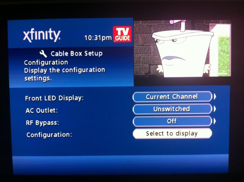

My cable box is a DCH3416
Firmware: 18.77
S/W Ver: 78.53 - A28p0-4.1005.r-8
I'm on Comcast in the SF Bay area
I've tested the image on 2 different WD10EARS and a WD10EVDS.
I tried unsuccessfully to put the image on a Seagate 750 GB hard drive (I expected it to fail, but was curious). The cable box reformatted it to 160 GB.
TNO821 is offline

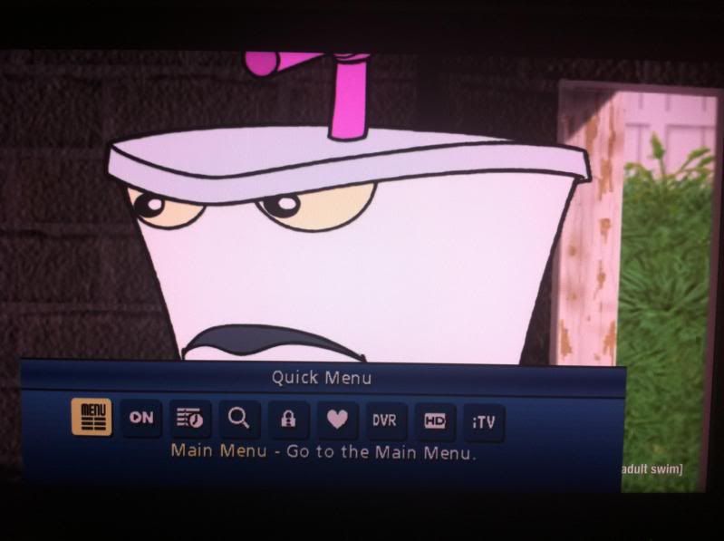

Originally Posted by Hoglard View Post
My cable provider is Cox. I will check firmware version when I get home - I assume it is somewhere on the diagnostic screens, right?
It's easiest to check by leaving the cable box powered on, press Menu, and then select Menu from the on-screen display. Then choose Setup > Cable Box Setup > Select to display
You will see firmware version, software version, and a bunch of other information.

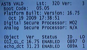

But I found this on one of the diagnostic screens:
Hoglard is offline

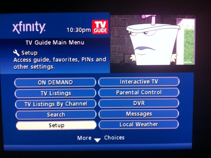

The power is on, I press Menu button, and I don't see that. I have DCT6412III.
Huh...maybe the DCT6412PIII has a different menu. Or maybe your firmware/software is a bit older. I seem to recall that the menu was the same when I traded my DCT6412PIII for my DCH3416.
Does your DCT6412 has HDMI? I've read that any Motorola cable box that has DVI instead of HDMI can not perform the 1 TB upgrade.
Anyways, here's what it looks like when you hit the Menu button on the DCH3416 (if anybody with a 6412 or 6416 sees the same thing, please chime in):
TNO821 is offline

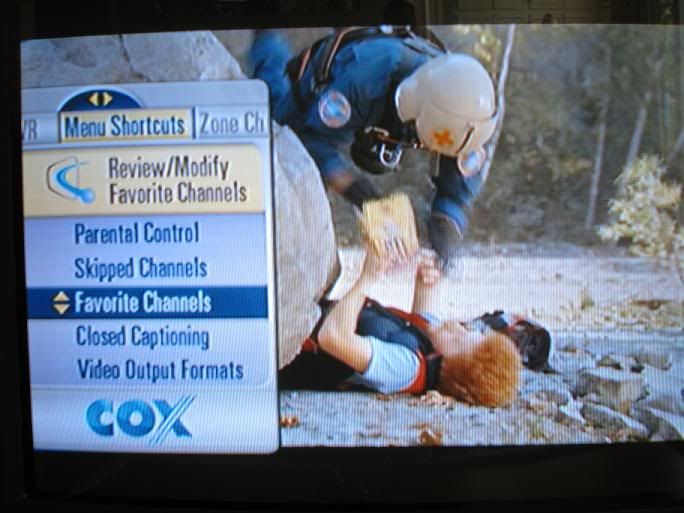

My DCT6412III has HDMI (no DVI).
Here is a link to reference info on Motorola cable boxes: http://www.motorola.com/Video-Soluti...ital-Set-Tops/
This spec sheet here gives impression that the only difference between DCT6416III and DCT6412III is the 120GB versus 160GB harddisk (look at the second page).
When I press Menu button (on either the remote or the set top box itself) I get this:
....so I assume the difference in GUI appearance must be due to varying firmware versions (likely affected by cable provider customizations, as seen on the picture above).
Hoglard is offline
Wow! Your menu looks nothing like mine. I didn't realize there could be so much variance among providers. Good to know.
TNO821 is offline
