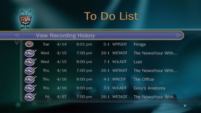

Well guys, I'm soon to be part of the TiVo community. I've given up hope of the DTVPal DVR ever being fixed in a reasonable amount of time. I have a new 50" 1080p Panasonic plasma and I want to record in HD now, not 1-8 months from now waiting for Dish to get their act together. So, I pulled the trigger the other night and ordered a TiVo HD. All things considered it was absolutely the right decision for me. The TiVo does a lot of things I really want and I don't have a problem with the subscription.
I've read bfdtv's excellent reference post carefully -- which was really 90% responsible for pushing me the rest of the way into the TiVo fold -- and I've read the last 4 months of posts in this thread. Naturally, I can't find the answer to my question.
ABC likes to run their most popular shows a minute or two past the hour to try and trap you into watching their next show. Heros & DHW especially come to mind. So, when I schedule the TiVo to record a show like this, is the guide smart enough to know it will run past the hour? Will it automatically record past the hour to catch the over-run, or do I need to explicitly pad the end of the recording a couple minutes.
Conversely, NBC starts Saturday Night Live at 11:29pm. Does the TiVo know this or do I have to pad the beginning of the recording.
TIA
- kelson h
The bitterness of poor quality lasts long after the sweetness of the low price is forgotten . . . life is too short to drink bad wine

You can adjust start and ending times by a couple of minutes for each programmed choice in the TIVO menu.
Thanks. I knew that already from the reference post -- very useful for sporting events where the ending time is always uncertain. But for standard programming where the episode length is known, is the TiVo guide data "smart enough" to know a show will run past the hour and adjust it's recording time automatically.
You users who record Heros or Lost or DHW. What do you do? Do you have to explicitly pad the end by a couple minutes or does the guide take care of it for you.
Yes - if the show is 61 minutes long Tivo will record it as such. For some shows (Scrubs) I add 1 minute since it seems to miss the 'very end/last scene'. Some shows (The Shield i believe) recorded sixty-odd minutes to reflect the length of time. Mind you all bets are off when a live event is going on - i had to manually adjust The Amazing Race many times due to football going longer than scheduled.

The TiVo has a feature called "overlap protection" to address situations where three or more programs overlap by five minutes or less. When enabled (the default), this feature will automatically cut up to five minutes from the lowest priority recording if and only if doing so will allow another scheduled series to record.
For example, suppose you had series recordings prioritized as follows in Season Pass Manager:
  1. 24 (normally Monday @ 9-10pm on FOX)
  2. Heroes (normally Monday @ 9-10pm on NBC)
  3. CSI Miami (normally Monday @ 10-11pm on CBS)
  4. True Beauty (normally Monday @ 10-11pm on ABC)
If this week's episode of Heroes ran from 9:00 to 10:02, then True Beauty would be cropped by two minutes because it is the lowest priority series.
If your spouse were to re-prioritize the series as below, that would produce a different result.
  1. True Beauty (normally Monday @ 10-11pm on ABC)
  2. CSI Miami (normally Monday @ 10-11pm on CBS)
  3. 24 (normally Monday @ 9-10pm on FOX)
  4. Heroes (normally Monday @ 9-10pm on NBC)
With this setup, True Beauty and CSI Miami would start on time and the last two minutes of Heroes (10:00-10:02) would be cropped.
Programs that will be cropped have their time flagged with a * on the To Do List.
Originally Posted by jjeff View Post
Are you warned of this conflict so you can correct it before the event? TVGOS gives a little ! if there is a problem, I would think Tivo might do something similar?
Any time you select to record a new series that conflicts with two others by more than five minutes, the TiVo displays a conflict screen showing the applicable changes in the record schedule, including the programs that will and won't record. You are given the option to cancel the new recording or proceed with it as shown.
TiVo does not visibly indicate when a program won't record, although you can see everything that will record on the To Do List (record schedule). On the TiVo, a series episode is not "canceled" because it conflicts with two other higher-priority programs; the TiVo will just continue to search for a reairing of that episode (which may or may not come). Cable channels typically re-air their programs the same night or later in the week, so conflicts with those channels are rarely a problem.
You can click on a program, select "Upcoming showings," and you will see a list of all upcoming showings in the next two weeks. There will be a checkmark next to the showing that will actually record.
