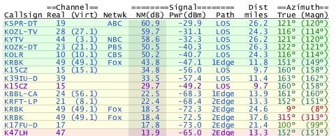

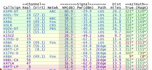

That's what I'm thinking is wrong. I'm trying to figure out a way to delete all channels for good and rescan but I'm not figuring it out yet. When I rescan it asks if I want to delete all channels before I rescan. I say yes, it scans and finds no 49.1. But then when I go to my guide 49.1 is still there but gets no signal.
On Tvfool.com all my other channels that come in fine say LOS but 49.1 says 1Edge. I'm guessing that has something to do with it, something is blocking the signal?
Although if I put my antenna height at 20 ft (which I'm guessing is around what the roof antenna is) it changes to LOS and it's only 11.8 miles away yet 0 signal?

I estimate you are receiving 0.6 kW in your direction from the Springfield transmitter. I suspect TVFool is assuming you are seeing a full 170 kW.
The one at 37.6 miles (near Bolivar) is giving you more like 20 kW. I would wonder if you would have more success trying to get that one by turning your antenna around, though that would probably kill your reception of the other stations.
I don't know that any of the signal prediction sites properly handle DTS facilities filed the way that KRBK was. It was 100% correct in how it was filed, mind you, but it's just different. RabbitEars kind of handles it, but not well, and only because I did a manual override on the FCC database. I'd like to set up RabbitEars to handle it but, honestly, I don't even know where to start.

Your'e awesome. I was messing around with my homemade antenna today and flipped it around towards Bolivar and sure enough my TV picked it up.
I have 4 tuners in my HTPC so I hooked the antenna up to the strongest internal tuner in my computer and 4 out of five bars on channel 49. So I found out you can designate certain tuners to every channel in Media Center so on channel 49 I have it to where it only uses that one tuner that has the antenna turned to Bolivar for it. Perfect, now I just have to build another antenna and I'll be all set. Thanks!

post #5279 of 5579 Old 04-19-2012, 07:49 AM
phlatwound's Avatar
Join Date: Aug 2008
Location: Larry County, MO
Posts: 44
Originally Posted by tch View Post
...Everything was fine until they finished their install and started "tweaking" things to "improve" them. Well, they "improved" me right out of a signal. I can't get KRBK at all anymore...
Same here for me. Before the "tweak and improve" was finished I was getting KRBK at about 80 on a scale of 100, after it was running in the mid-to-upper 60s, with frequent pixelation and dropouts.
After about a week of that I climbed my tower and turned my CM 4228 further north, and it improved things greatly I am west of Springfield about 20 miles and am now aiming between Fordland and Spfd.
Also, the day before I moved my antenna I had filled out the form on KRBK's website to report signal problems, they called me the very next day but by then I had fixed my problem.
