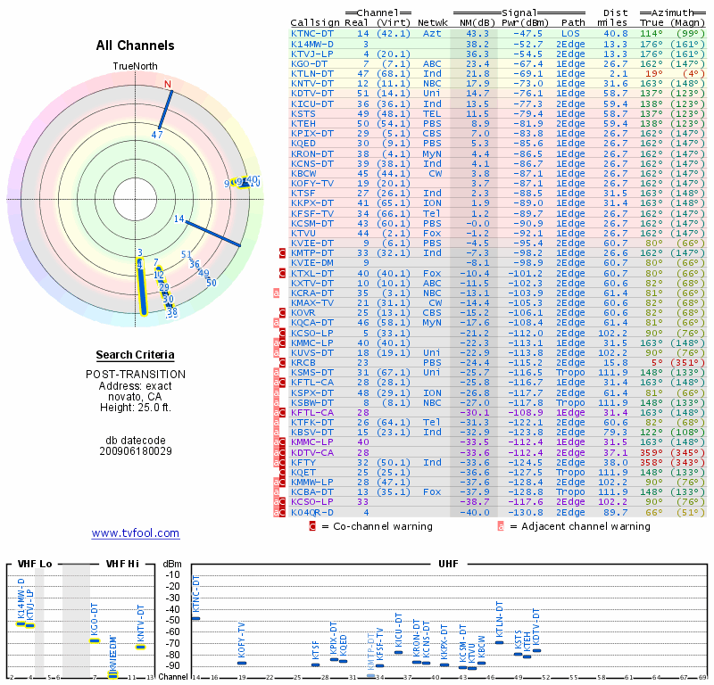

Originally Posted by rackerby View Post
I plugged this address into antennaweb.org:
224 SAN FELIPE WAY
NOVATO, CA 94945
It says that location *might* get 11.1 and 7.1. Is that really it? Is anyone getting reception in that neck of the woods?
TVFool.com is a better tool to use and it shows good strength on both channels. Here are the results for that address - direct link and image.
wm_tell1 is offline

Originally Posted by DEEPFRINGEGUY View Post
I used to live not far from there. He should get all the Sutro stations with rabitt ears in Novato;
Not in this particular location.
Should get very good reception with a small-medium size external antenna.
Well, just for the heck of it, I asked the Solid Signal folks about this location. They recommended the Antennas Direct C2 ClearStream2. Does that sound reasonable? It's certainly a lot smaller/prettier than the CM4228 I was thinking of putting on the roof.
I'd be very surprised if you didn't get that one on Mt. Burdell with rabbit ears also; since you're right next to it
Yes. That one (KTLN) does come in with rabbit ears/UHF loop. Too bad my parents aren't interested in that channel.
rackerby is offline
Well, ground clutter has a lot to do with it. Remember, TVfool doesn't know about ground clutter and buildings, etc. By the way, when I key in my address at TVfool the results I get are so inaccurate it's not even funny.
I'd go with the 4228HD if I were you. You probably don't need a pre-amp either. I'd start without it and see what you get.
DEEPFRINGEGUY is offline
