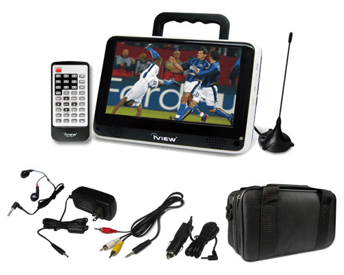

Can anyone pick up WBRZ, WVLA, and WAFB with a portable TV?? I recently got a portable TV and it (like all the others) can't pick up JACK even with its external antenna. It only picks up PBS/LPB and WGMB. Are WBRZ, WVLA, and WAFB so low powered that they require a huge antenna?

Sounds like the TV antenna is UHF only. WBRZ is a pretty decent power for it's channel number. 30kw. WAFB is only 5kw, low power for VHF world. WVLA and WGMB are both UHF 1000kw full power rigs. But as noted around here WVLA is a lower signal than WGMB for some reason. I'm northeast of Baton Rouge and WGMB, WLPB, and WBRZ are 100% on my receiver. WAFB and WVLA hit around the 70's - 80's. Funny thing is, I get KATC out of Lafayette stronger than I do WAFB.

Thanks for the info. Strange.....no the antenna looks VHF to me, it's just a straight rod:
I'm in zip 70815 around Flannery Rd. & Fla. Blvd. area. I'm able to hook up cable and other antenna to it, but I'm not sure what kind of antenna I should get. It needs to still be rather small to be somewhat "portable".

It is possibly too short of an antenna to have any VHF gain. I know I can pick up WBRZ pretty easy with a simple set of rabbit ears, but of course when you extend them out they are much longer than that antenna. Go check out Wal-Mart and RadioShack, I doubt you'll want an amplified antenna since that would not be portable, look for an antenna that has the typical rabbit ears and UHF loop to them.
Something like this: http://www.solidsignal.com/pview.asp...u=079000307624
You'll notice how it says 2-13 and 14-69 reception.
