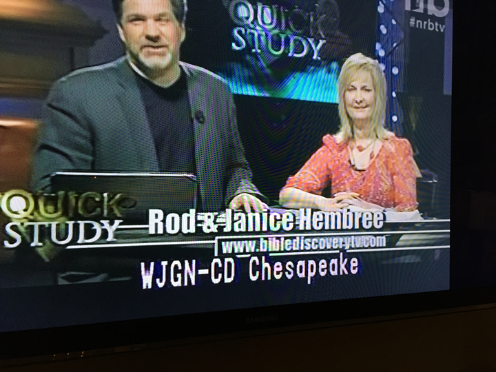

WJGN-CD 38 is now on the air, evidently without PSIP. Anyone seeing it?
- Trip
N4MJC
Comments are my own and not that of the FCC (my employer) or anyone else.
RabbitEars
"Ignorance and prejudice and fear walk hand in hand..." - Rush "Witch Hunt"
Trip in VA is offline
post #6687 of 6731 Old 04-23-2015, 06:57 AM
VARTV's Avatar
Join Date: May 2002
Location: VA Beach, VA 23456
Posts: 4,972
Quoted: 44 Post(s)
- Trip
Yep! I thought they were an affiliate of FamilyNet, not NRB Network. Eventually they might run multiple streams...
