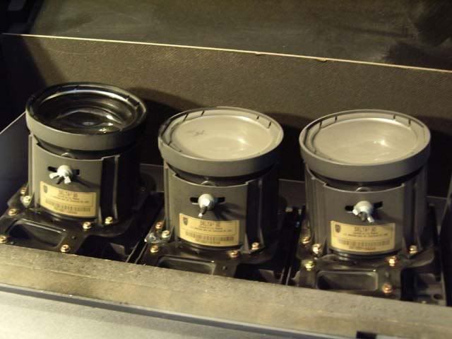

Just got home tonite from the weeklong Baltimore tour. Which included cleaning and calibration of 2 Elite 710s and 1 Hitachi, plus repair work on a 73" Mit with the owner's firm and deliberate hope that it can be saved and completely restored with calibration and shimming for the overscan IF the repair can be completed, all CRT RPTV format just like this one mentioned here. More than $300 has been spent so far on the Mit repair, a very hard to find module is currently off being rebuilt in this quest. There were 4 big screens to work on and only 7 days to do them in, so tonite is the first time I have had a chance to breathe a bit and contemplate which pix to send up.
These are the Before shots of Steve Mock's Pioneer Elite 710. I will get others up here soon, including the shimming op and Afters. They show why so many have given up hope on these sets so far. The Afters will show why there are so many people who are joining in with Pam's feelings on the matter.
The most noticeable deficiencies in his display were the optics needing cleaning, the pic was dim and overscanned, and of course the horrendous grayscale. He was nearing the edge on putting up with that pesky overscan, and the shimming op finally gave him the relief he's been looking for.
The purple pix were taken the first night, which was when the grayscale had to be done because of little light isolation in the daytime. The optics cleaning had to be done before the grayscale could be done.
The structure shots were taken the next day, after the grayscale had already been dealt with and restored. You can do the structure with little light iso, but not the grayscale.
Optics dirty

Pic after cleaning and grayscale but before restoring of the original light levels, along with other user settings needing to be way off center to deliver decent fleshtones, but before the rest of the work, where those got recentered
[/url]
huge overscan - observe the upper left corner, where the graphics are cut off at the knees. That's just the top, the bottom was the same -
[/url]
OOB overscan and uncentered positioning
[/url]
still grossly overscanned OOB, but at least re-centered before taking it in via the shimming op
[/url]
Dim pic at Black Level zero, requiring increasing it way out of spec
[/url]
[/url]
More soon -

4 layers of half-inch thick wood, for exactly 2" thickness
You can see 2 blocks on this shot, because the entire array tray is raised so much
Steve's rather unique way of doing the bolts. As Kirk said in Wrath of Khan, about his solution to the unwinnable Kobiashi Maru (?) test at the Academy, "It had the unique virtue of never having been tried..." Observe the MULTIPLE washers at the head of the bolt, since we could not get the bolt to penetrate the set's metal tray beyond just a little bite, even with the hole already there for a smaller bolt thickness that we simply could not lay our hands on in an elongated length. Worked like a charm...
Both front and rear wood blocks on the right side are showing in both of these pix above -
The results
Before
After
Had to push the image up a bit from center because of a pesky red and blue dot that were visible in the blacks at fully centered vertically.
Top could have been a bit straighter and more parallel to the frame, but the shimming op had taken so long by then I was kind of in a rush and missed it. That wood wall that had to be removed was incredibly hard to get out when thru the front was the only way. He really didn't want to have to take the set out to get to the back of it, and with his considerations on what was back there to have to deal with, I didn't blame him...
Redoing the o'scan this way takes a lot of pressure off the coarse and fine geo/conv circuit, which can happen when reducing it via sm only

This was just posted on another thread, thought I'd share it with you here -
Originally Posted by najames View Post
Holy Cow Dave Harper!!! You said ISF is in Florida, so I decided to see where they're located. They're about 5-10 minutes from my house!! Didn't even know it, too darned funny.
I have an elderly Pioneer SD-532HD5 like this one.
http://www4.shopping.com/xFS?KW=pion...Video&FD=85747
I might just need to have this thing calibrated some day. It works OK and has been moved across the country twice, in storage for a couple years, never been touched except when I used the Avia disk set it up initially and when I moved here in Boca Raton 3 years ago.
Just noticed this post in another thread, from way back in '05.
Just so you know, those "elderly" CRT RPTVs are not old, they have a 20 year service life - or more, I've seen it, recently heard about a 29 year old Panny CRT 50" that's still cranking away just fine - and at today's stage are only halfway thru it. I know of an "old" curved screen bounce-off-the-screen Sears CRT whose guns fire at the hinged mirror that you pull out and let fall into place to start it up, that's still cranking away just fine too. We've been looking for someone to take it home and keep it going, or hopefully get it to some sort of video museum, tho I have never actually heard of one...
Well treated by their owners re. usage, light levels and avoidance of screenburn, they are capable of WAY better than new performance, even at 11 years old.
I am being flown all over the country cleaning and calibrating these "elderly" beasts, which are capable of incredible HD, head and shoulders better than a lot of the "affordable" fixed pixel offerings out there in today's marketplace. And better looking in some ways than all fixed pixel offerings.
The main thing that not everybody knows about them is that their optics need to be cleaned yearly, and on some brands - like the Pioneers, be they Elite or non-Elite - the "deeper optics" need it every few years as well. That's because of the air gap between the lens barrels and the CRT coolant covers, where 6 additional surfaces get invaded by dust, soot, smoke and all manner of other airborn contaminants, and thus compromised because of the high voltage turning them into powerful, continuous dust magnets every moment they are powered on. There's 28 optical surfaces in there that need to stay crystal clear, 10 of which get heavily compromised because of the HV. When all 28 surfaces are clean and polished and you have a crystal clear light path again, the results are truly astonishing. Like getting a brand new TV for a simple hour's work.
Just doing this one thing gives your "elderly" set a brand new looking picture - in my area my calibrations are called "The Sparkle Process" - and calibration after that is just incredible icing on the cake.
I started the "Don't Dump Your CRT RPTV!" thread here on AVS more than 5 years ago, and it is still going strong, with over 300 complete pages so far and over 9000 posts. If you have a CRT RPTV at all, HD or non-HD, I invite you to go over there and check it out.
http://www.avsforum.com/avs-vb/showt...95922&page=327
If you have a CRT RPTV or know someone who does and want info about how to do your optics cleaning with no damage - those soft plastic surfaces in there are incredibly delicate, vulnerable and easily scratched, and any damage to them is permanent - contact me directly, by email or phone. No pm's please!
Thx -
Mr Bob
